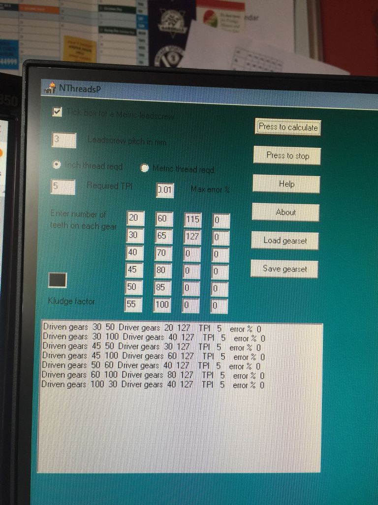

                        I wasn't sure if I could actually cut a 5tpi thread on my Leinen lathe at home with its 3mm pitch lead screw. I discovered, on the lathes.co.uk web site, a calculator that did the job for me. You input your lead screw, the thread you want to achieve, your whole collection of change gears, the pitch error you are prepared to accept, press the button and bingo there you are.smileyyes

                          I have produced several ACME threads with the help of this useful calculator which is saved in my favourites. When I did the T S nuts and leadscrew, I had to double the lathe leadscrew speed and set 10 tpi, the Smart & Brown model A only goes to 8 tpi normally. While the lathe leadscrew was overdriven, I was worried about the safety link in the mechanism shearing, so I temporarily disabled it.

                            When cutting a thread courser than the leadscrew it may be better to turn the leadscrew by hand and have that turn the chuck to reduce the strain.
