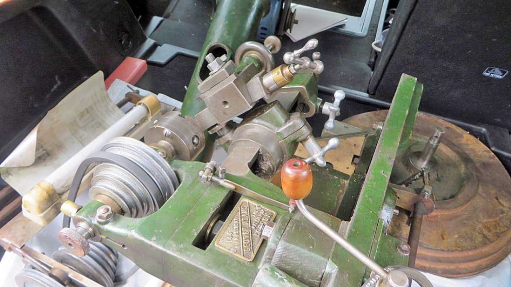

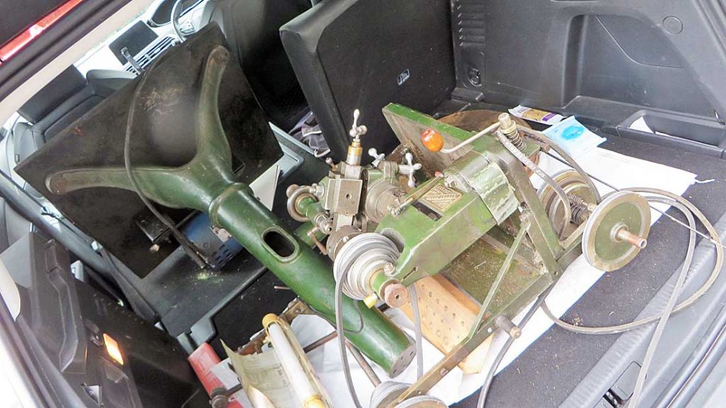

        Hi All,
        For some reason to day we were about 15minutes earlier than usual at our Sunday car boot, barely anyone there and the house clearance guys were just setting up.
        Just as I approached one van, the driver and his mate were struggling to get this out of the back:
        Could not believe my eyes so bought it immediately for a bit off his asking price as he did not want to have to lift it back if not sold! Has its treadle, flywheel and a bunch of tooling with another box he did not put on the van this week so have to go to Yeovil to collect.
        I cannot wait to get some help to get it out of my car and have a good look at it.
        Funny thing was there was nothing else of much interest anywhere so we would have been very disappointed after a 90 minute drive to spend so little if this had not come up.
        Cheers, Martin

          Wow! Well Done!
          It looks as if well used and cared for, and until very recently; so it's good it's found a similar new home.

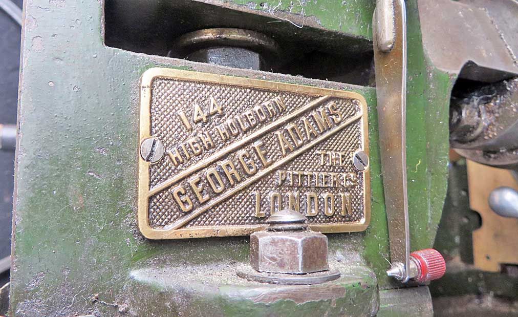

          There is quite a bit about the make, filed under " Adams George " , on Lathes.co. I couldn't see one that matched, but I may simply have missed a section. If that is "Emerald Green " it is the original colour, too. Quite a range of accessories were available, so maybe in that box still in Yeovil…

              I think you'll get more joy searching for Pittler lathes, looks like a re-badge job to me.

                    The Pittler lathe on that page is the exact one the OP has just bought. Got the same marks and scratches.

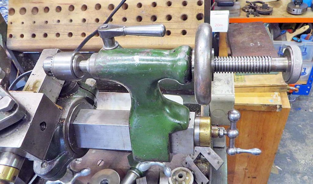

                      Hi Pete, you are dead right, just been out and took a pic of the tailstock complete with blob of white paint! What are the odds on that?
                      I can’t wait to get it out of the car and set up. I have the flywheel, treadle and a unit with two wooden drawers that slides under the main part, all pretty heavy and awkward to lift.
                      Not sure yet what to do with it as we just do not have the room for another ‘toy project’ as The War Office calls them!
                      Currently need what free space we have to build the 75 x 2000 linisher I got plans of and now being water jetted.
                      will update when I have it out and assembled.
                      cheers, Martin

                        An interesting find, a pattern B lathe on a tri leg stand, these also came on a trumpet stand.
                        I can see it's a type without back gear which on Pittler B lathes is inside part of the pulley casing. I'm not sure if that type came with a dividing head but it was originally issued with 17 gears & 3 worms plus other accessories. I have Pittler catalogues showing all the information on these and other literature.
                        I have a Pittler B2 with overhead drive etc with lots of rare accessories, I made a very detailed Google website showing all the various parts etc

                              An Adams-badged Pittler? Good suggestion. I looked only at Adams entry in Thje Scriptures, but did notice it says Adams were involved in a lot of badge-engineering.

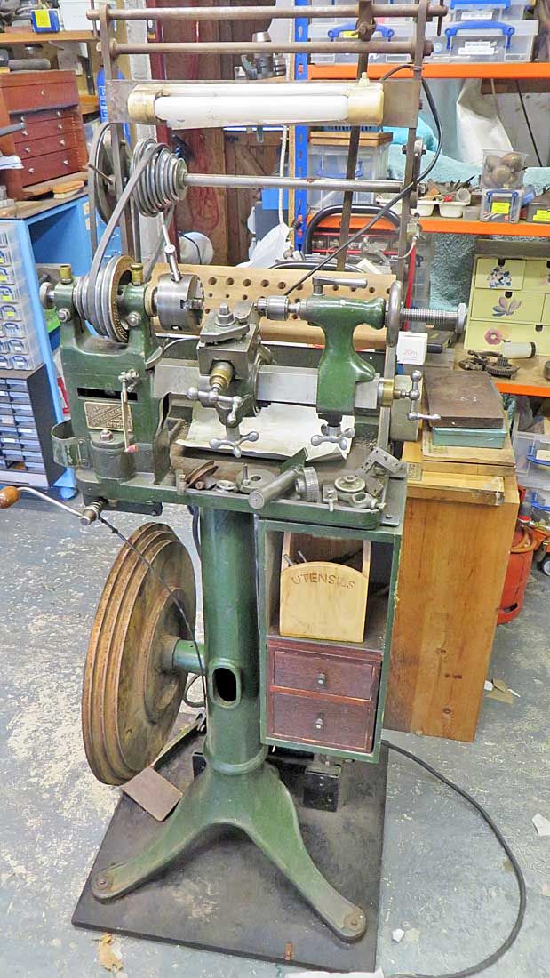

                                              Hi All,

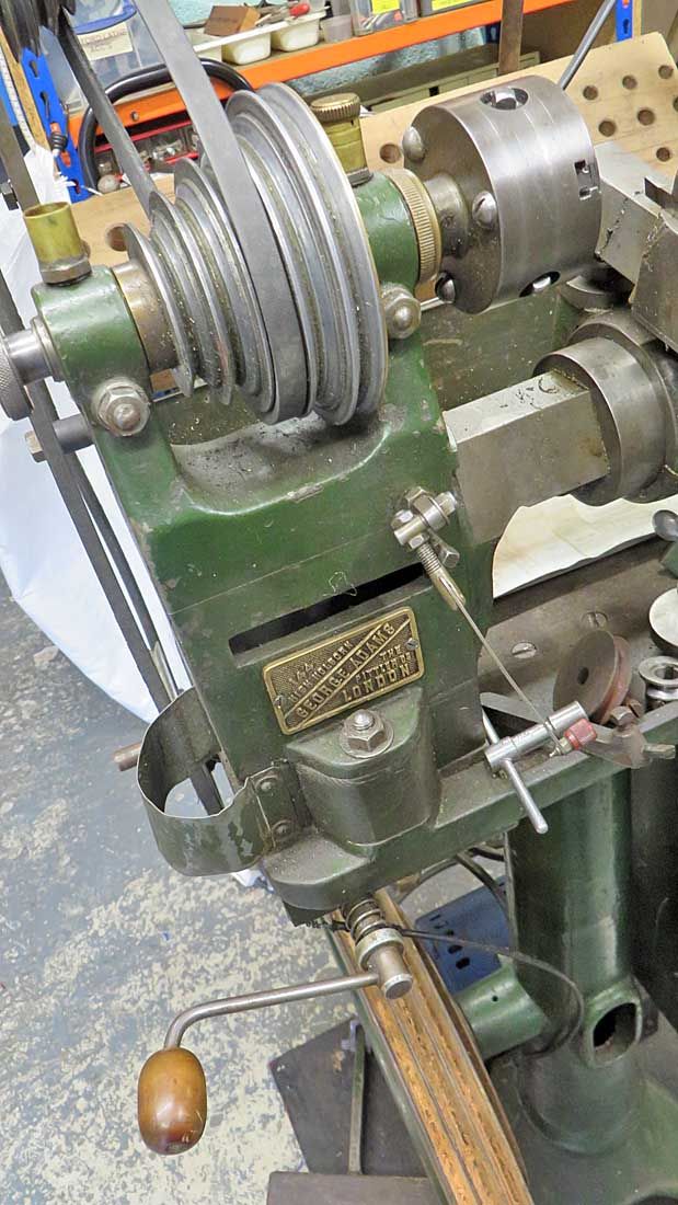

                                              Finally got it out of the car this morning, it is bloody heavy! Assembled the main parts:

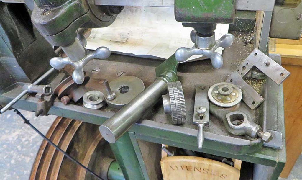

                                              Here are the main bits and pieces with it so far:

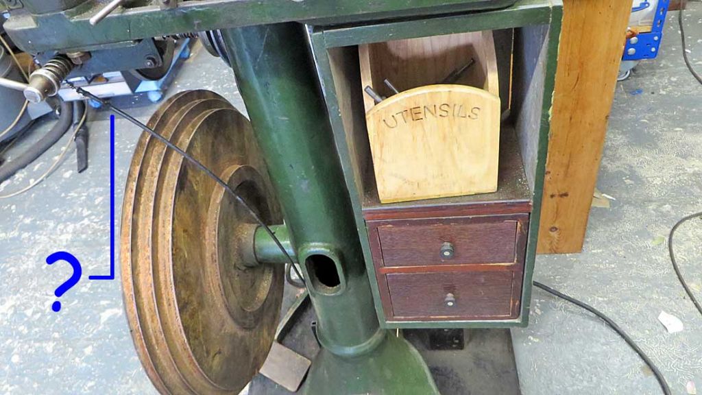

                                              There is this weird broken Bowden cable hanging loose:

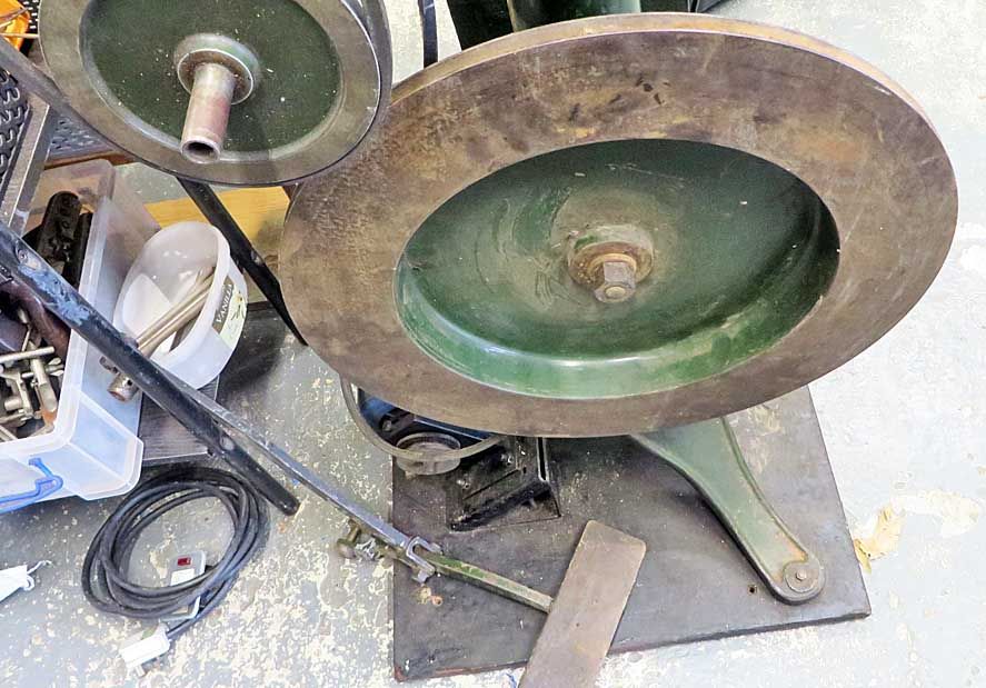

                                              The flywheel is ENORMOUS and very heavy, treadle part is also with it.
                                              The head stock has a draw bar that does not seem to screw into the chuck so not sure how the chuck comes on or off?
                                              The small drawers contain a lot of collets and some very nice gear cutters and other bits and bobs. I have been in contact with the guy I got it from and we will try and fit in with him to get the other parts even if it means another long drive.
                                              I think that I will just clean all the gunk from it and brighten up the metalwork a bit, something very gentle.
                                              Cheers, Martin

                                                  Looks very nice, it's a plain turning model B so no screwcutting which use gears & worms not used on model B. This type is far less commonly seen however.
                                                  The draw bar is for 8mm collets & other similar fittings, the chuck is a metric thread so just like any make of old lathe it might be difficult to unscrew.
                                                  Pittler lathes used a mix of metric & imperial threads on lathes exported to the UK, draw bar threads are metric but bolts are imperial Whitworth, at least they were in the early days,
                                                  I can see two parts of the dividing head, but the main casting is not visible so for some reason it was dismantled, see my website for how it should look assembled. Original equipment should include a travelling steady also.

                                                    It looks like the Bowden cable goes to the back and operates the clutch, was this standard?
                                                    What was the bit of bent alloy sheet at left of headstock for? It is very battered?
                                                    One oiler has lost its cover so will make another.
                                                    I have made a start cleaning the odd bit and it looks like it will come up very well with a bit of effort.
                                                    Cheers, Martin
