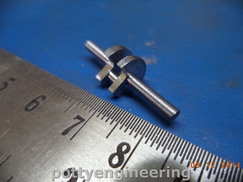

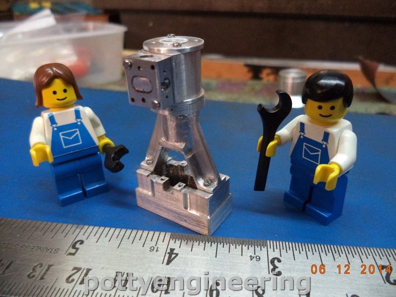

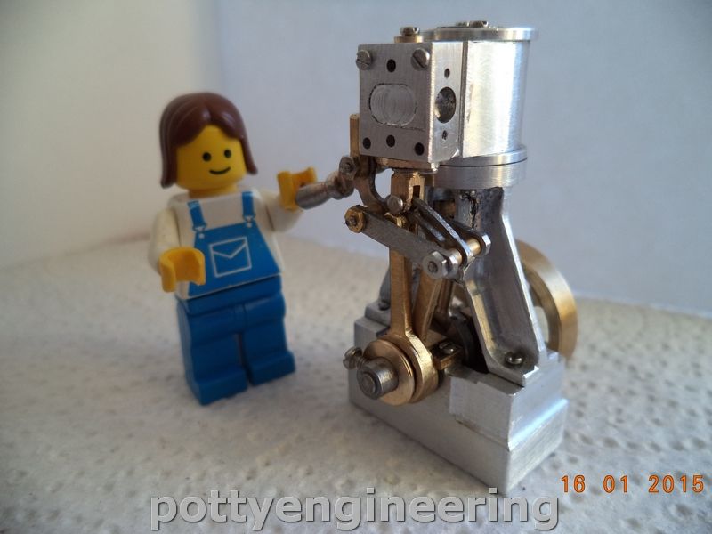

        I've been working on a tiny vertical engine with a reverse based on a design by George Britnel I redrew the engine in metric and changed the valve to a piston valve as I figured it would be easier to make
        Heir's a few progress shots and a video of it working its very much in the raw state as yet

            Those little chaps in the blue overalls look to be doing a grand job as well.

              P.S. Blue dungarees with envelopes on the front? Are they a cross between Postman Pat and Dexy's Midnight Runners?

                I wasn't very consistent running out of it so I've spent some time doing a bit of fettling and change the design slightly it know runs 100% better I'm well pleased with it.

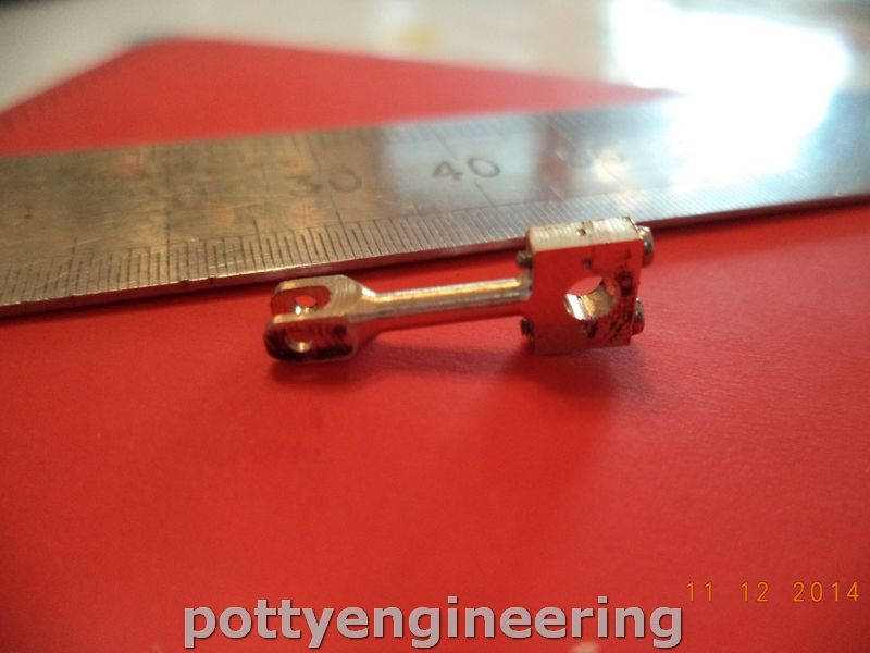

                    Nice work, I'm impressed how well it runs on 5 psi. What size bolts are holding the con-rod together?

                      the little men are dressed in Union garb overalls…so im surprised the project got off the ground at all !!

                        There M1

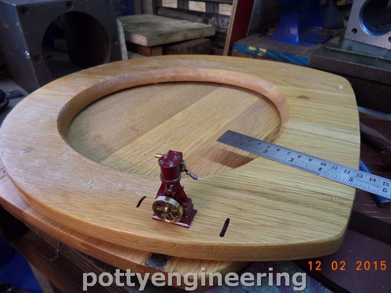

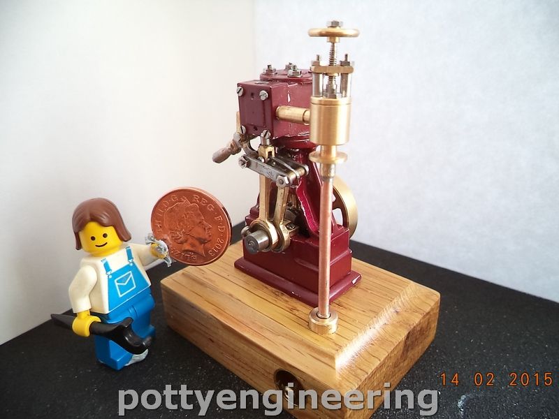

                            Well I've been tinkering about with this little beast for long enough so decided to do a bit of finishing work to it
                            Made a base from a chip off the old thrown
                            Enjoy
                            Stew

                              Well now we know the real reason it's 'potty' engineering.
                              You'd better write that one up for Diane!

                                I Have it on good authority that the base is made from Bog Oak

                                  Very impressive at low speed. Good example of precision engineering but I think you've missed an opertunity to make a really nice picture frame for someone's Mother-in-law! 😉

                                    Now that is what I wood call a good “Bog Standard” designembarrassed

                                      Particular congratulations to make something that stands comparison with its inspiration in the Joe Martin craftsmanship gallery!
                                      This is George Britnell's original, to my eye Stew's looks to have finer degree of finish!
