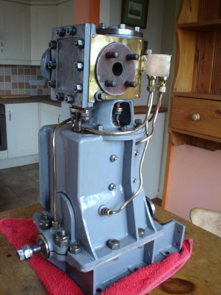

      Hi everyone, I've just got home with my first full-size steam engine, admittedly only a very tiny one. There are more pictures of the engine in my photo album of the same title.
      It's about 24 inches high and weighs about 140 lbs…it took me and my burly mate Lawrence to lift it onto my kitchen table, I'll not be trying to move it myself.
      Apparently, it's out of a Royal Navy ship and was used to drive a generator or pump. It was found a few years ago in a Portsmouth ship-breaker's yard. It has a bore and stroke of about 3 & 1/2" x 3 & 1/2" I am told, and has a pressure test date of 27/7/05 stamped on it, making it nearly 110 years old!
      surprise
      I don't have a definite idea what I am going to do with this little beauty, but a couple of possibilities so far are driving a line shaft in my outside workshop, or possibly, with a reversing gearbox, driving a steam launch.
      I've never had anything to do with a steam engine this big (!) before, so I'd like to hear opinions from more knowledgeable members of this forum. The main thing I'd like to know is, how big a boiler would I need to run this little beast? I'd like to go for a proper coal-fired boiler, because…well, just because! …I love the smell!
      Please feel free to comment, even if only to tell me I'm barking mad!

                    The fourth picture in your Album shows engineering features that may be relevant to long-standing debates:
                    • The nuts have [I think] the original Whitworth proportions in relation to the thread size.
                    • The full-nuts are at the bottom, with thin lock-nuts on top.
                    • The full-nuts have their flat face to the casting, and chamfer upward.
                    If there is evidence that this engine is 'as first built' then it would be worth documenting such details for reference.
                    … The first point is not contentious, but may be useful to future generations.
                    … The second and third have been argued-about for decades !!
                      Looks like that to me too
                      But it may have been stripped down a few times!
                      As a fast single cylinder it may need to valve timing tweaking to make it more economical on steam for use on a launch, and it won't reliably self-start. You could use a gearbox for reversing.

                          Hi everyone, thank you for all those helpful comments, it's nice that it's not just me that's excited about it!
                          It's very interesting about the way the nuts have been put on (thanks, MichaelG), that hadn't even occurred to me! I will photograph the dismantling process carefully, to make sure I get everything right when I put it back together!
                          Neil, thanks for the suggestion about retiming the engine, that's a damn good idea!
                          The chap I bought it off said that the bearings would need replacing if I'm going to do more with it than just watch it tick over- they appear to be split brasses, something I've heard about but never encountered. It looks like my lathe is going to get a grown-up job to do, soon!
                          Thanks again for all the positive comments, I'll keep you all posted but it may not be for a while, as I'm doing college work until the end of June and that doesn't leave me much workshop time, sadly. sad

                            Even if you did play with the timing you would not have a very usable engine in a launch. These small enclosed engines were designed to run for extended periods at speeds of around 1000rpm which is where they developed the best power.
                            Its unusual that it has a square access panel when virtually all of the other Sissons offerings had a round one and also that there is no "Sisson" cast into the crancase.
                            Your lathe should get a proper grown up job with a 10-12" flywheel which it will need
                            Got me thinking of doing a bit more on the 1/2 scale Stuart one that I have drawn up and made a tentative start on.

                                JasonB, I'm going by the 'WS' and the 'broad arrow' symbol stamped onto the valve chest cover.
                                My ML7 won't cope with a 10 – 12" flywheel, but I'm looking forward to making the bearing brasses and also a pair of cylinder drain cocks, at the moment there are just plugs in the holes where the cocks should be.
