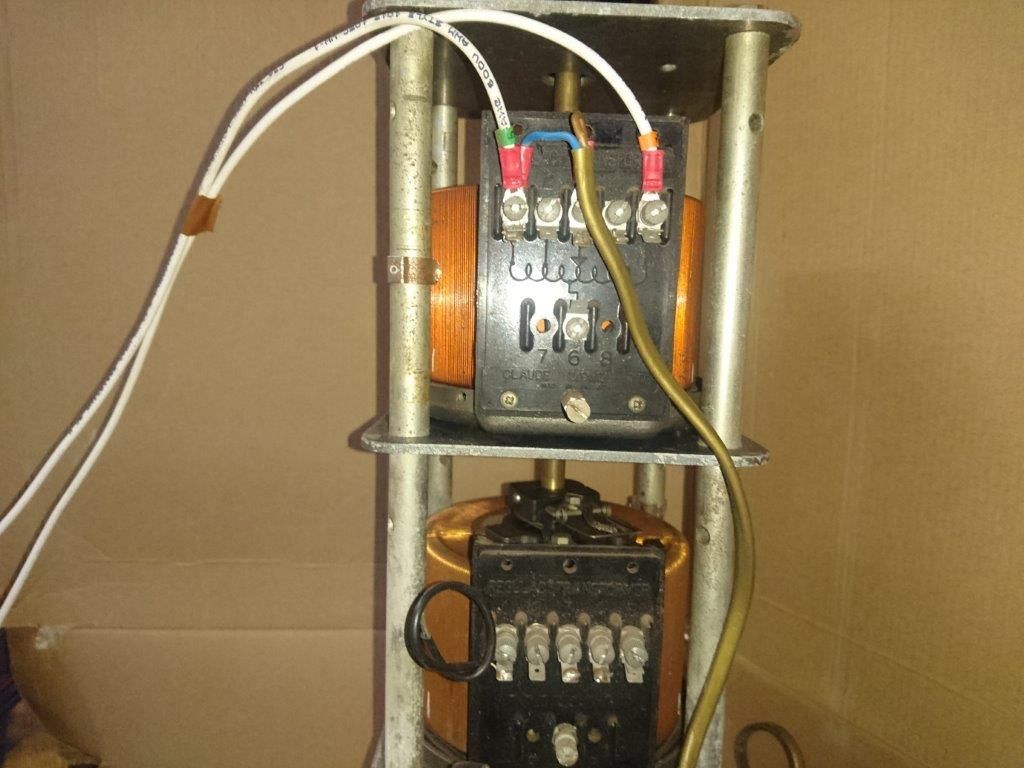

        Good morning all, and Seasons Sunday Greetings.

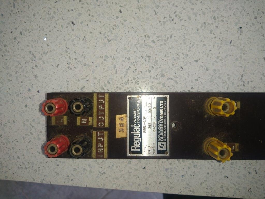

        I have been given a three phase variac, but it's not all it seems.
        Firstly the details:
        That little identity plate shows it as type no RB2L-G3M
        Input 208 volts 50/60 Hz
        Output 0 – 234 V 5A
        When I stripped the covers off to discover if it was safe to energise, I found the wiring to the input and output terminals had been cut. I've freed up the mechanism and cleaned it and now have energised it but have run into a problem with the applied voltage.
        If I apply 50 Hz volts at 115 volts to one of the three sections of the transformer across the windings. the static no load current is about 130 mA. I can vary the output voltage with the position of the slider all exactly as I would expect a Variac to behave.
        If I increase the input voltage to 210 volts the static no load current hikes up to over 6 amps, and the magic smoke appears as the windings overheat. Turn it off and have a rethink!
        If that input voltage figure is to be interpreted as 208 volts line to line connected in delta that would correspond to 120 volts line to neutral in star., which gets me into the envelope where the thing seems to be happy. Is that what the nameplate means?
        I assume what is happening with my 210 volts applied directly across one of the transformers (ie star connected) is that the core is going into saturation, and thus the inductance of the transformer plummets and the current isn't controlled by the self inductance of the winding. Anyone got any better ideas?
        Thanks as always in anticipation
        Best rgds Simon

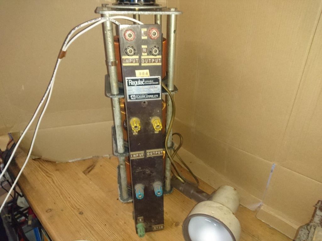

              Hi Bill, I didn't explain enough – I have three variacs stacked on a common frame, with the rotors connected mechanically to a single knob. I'll post another picture of the whole assembly later.
              The terminal board (with extra extensive safety features!!!!!!!!) has a single input neutral, and three coloured line input terminals coloured red yellow and blue. Adjacent are mounted output terminals also coloured red yellow and blue, with a single black neutral that I would assume is connected to the input neutral as the whole thing is only ever an auto-transformer.
              The photo above shows the top half of the terminal board with the red and yellow input and output terminals, also the black neutrals. Again, I'll put some more photo's up later.
              So it's a three phase variac if I connect it to three phases – which I don't have! I had some idea to split the assembly 'and end up with three single phase variacs, but that won't fly because of the issue over the input voltage.

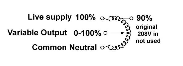

              #441727
              john swift 1
                @johnswift1

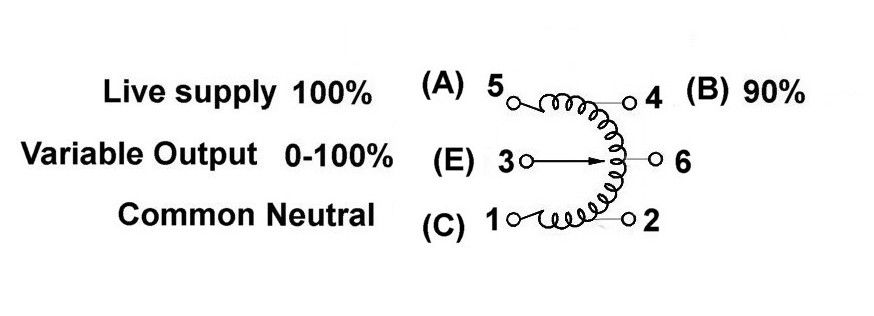

                Going by your photo it looks like it the 208 V input had been wired a fixed 89% tap and common input / output
                to give you a stepped up output of 234V 1.125% out across the total winding
                For single phase use
                I would rewire the transformer to connect your single phase supply to the ends of the winding
                with the output taken between the common and the wiper (variable tap)
                you will have 0 to 100% of your mains supply available
                add diagram

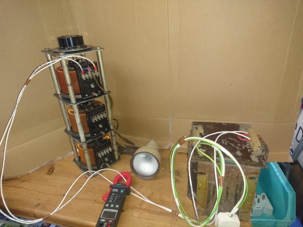

                  Good afternoon, and thanks for the help so far. Firstly a picture of the whole gismo, just to show it is a three phase unit.
                  The transformer right of picture is my "source" – it has a selection of secondary windings which means I can vary (to some extent) the input voltage to the variac under test. The scratty looking desk lamp is just a suitable load, and was diconnected when I was doing the "no load" current draw tests.

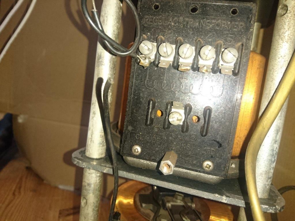

                  Here is a picture of the terminal arrangement for each of the variac elements:
                  If you look closely at the solder remnant on the tags, you can see that the original wiring was connected to a tap on the winding, not the top end. Just as John says I thought if I connected to the end of the winding I could apply anything up to 234 volts and bob's yer mother's brother. Not so.
                  Here's another close up of the terminals for each stage – this time of the middle section so my test wiring isn't obscuring the legend.
                  And lastly a better picture of the user interface terminals propped against the chassis –

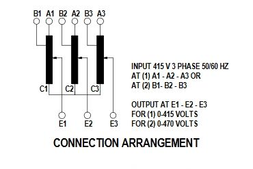

                        Looking at the photos in post 3
                        it looks like you have something like the 3 phase variac from RS components
                        RS stock number 890-2856
                        your variac terminals look like this
                        the letters A to E match the RS Components diagram
                        the neutral, if used , going to the star point C1+C2+C3
                        if you connected your lamp between 1 & 3 (C & E) and it did not work
                        check the winding continuity between 1 & 5 (A & C) and the carbon brush is OK and making contact with the winding
                        Edited By john swift 1 on 15/12/2019 18:37:34

                          #441786
                          Robert Atkinson 2
                            @robertatkinson2
                            Hi,
                            Yes it will saturte at around 180V. To get 0-120 volts connect two sections in series and use the output from one. No connection to the "upper" wiper.
                            Robert G8RPI.

                                  The circuit shown will work fine up to full current (5A in this case) on one variac. Think of 2/3 of a 3 phase star connection run unbalanced.
                                  I just looked to see if I could find justification ofr my statement and found this  "CONNECTION — SINGLE PHASE SERIES: By jumperingthe common connections, two equal single units (or two equalgroups of paralleled units) driven by the same shaft may beused at double voltage (line-to-line) in single phase serieswith external connection only to the input and output termi-nals. The load must be grounded. If an input neutral is con-nected to the common, an output neutral may be used.Transformer or loads need not be balanced to neutral "
                                  at  https://variac.com/staco/PDFCutSheets/VT%20designengine.pdf
