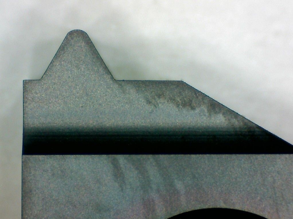

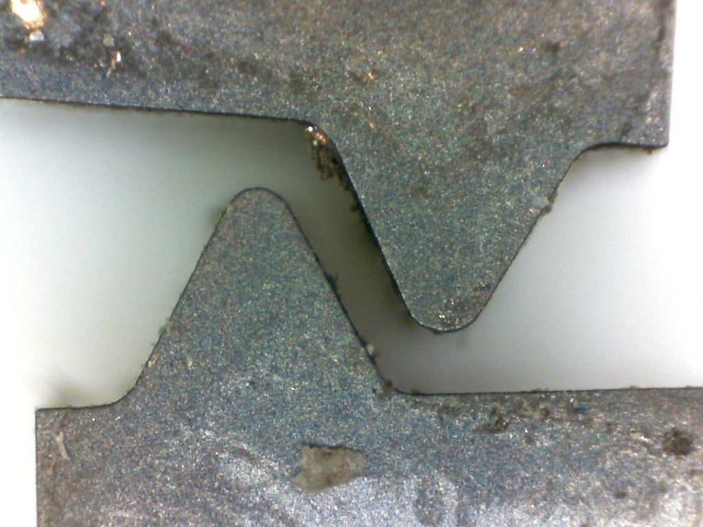

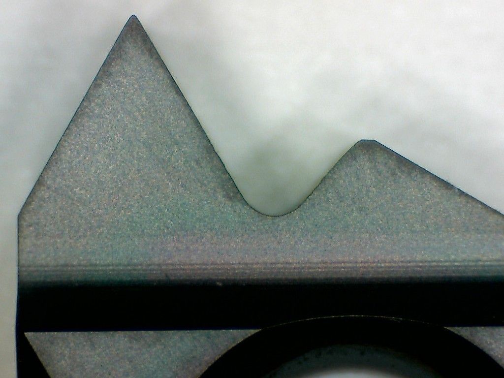

                For each thread form there are two types of insert, partial profile and full profile. A partial profile insert will cut a range of tpi/pitches. The root profile will be set for the largest tpi (smallest pitch) and will be too sharp for lower tpi (larger pitch). So some tweaking of DOC may be needed. In addition the crest will not be formed properly. In contrast a full profile insert will cut a full profile thread, including root and crest, thread but is limited to a single tpi/pitch value. Of course there are also variants for internal/external and LH/RH.
                I screwcut a lot of the threads on the lathe, mostly imperial but also some metric. I prefer to buy full profile inserts. It makes life easier and forms a better thread profile. I buy inserts as needed. In practice I cut a fairly limited range of tpi/pitch values. For instance the majority of Whitworth threads I cut are 40, 32 and 19tpi.
                For reference, a partial profile insert for metric threads:
                A full profile insert for metric thread, 2mm pitch:
                Internal and external inserts for Whitworth 19tpi:

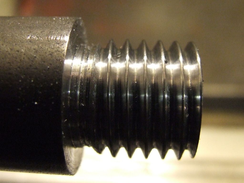

                          Must be something wrong with the tips or the technique? Touch wood I've never broken or chipped a threadking insert. I normally buy inserts from Cutwel. This is a 3/4" BSF thread screwcut with an insert:
                          Andrew

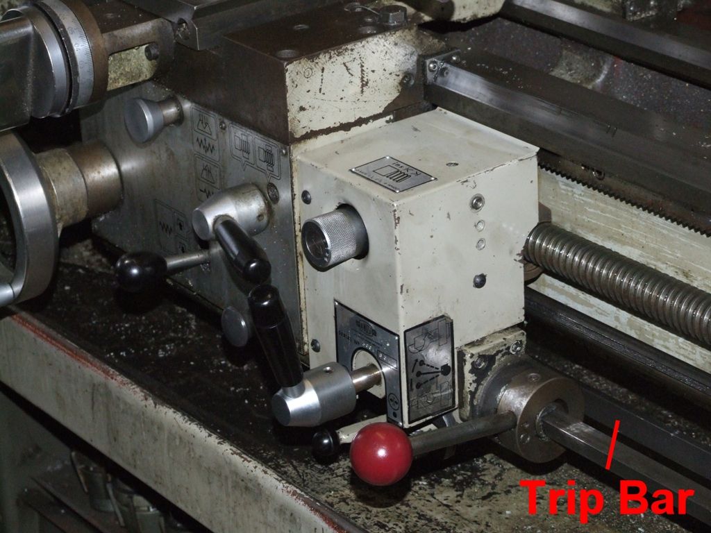

                          #607278
                            Probably not got a fancy attachment to stop the carriage travel, that is where you are most likely to damage an insertsmile p
                            #607282
                            Anonymous
                              Posted by JasonB on 25/07/2022 10:26:00:
                              …not got a fancy attachment…
                              This is what Jason is referring to, an Ainjest high speed threading unit:
                              It has it's own half nuts and also has a repeatable trip mechanism. When threading to a shoulder, or internal threading, I leave 5 thou clearance. My lathe is imperial, and the Ainjest unit only works on imperial threads.
                              This is a M16x2 thread screwcut in the normal manner, using an insert, leaving the normal saddle half nuts engaged:
                              Andrew
