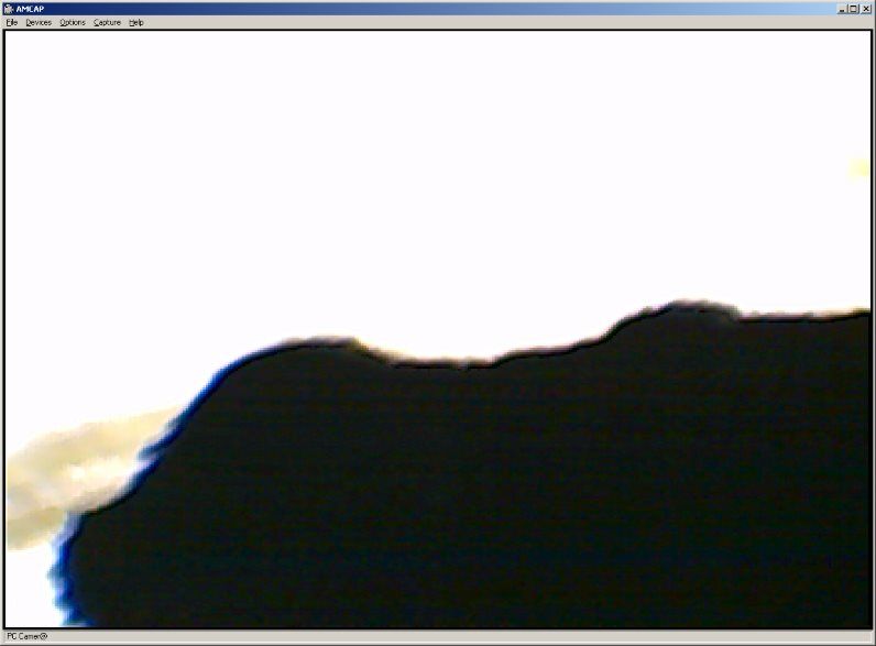

            Got the microscope out and found a bit of an issue… This is supposed to be a 0.45 gauge.
            9 more of these in my Thread Gauge album, all from the 0.45 gauge, but the 0.35 and 0.4 are much the same.

              Posted by Dave Smith the 16th on 12/06/2016 22:46:00:
              secret

                  This played on my mind for some reason and nope i was right, its a 0.45 thread pitch gauge
                  So its a 0.45 gauge it gauges 0.45 threads, well this one wont

                    Sorry, Dave …
                    The 'zipped' smiley was a bit cryptic : I was trying to skip lightly over the inevitable discussion about fitness-for-purpose, etc.
                    What I was trying to convey was something along the lines of : "If that's supposed to be a thread gauge, no wonder you're having trouble" … [expressed as "no comment"].
                    #242544
                      That gauge probably matches the quality of the screw thread quite well wink 2

                          Jason B, I didnt think of that. Just had a quick look and the threads on the screw look much better. I will pop it under the scope later for a proper look. How do you hold a gauge and a screw close to each other and on the same level? I couldn't think howto do it.
