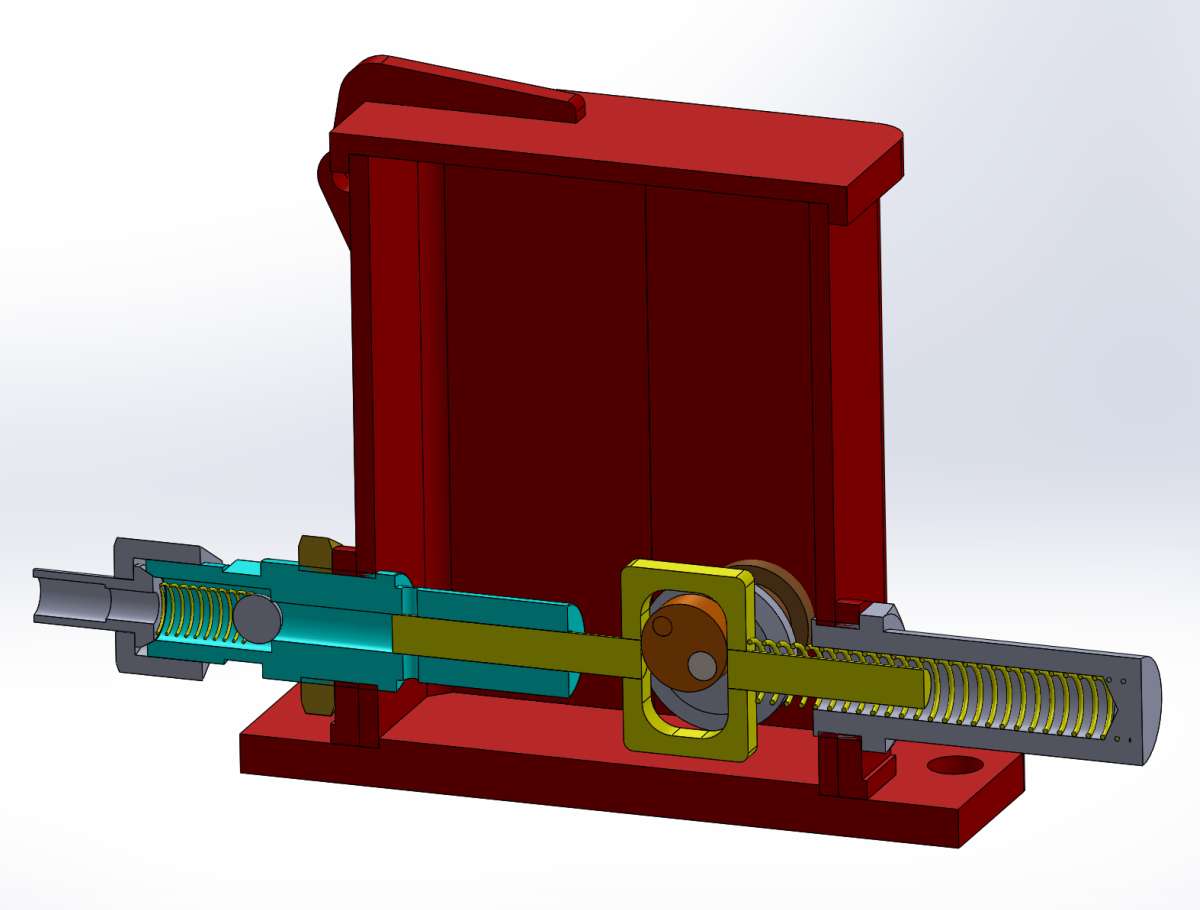

              The only real solution is to alter the lubricator. Either a smaller ram diameter or stroke is needed. A ratchet wheel with more teeth would help. Modifying the existing lubricator might be possible but probably unlikely. The “Jim Ewins” design is a good alternative. the delivery volume is easily altered.
              Ewins Lubricator 2

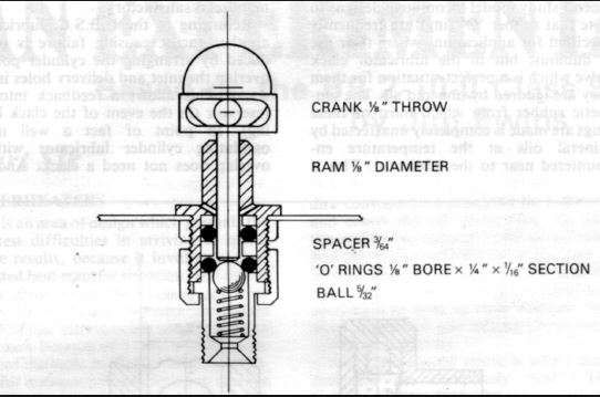

                I am unfamiliar with the lubricator on a Maisie but I have built a Foster type lubricator for my engine which has an adjustable output of oil.
                The output guide for the piston can be screwed in and out to adjust the amount of oil that enters the fitting.
                Foster Lubricator

                    Why cant you sleeve the ram? The ball valve at the bottom would want thinking about, if its got one, or is this an lbsc oscillating design.
                    With the Foster one you are reducing the effective stroke, but increasing the clearance volume. Potentially trapping a bubble of air, so no oil delivery. Manageable if you have the discipline to pump some oil through before applying back pressure

                        I have never had a problem with my Foster lubricator trapping a bubble of air.  It has worked perfectly for almost 10 years now.

                          This’ll be a standard LBSC type lubricator, I have the same on my 3.5″ Netta, and it suffered the same problem with over lubricating, so I sleeved the pump and made a smaller ram which really helped. This is the easiest solution.
                          My other engines have Ewins style lubricators as I find these alot simpler to make.

                                Given the ready availability of O rings these days along with simplicity of construction and easy adjustment there seems no objective reason why the Ewings design shouldn’t be the de-facto choice when you”just want a lubricator”. Compared to full size a simple LBSC ratchet drive lubricator is hardly prototypical so it seems silly to accept performance limitations imposed by the need for (relatively) easy construction in a bygone era.
