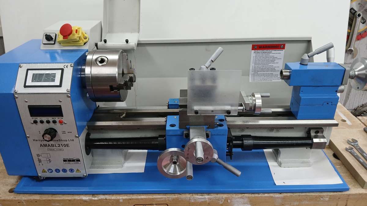

      I have just taken delivery of an AMABL210E from Amadeal with the intention of doing a review to go in ME&W. This is the Brushless motor equiped machine with the big 38mm bore spindle and also an ELS ( Electronic Lead Screw) fitted as standard.
      If anyone has a request for anything they would like me to cover then post here.

            Thanks Chaps. I was likely going to do the article covering two main areas, firstly the lathe in general which would cover Diogenes’ points all of which I had intended to cover. The second half would concentrate on the ELS and the various functions that it has. Ive only had a quick play but soon worked it out and the answer to John’s points would seem to be Yes, Yes, Yes and anything within reason including BA. Now need to read the instructions!

              The location of the E-Stop is interesting. Looks like it may be an add-on with the chuck guard.
              Question: How easy is it to defeat the chuck guard interlock?
              It looks like you could loosen two cap-head screws, slide the cover off and turn the shaft.
              Reaching past the chuck to hit the E-Stop is not a great idea. And I’m a leftie. A right handed person might reach across the chuck.

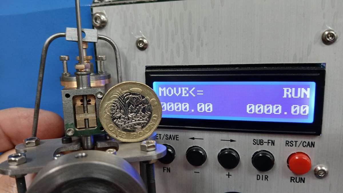

              Question: What is the readability of the two (look like LCD) displays? Particuarly the lower one on the vertical panel. What sort of angular range are they easily read?
              Question: Is there a protective “window” over the lower display? Are it and the push-buttons below it sealled aginst fluids?
              It looks like it is just a standard 16×2 LCD poked through the panel. That won’t last long in a worksop environment.

                The e-stop location is quite common on the imported machines and has been like that for a number of years, my Warco which is now 17 years old has the same arrangement.
                Yes the chuck guard can be over ridden quite easily if the individual decides they don’t want it. Again took it off my Warco years ago and only fit it on the odd occasion when the chips are flying due to the setup. but at least there is a guard if you want it unlike all those Myfords, Boxfords, Harrisons, Colchesters etc that are in home use without a chuck guard let alone leadscrew cover or chip guard on the tool post.
                I’m right handed and not had any problems hitting the e-stop or working the on/off buttons which are all part of the same NVR switch. Again many an old hobby lathe does not have an e-stop.
                I raised the point about the screen visibility in an old thread and will include that in my review. Will look at the screen protection. As for fluids how many of us are regularly using cheap (or expensive) digital callipers that are not IP rated against fluids without any problems.

                                I suspect these machines are just the standard big bore 210 machines with the ELS fitted instead of the banjo and gears so you could always buy a banjo as a spare for that lathe or just buy the whole AMABL210 with traditional gears if you did not want an ELS in which case just read the first part of the article.

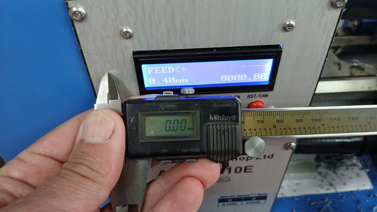

                                Well I cut several threads yesterday in steel as well as trying out a few of the other features, I’m quite impressed and can see why others who have fitted an ELS also like them. It also offers the features that I see people having to make or buy such as additional change wheels, mandrel handle, screwcutting clutches, bed stops, automatic returns, dro, etc

                                          I’ve not found visability of the screen an issue, even after Robert’s query when I thought about it a bit more. Easy to see and operate where it is and I have probably got the lathe 75-100mm lower than the usual recommended elbow height.
                                          No detailed wiring etc if you wanted to change the screen but as Robert’s comments it is a generic 2 x 16 and a separate component on teh board so could probably be changed. To put it into prospective the screen font is harder to read than my Digi caliper or mobile phone and the buttons are bigger than both. Yes a bigger screen may be nice but what is there is perfectly usable.

                                              I don’t have  agreat need for screwcutting either but I can see several advantages with this over gears which I will keep for the article.
                                              Probably of more use is the “automatic turning” which is similar to the tread cutting as it moves the tool along at a cutting feedrate by a set distance and then back to the beginning where you put on the next cut and away it goes again. Great for blind bores or just mundane repetative boring or turning to form a spigot.

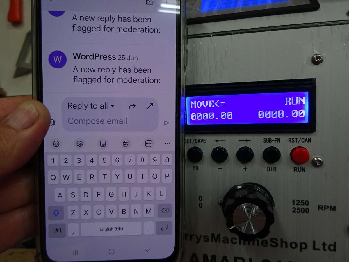

                                                From Jason’s photos the LCD is clearly a standard one designed for viewing at 90 degrees “straight on”. On the image from a standing perspective (with caliper) it has low contrast and is washed out compared to the head on shots. Not impossible to read from above but not as clear. The contrast can change with temperature as well. It could really do with being mounted at an angle. It also has no protection.
                                                It’s a shame it’s not mounted on the panel that has the RPM display. It could replace that display if they put a RPM readout on the ELS display. It seems that the ELS has been added on rather than designed in.
                                                A 3D printed angled bezel with a acrylic window for the LCD would be a big improvement.

                                                    I’ll try and measure the angle tomorrow Robert but I would say it is quite easily read looking down at 45deg which would be a total  90deg view angle if the same from below. Or maybe it is one of those that has the view angle specified by the hours of the clock and designed for viewing from above, 12 O’clock I think?
                                                    #804687
                                                      Well I had to go and confirm it.
                                                      Certainly seems to be one of the 12 o’clock type screens designed to be viewed from above. The give away is the colour inversion. At the start of the video the screen is light with dark characters due to inversion. As I move up they change to the correct light on dark and stay that way as I carry on up to hearly looking straight down.
                                                      Screen shot at the end is how I have been standing to operate the buttons. As you can see I’m looking down at 55deg and have no problem reading the screen. Also as I said earlier the lathe is quite a bit below elbow height so if setup for my use the angle would be at least 10deg less.
                                                      Plus side of it being on a vertical surface is it won’t get as wet when you spill a mug of tea over it, swarf and cast iron dust also less likely to land on the screen or around the buttons. So maybe these Chinese are not so daft.
