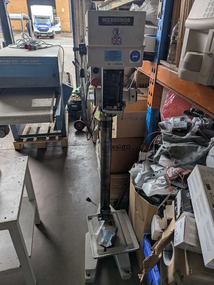

      Afternoon All,
      I’ve just acquired a 2nd hand Meddings MF4 Drill and I would like to reach the manual for it so I know how to service it etc.
      I cannot seem to find one online anywhere. Does anyone have a copy they can send me?
      Thanks

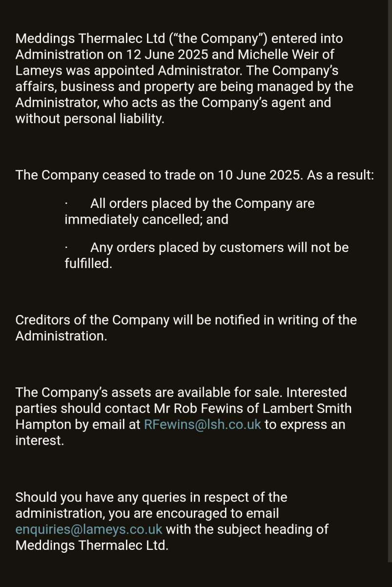

                      I chased Meddings again and got an automated response of the following-
                      I’ve chased the next linked person, but it looks like Meddings might be gone!

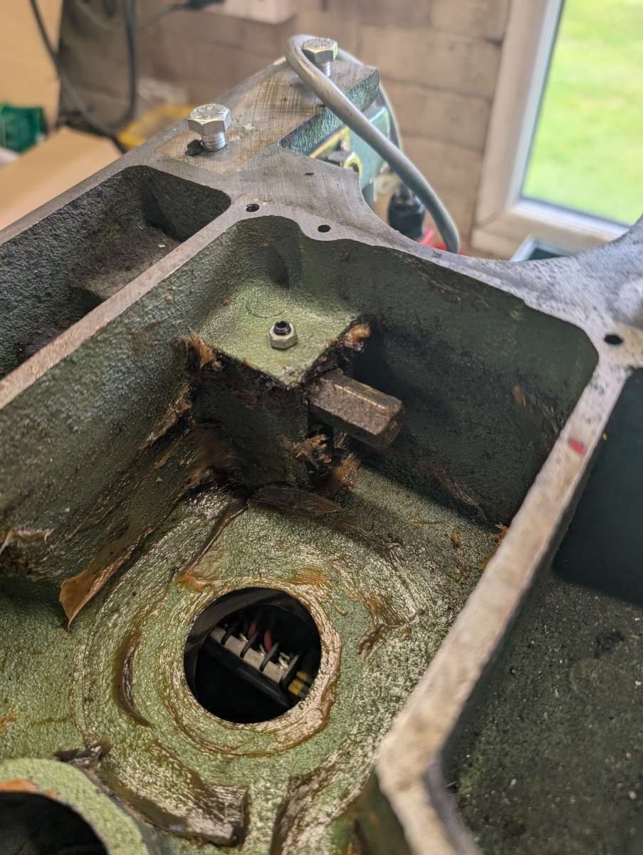

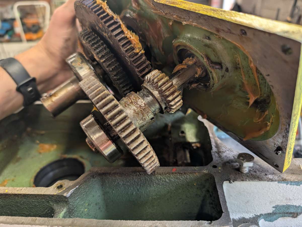

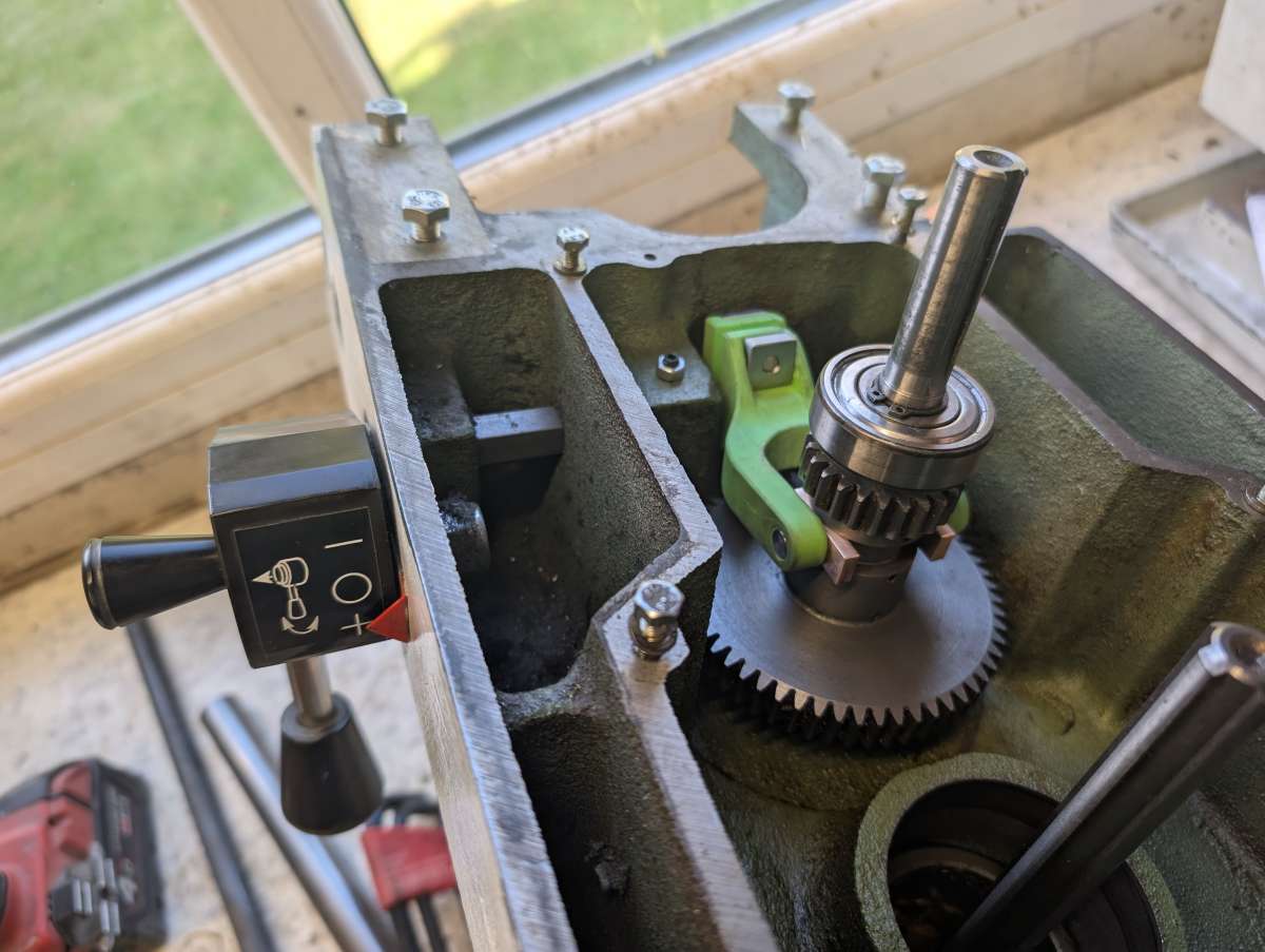

                            Good news and bad news
                            I took the drill apart to check the gearbox as I wasn’t convinced the gears were working
                            Good news- the gears are absolutely fine
                            Bad news-the gear selector arm/fork is completely gone
                            This is where the real manual would come in handy!
                            Does anyone have ideas?
                            Meddings is out of the picture now I guess so I’m a little stuck.

                            #804864

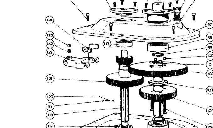

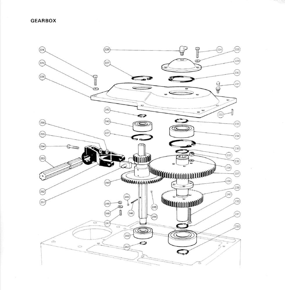

                              John Hinkley
                                @johnhinkley26699
                                Richard,
                                Maybe you didn’t download the manual I directed you to early on in the thread, or you would have seen this:
                                Meddings gear fork
                                That’s a partial screenshot from that operator’s manual.  OK, it doesn’t give any dimensions, but I doubt that information is in any paper manual you’ll find either.  It does, however, give the general form of the fork and with some creative thinking, measurements of the drill and gears, it should allow you to design and manufacture a suitable replacement.
                                #804920
                                DC31k
                                  @dc31k
                                  A little thinking will unstick you. Look at what you have. Look at the picture above. Ponder on how the item works and the physical location of the two fixed parts with which the fork interacts.
                                  You can make many prototypes very cheaply from wood (or 3D printing if that is your thing) to refine dimensions before you commit yourself to manufacture in a more permanent material.
                                  The two T-shaped pieces are brass or bronze. Steel, aluminium or cast iron would be good for the fork. It could be fabricated (welded together) and then shaped. If you imagine it in two mirrored halves, it could be laser or water-cut from thick plate and then the halves joined mechanically.
                                  Do a general search for ‘meddings rebuild’ or similar terms. You will find further photographs of the item which will assist. The MIG welding forum and the UK Workshop forum would be two good starting places for your enquiries.
                                  Engineering is about problem solving with finite resources. The best one of those resources is the grey matter between your ears.

                                    John- Yes, i did see that, thank you! I was thinking more about how I was going to sort dimensions and such.
                                    dc31k-I have had to employ a little bit of the grey stuff, I’ve only got a limited amount, so I usually save it for special occasions!
                                    I’ve come up with a design in my head and taken a few measurements.
                                    I made a start making a few bits, but the mill gave up again- New motor on the way, but I won’t be home again for another 2 weekends so it’ll have to wait! I may redesign and order some better material as I now have time to plan.
                                    Meddings M4 Mk3 strip and rebuild was very useful as that has a picture of the MK3 fork, however I will be changing my design to be adjustable so I don’t get issues with the alignment when trying to clamp to the hex selector shaft.

                                      #805436
                                      Howard Lewis
                                        @howardlewis46836
                                        Cast iron might not like the loads involved in operation, (They may be small, but C I is weak in tension, and one side of the fork will be in tension from time to time)
                                        If possible, make the fork from steel and the actual “feet” (124) that engage in the groove out of brass or phosphor bronze.
                                        Howard

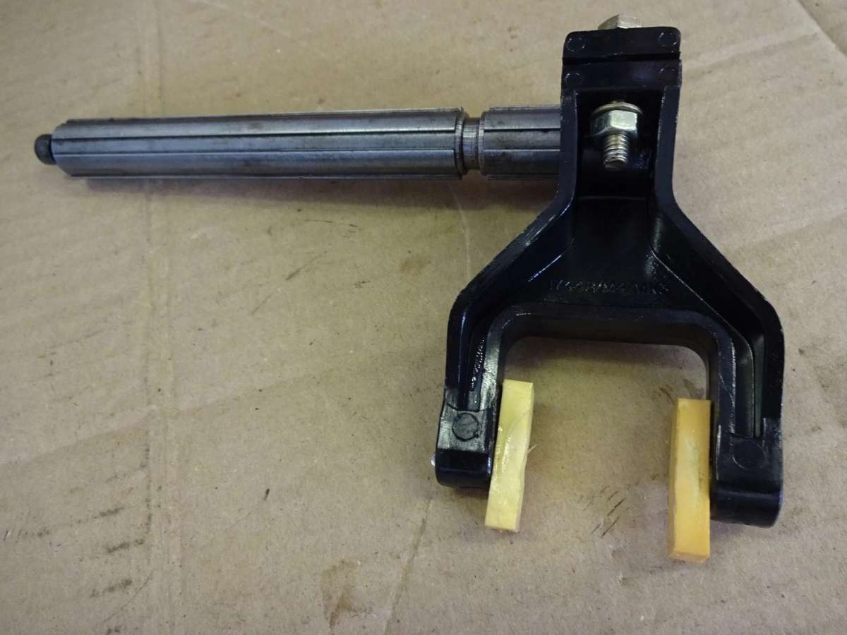

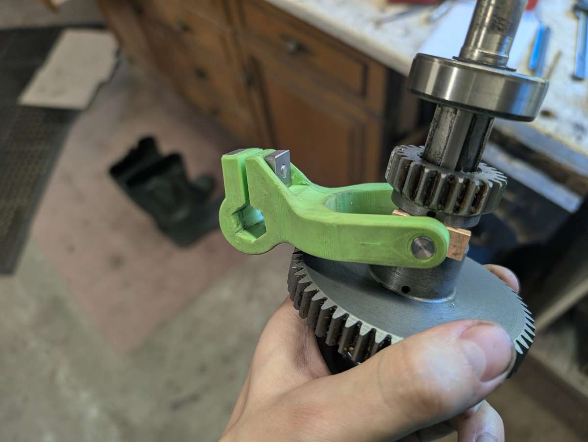

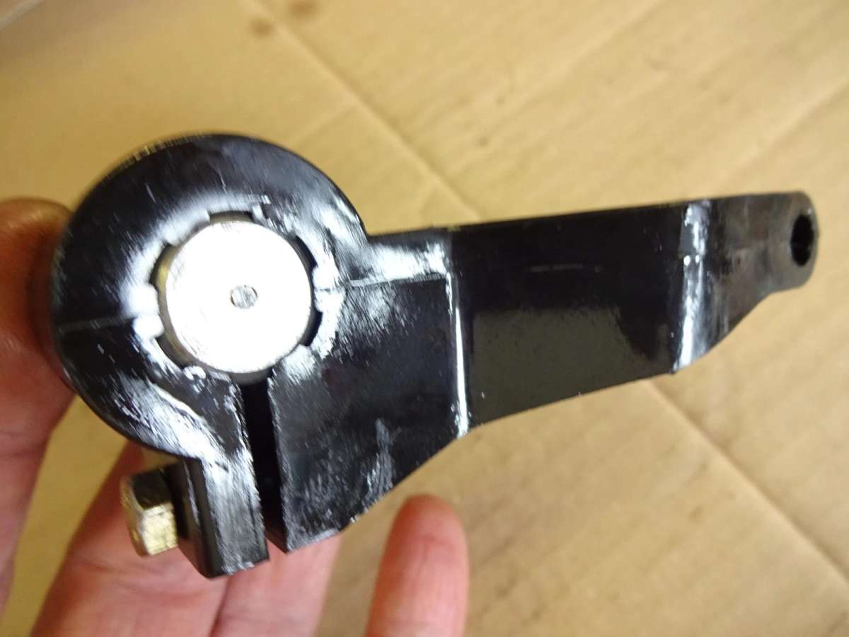

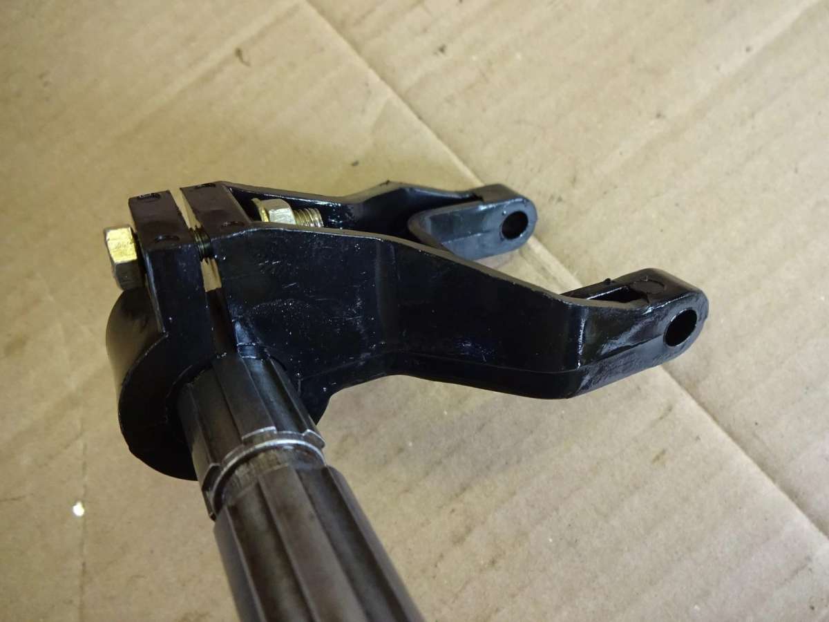

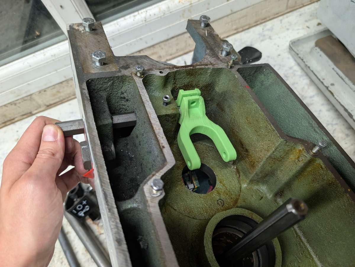

                                                  #812500
                                                  Richard Kirkman 1
                                                    @richardkirkman1
                                                    Update- The exact part has been listed on eBay, however it is £72 so I will not be purchasing it. I did speak to the shop selling it and ask to do a deal with another part (as I would have to buy the whole assembly to get it to fit my machine), but they weren’t prepared to give free postage (still costing £140 in total). Having paid £200 for the machine, and recieving £30 back for it not having the lever, £140 is too much.
                                                    However, i did get some measurements from the seller. And have confirmation that the arm is made from plastic, which simplifes production. 67mm from center to center- I had guessed 68mm from the machine so I was not far off!
                                                    s-l1600s-l1600 (1)s-l1600 (2)

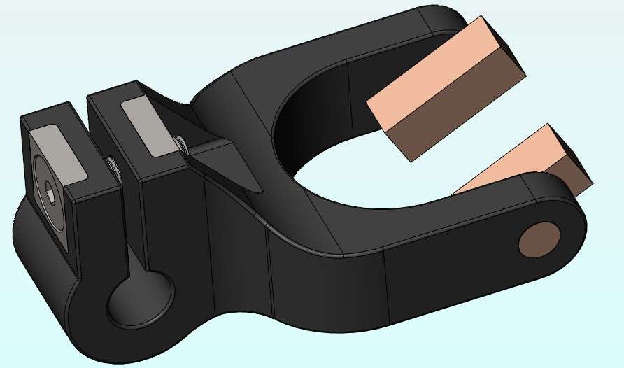

                                                    From the pics we can see that the two holes are in line with eachother, making things much simpler.
                                                    From there I got to designing a new lever in CAD.
                                                    Screenshot 2025-08-15 102038

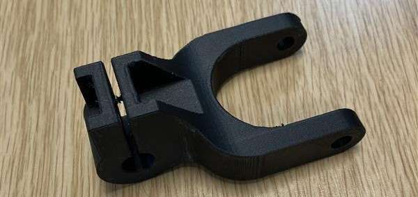

                                                    One of my colleagues offered to 3D print it for me, which made things very easy.
                                                    The pawls will still be made from Bronze, and the holes are all printed undersize so I can ream them to size.
                                                    I am unable to index or use a splined shaft (although the current shaft is hexagonal) because I don’t know the relation of the handle lever.
                                                    I may look into doing a 2nd one (maybe a good excuse to get a 3d printer…) with a hexagonal hole for the shaft, but Ideally this one will work first time. I will be playing around next weekend as I will be home for the bank hol weekend. (I may have clearance issues also, it’s hard to design without the machine in front of me)

                                                    Richard Kirkman 1
                                                      @richardkirkman1

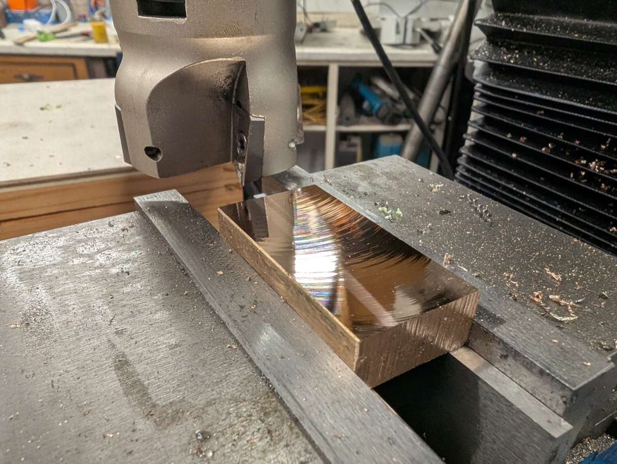

                                                      Replan- Moved towards a hexed shaft so it can be properly aligned to the selector lever.
                                                      PXL_20250904_201835912
                                                      Bronze is very nice to machine!
                                                      PXL_20250904_213705272
                                                      PXL_20250905_151044864
                                                      PXL_20250905_151531472
                                                      It does fit, but the alignment between the hex shaft is slightly off. I had set it to 5.5 degrees as that is the best i could measure.
                                                      I’ve just got my own 3d printer, so I will print off a few with different angles, although I suspect it is just 5 degrees. Test and then reprint in a stronger material. Also a good opportunity for some other design changes(not green). I’m quite enjoying the trial and error. It was interesting to figure out how to put the gearbox back together with another part in, as it came to pieces much more easily without the part!
