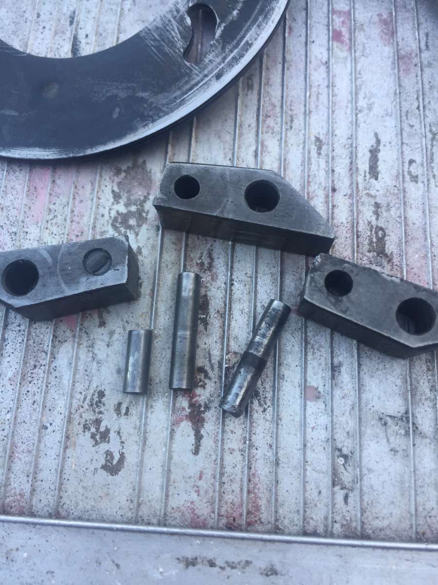

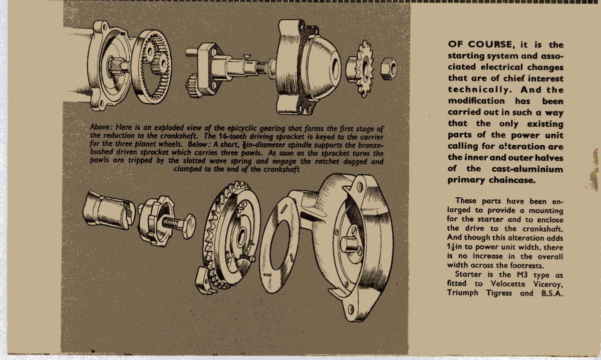

      I have a Norton Electra motorcycle which has a notoriously weak electric starter system. Part of this is a set of 3 pawls which are pivoted and rotated by 4mm steel pins which engage with arcuate slots in a “wave” spring. The pawls drive a rathcet arrangement on the end of the crankshaft.
      One of these pins broke and I am struggling to find an appropriate material to replace it. One owner of a similar machine suggested using 4mm HSS drill shanks: I tried this and the pin bent on first use. I replaced it with a pin made from 4mm silver steel (BS1407) but again the pin bent after a few starts. I used the material as supplied as I have no hardening facilities.
      Can anyone recommend a suitable material for this purpose? Another owner has suggested using the shank of a 4mm high tensile socket head screw but I’m dubious.

                    This shows the general layout – the ratchet etc are shown at the bottom.

                                                  From what I can see of the fracture, (a blow up of this would have been helpful). The pin is “case hardened” and has a soft core. Any commercial dowel is going to be of the same construction. A Needle roller in this size would probably be hardened all the way through, but may well be tempered for maximum hardness and thus could be too brittle for this application.
                                                  The shank of a HSS 4mm Drill will be soft as you have already found out. An Allen Cap screw shank will not give you a much better performance than Silver Steel which is soft. Which you have tried.
                                                  Round HSS tool or Drill blanks would I suspect be the best way to go. Drill blanks in particular will be on size if you purchase from the likes of Dormer, etc.
                                                  Without hardening and tempering facilities for Silver Steel I would be inclined to go for the Drill Blank option, but these may well be down on size and not a press fit. High strength Loctite would be my choice here, a grade that will tolerate oil.
                                                  Was the shank of the 4mm Drill a “press fit”?
                                                  I know it would have been down on 4mm by about 0.025mm, so I am really wondering if you do not want 5/32″ diameter material. This assumption is based on the bike being a Norton.
                                                  Regards
                                                  Gray,
                                                  PS I would replace all 3 with the new material, it will always fail at the weakest point.

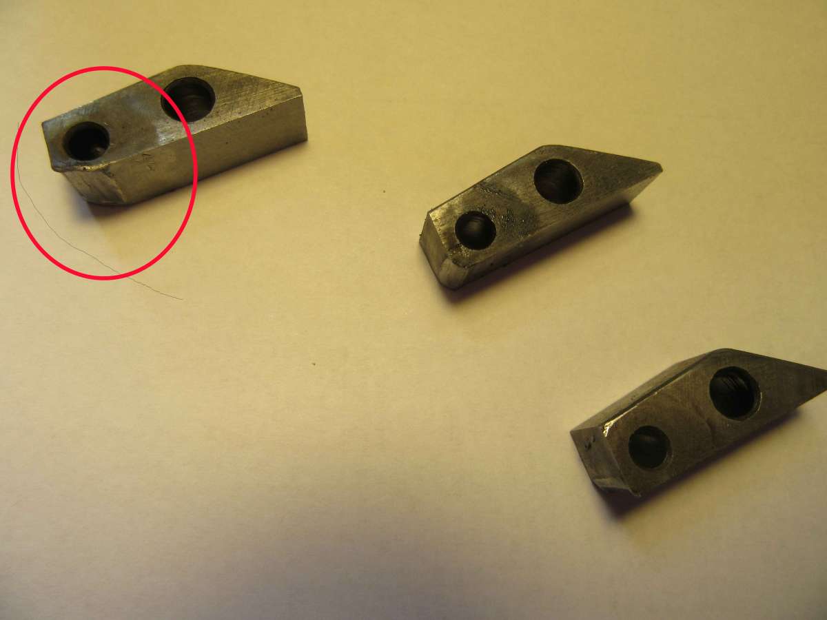

                                                    Many thanks Gray, excellent points. The original (I assume) pin broke rather than bending but both the drill shank and silver steel replacements bent. Both, at 4mm, were a light press fit. I agree re replacing all three so have now removed the pivot pins and pawls. There is a fair amount of visible wear on the pivot pins and the holes in the pawls are (intentionally I assume?) about .010″ larger than the pins and the retaining holes for the pins. This gives a lot of “float” on the pivots.
                                                    As you may be able to see all pawls are significantly worn on the face that engages the ratchet, but one (not the one that keeps failing) far more than the others indicating it has taken most of the load.
                                                    Advice from the owners’ club experts is to have the worn faces built up with weld which I will need to have done as my welding skills are minimal but I’m sure I can find someone to do it locally. Then I’ll be able to file/grind back to original profile. The pawl material is obviously quite soft.
                                                    The operation of the device is that the pins only serve to pull the pawls into engagement with the ratchet attached to the end of the crankshaft and once in contact these should be held in position by the torque from the starter motor until the engine starts when the ratchet spins faster than the starter, pushing the pawls back out so they clear the outer part of the ratchet.
