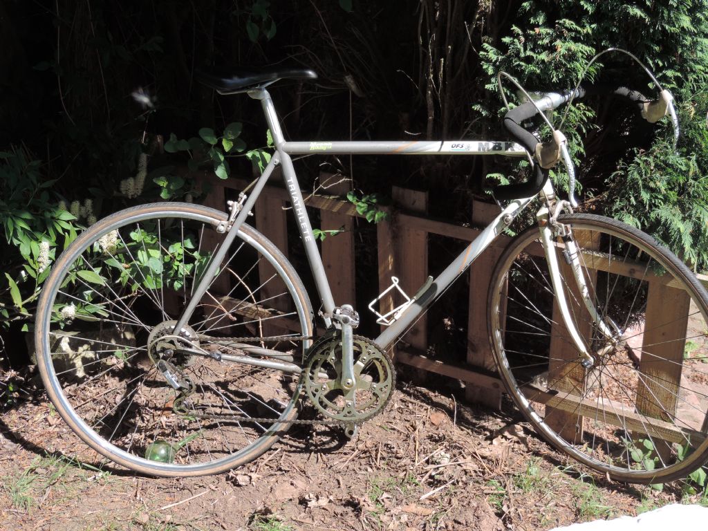

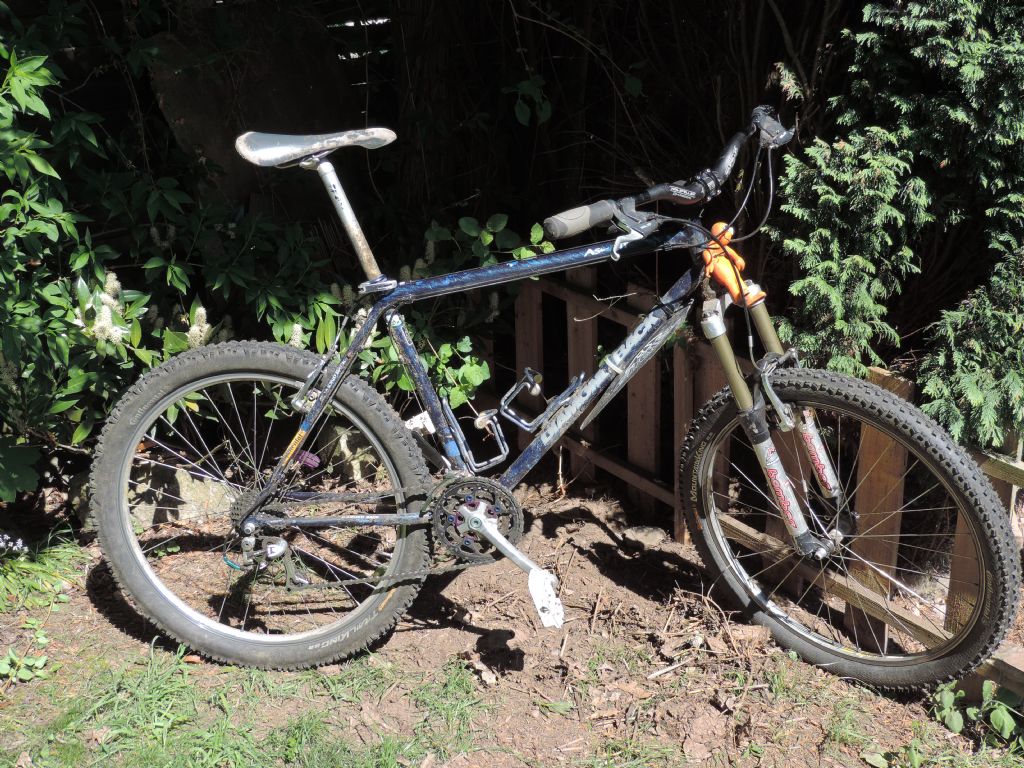

        #547853
          Sorry for diverting this thread off course… I found a couple of pics of my bikes, one almost original the other endlessly upgraded!
