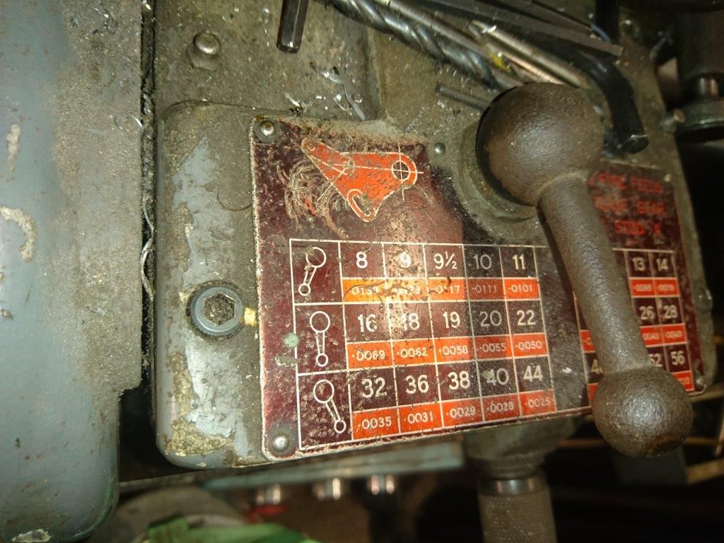

        I’ve cut quite a few different types of imperial threads on my Myford Super 7B with success however, I now have a problem!
        I’m trying to cut a 1” x 24tpi UN thread… my scratch test is way out! The plate on the gearbox states “For fine feeds reverse gear on stud ‘A’ ”.
        I can’t find stud ‘A’. Can anyone help?

          The gear is the one held in place with the 'latch strap' for want of a better word. Open the cover to the gear train and it should be obvious. The black strap just swings out of the way and the gear can be removed and reversed.
          If you have cut threads before you will have had the gear in the correct orientation I should have thought. You don't want fine feeds for thread cutting. Is ther not a picture on th gearbox plate?

              Just to add a bit of detail to Martin's posts. The gear on stud A is a tandem 19/57 tooth compound if that helps you recognise it and as he says, it is reversed on that stud to give fine feeds for normal machining…
              24 tpi is a standard pitch that the gearbox can provide, the middle choice of the set 12/24/48 tpi , just follow the picture on the gearbox plate and set it accordingly.

                  24TPI isn't a fine feed within the meaning of the phrase in this circumstance, and you don't need to reverse the 17/57 gear pair on stud A to get it. Reversing this gear gives you the range of fine feeds as marked on the gearbox label, but we're talking about a few thou per rev (13 down to 1) such as you would use in turning a parallel surface.
                  If setting the top lever to centre, and the sliding handle to third from the right doesn't get you 24TPI there is something else wrong. Could you let us know what thread your scratch test showed, maybe we can reverse engineer the cause from the symptoms.
                  Handily my picture happens to be taken from the very angle that lets the top lever obscure the 24TPI setting on the label.
                  What thread have you actually cut, and if it is very fine indeed is the gear on stud A already reversed?
                  Otherwise can we have a picture of the gear train from the mandrel down to the gearbox input gear cos' the explanation's there somewhere.

                    I managed to figure out what I was doing wrong. The gear leaver on the top of the gearbox was not engaged in the middle position although it looked as if it was… it was actually cutting 12 tpi instead of 24 tpi.

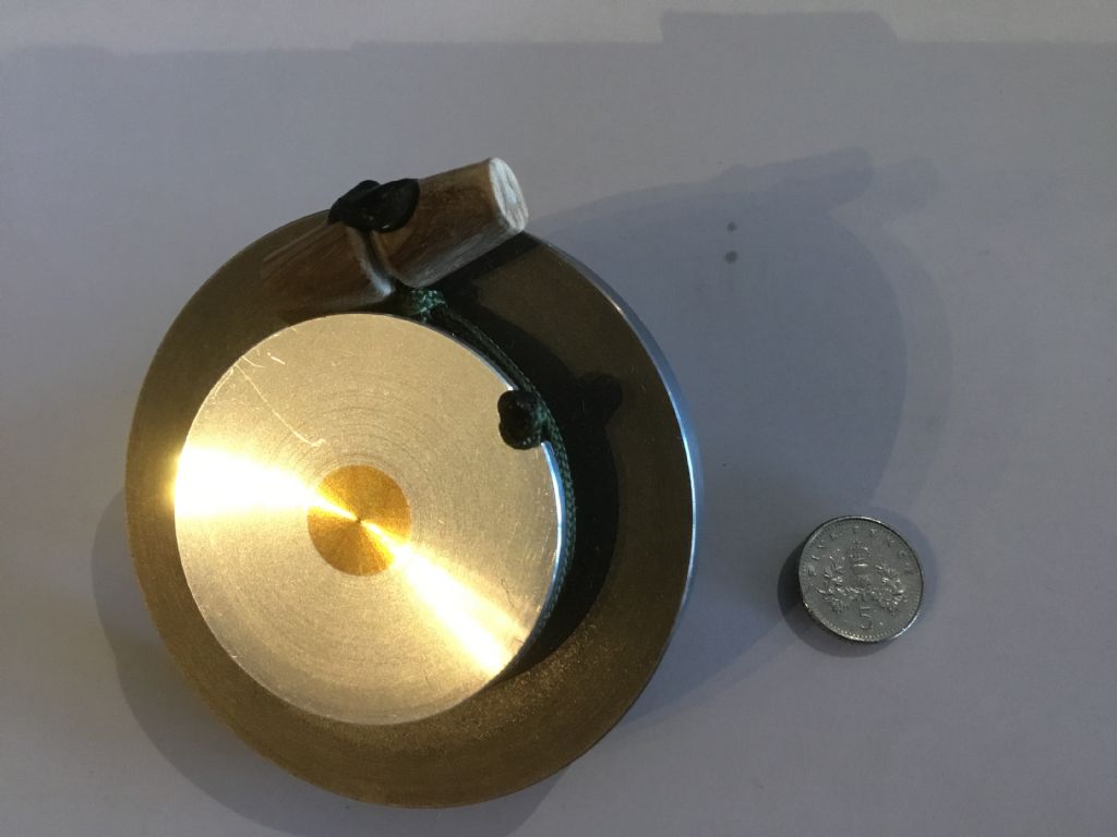

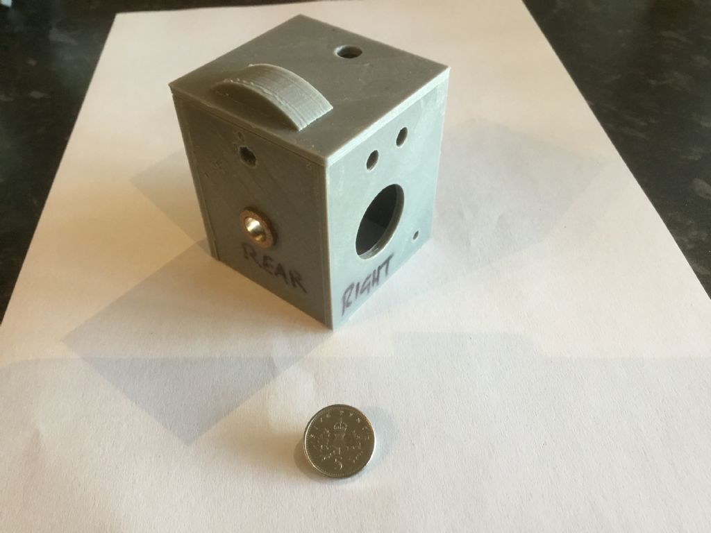

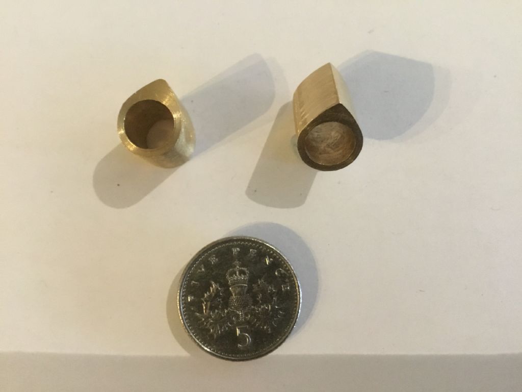

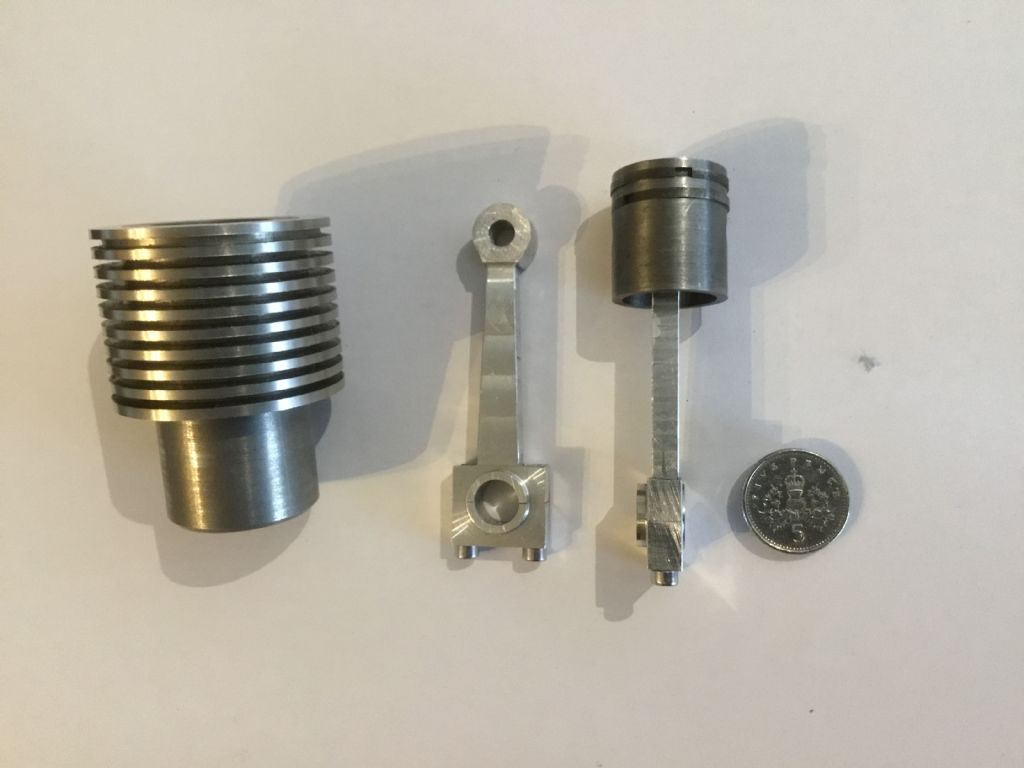

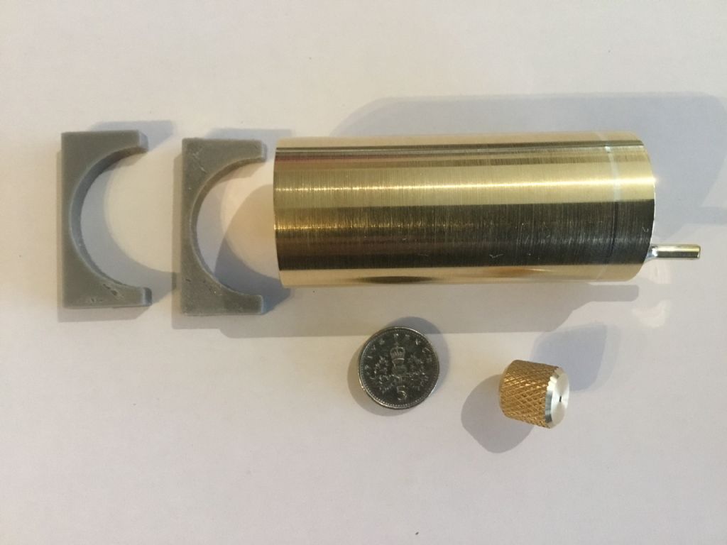

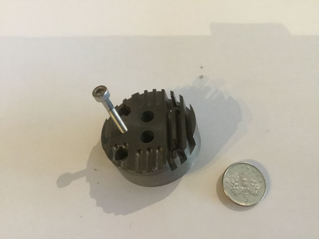

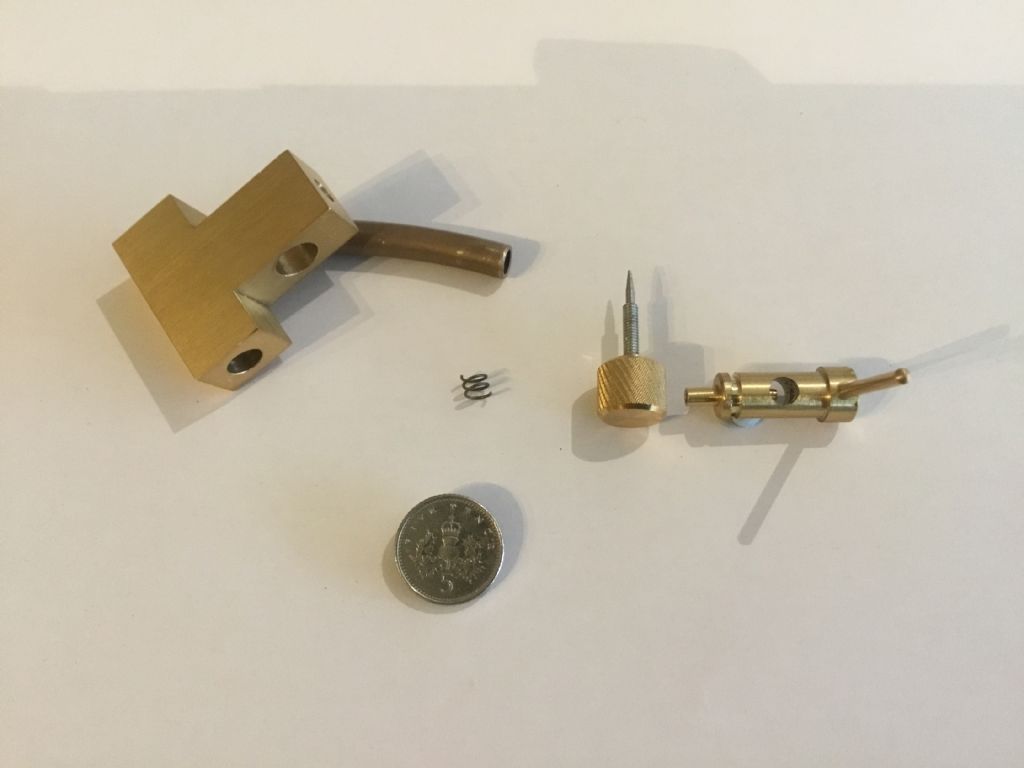

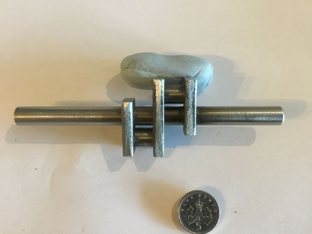

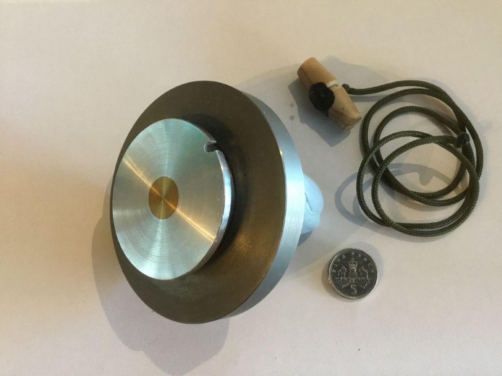

                            As requested, here are some photos of my build so far:
                            1. The Petrol tank
                            2. A CAD mock-up of the casing.
                            3. Cylinder head.
                            4. Crankshafts.
                            5. Flywheel 01.
                            6. Cylinder, con-rods, and piston.
                            7. Flywheel 02.
                            8. Cams.
                            9. Carburettor.
