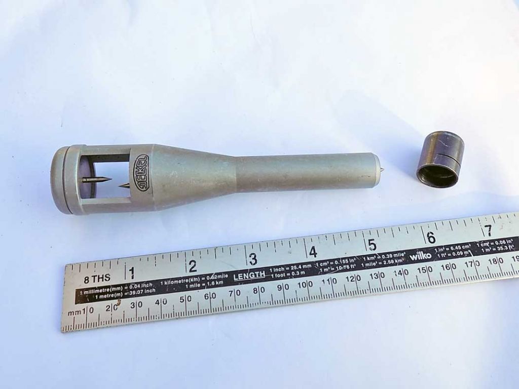

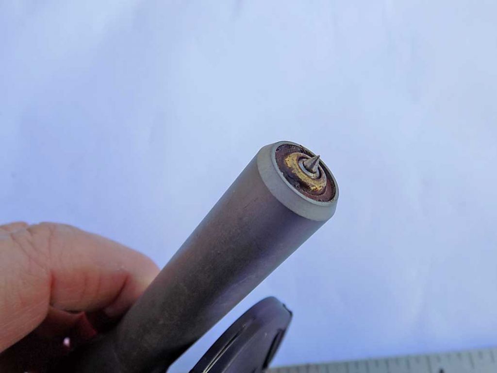

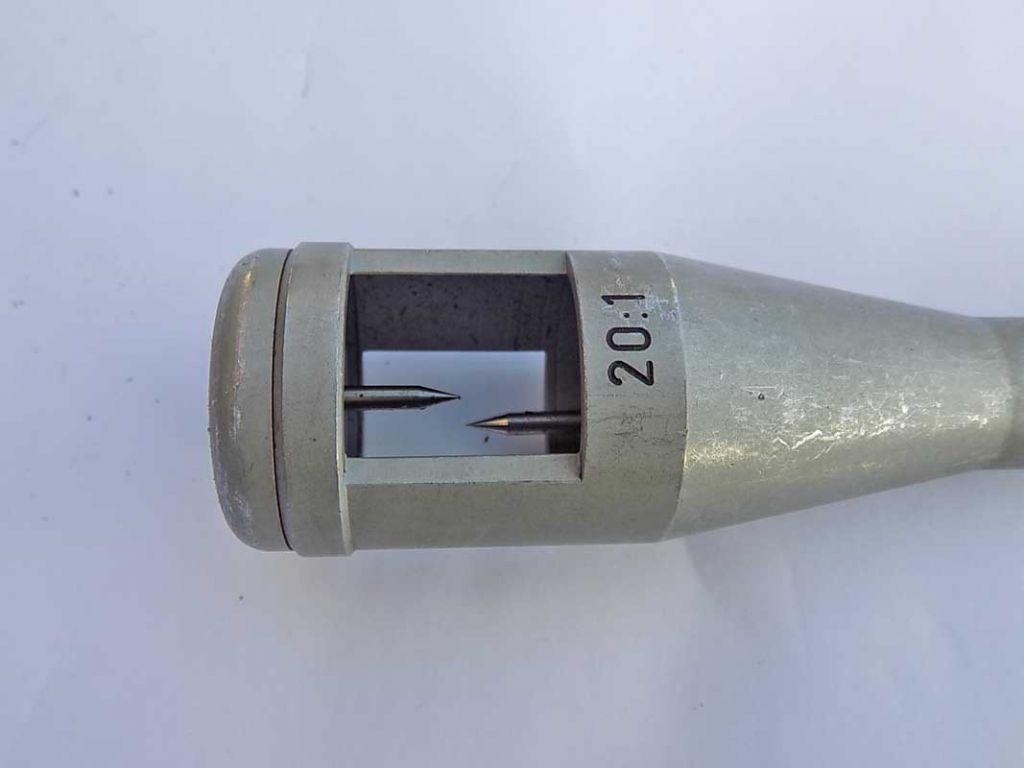

        Hi All,
        Found this in Sherborne yesterday along with some other nice bits and pieces, seem very well made but no idea what it is used for.
        Makers name looks like DECKEL and has 20:1 on the side.
        All help gratefully received! smiley Martin
        #343177
          Put the point in the last photo into a ctr hole or punch mark and clock it true by watching until the two points in the other end line up. what error you have at the work end is magnified by 20 times at the visual end. see one here
          Edited By JasonB on 25/02/2018 16:14:35
          #343181
          Martin King 2
            @martinking2
            Jason, many thanks indeed! Looked up Deckel but did not find that! Kind of a posh wobbler…laugh
            Martin
            #343184
            Tractor man
              @tractorman
              It looks more like a point finder rather that something to use while a machine is in motion. The lathes picture shows it in a carrier indicating a point on a punch.
