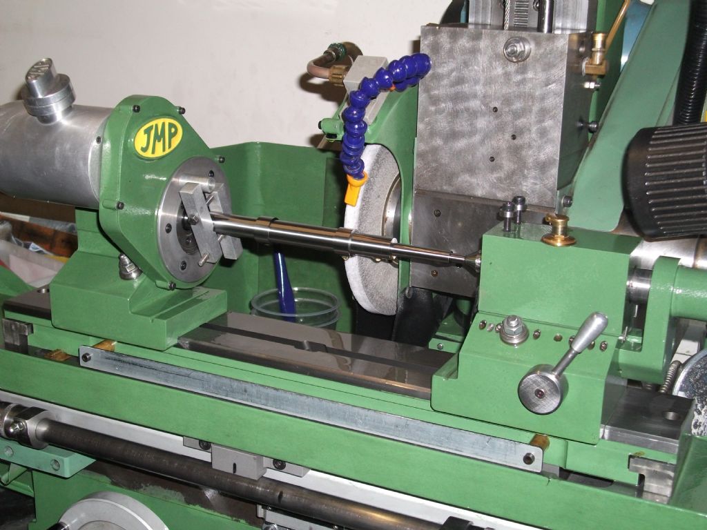

                            I use only pumped neat cutting oils for cutting and grinding
                            Exelcut 401 for turning and milling steel ,aluminium ,brass ,cast iron.
                            Excelcut 433 for grinding all of the same.
                            No rust problems ever, keeps the machines clean and oiled
                            I buy it from J& L the 401 is sometimes on offer in the Advantage flyer.

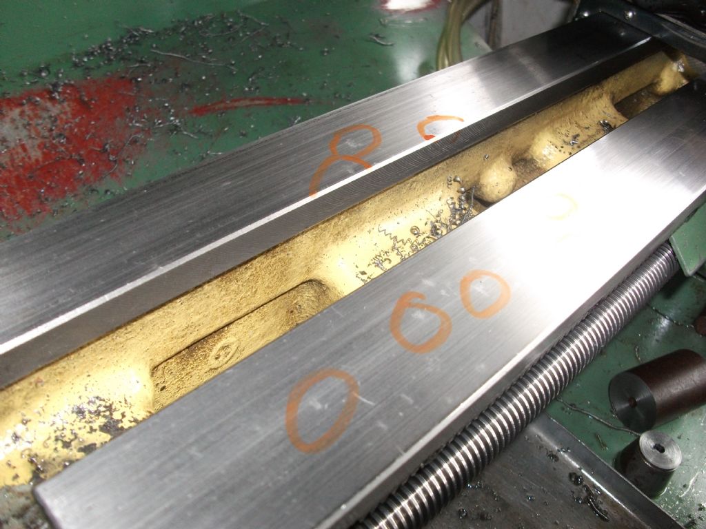

                                      For a short while whilst doing a paid job i had to use some
                                      Rocol V cut ss soluble coolant in the Myford, the photo here
                                      shows the damage to the lathe bed that you can feel with
                                      your finger tip not just the nail .I don't know if there was some interaction
                                      between the cutting oil and the slideway oil that caused this .
                                      I originally used the Rocol on the cylindrical grinder the continual
                                      rusting problems with this have gone away with the neat grinding oil,
                                      The rocol is now only used in the cut off bandsaw.
