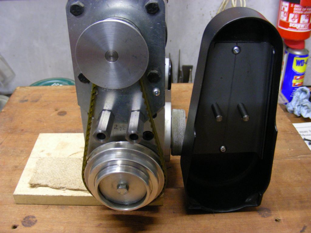

                    I made a small mod to the belt cover on my unit which allows me to apply a gentle push to the machine when needed (I have to take care not to attempt to lift the machine by the new handle):
