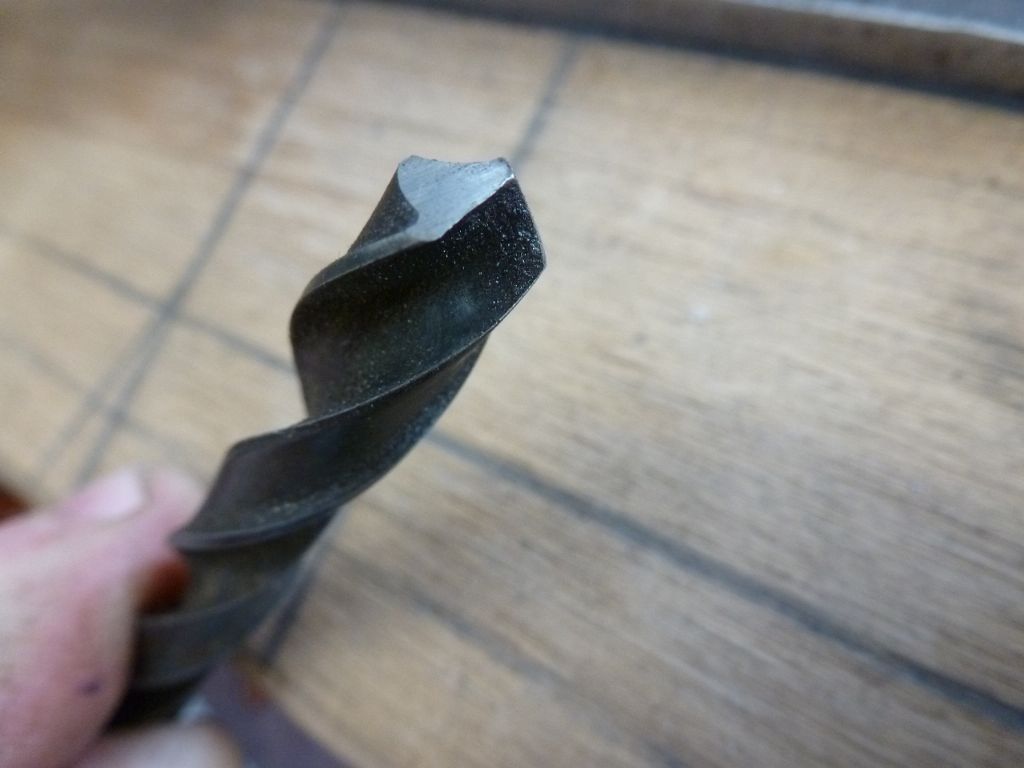

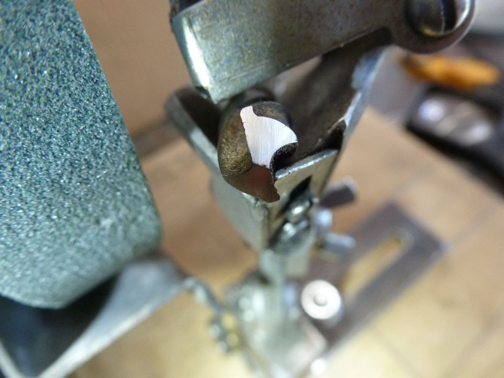

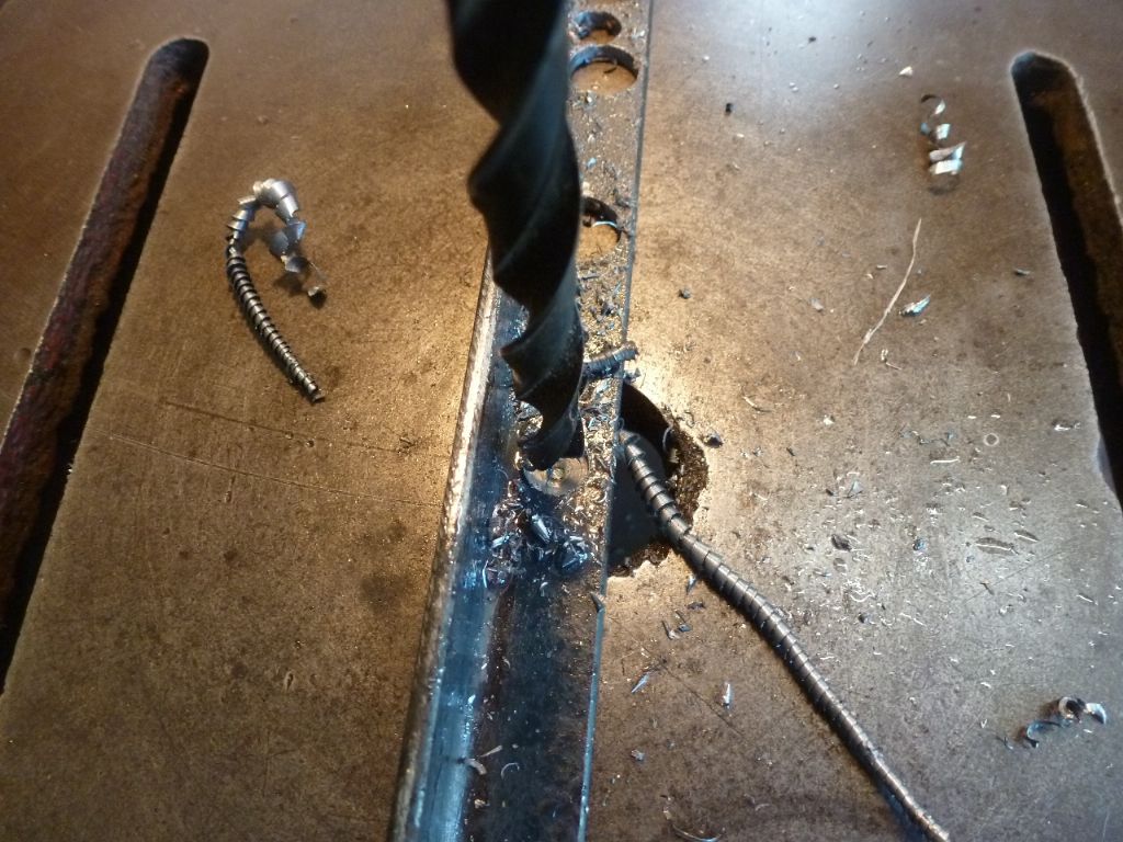

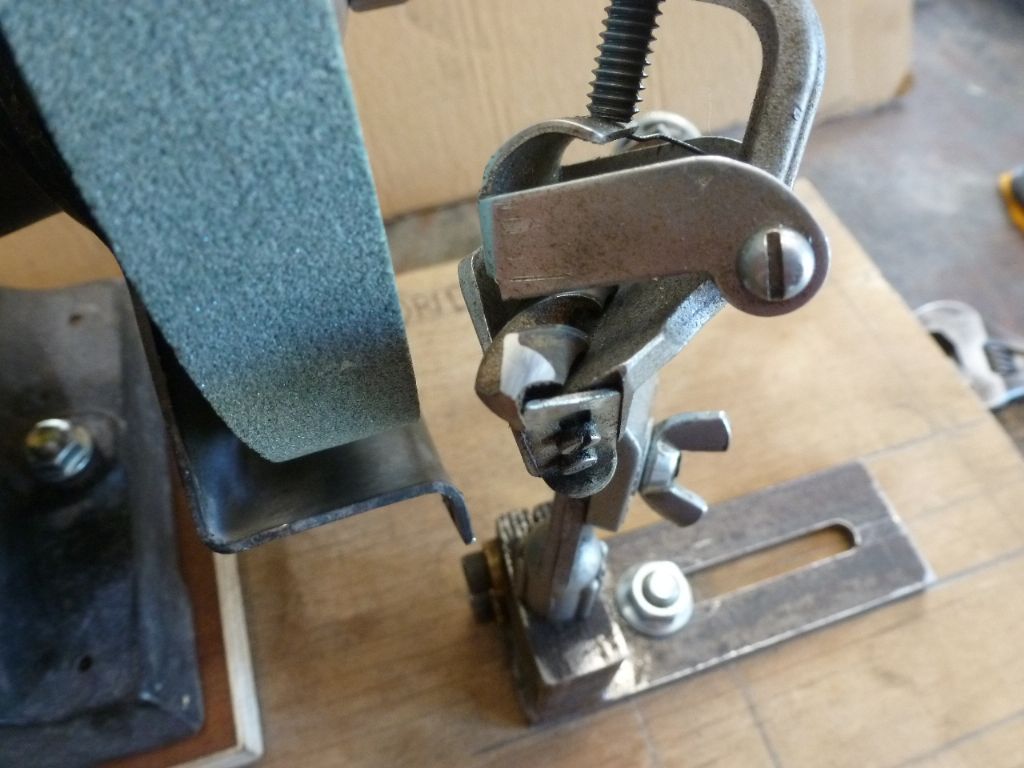

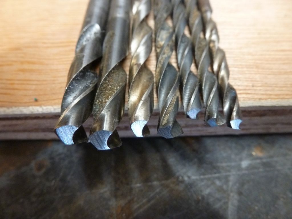

      For anyone interested in setting up a Picador drill sharpening jig correctly…………………..
      Ensure you set the drill bit with the cutting edges at the 5-to-5 position which will in turn ensure that the chisel edge is ground to approximately 45 degrees to the cutting edge.
      I found setting the jig to the 59 degree position which achieved a total 118 degrees point angle gave very good results.
      If you are really lost with the terminology see the photos below which includes a diagram.
      See photos below……………………………

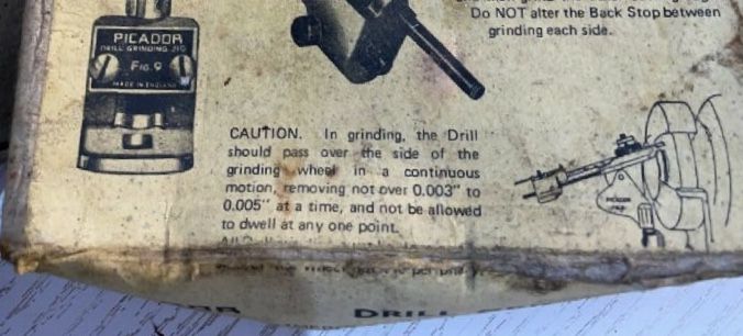

          And Ps: I was taught "Never grind on the side of a grinding wheel" Where did that go out of the window ??
          #600142
            Posted by Speedy Builder5 on 01/06/2022 06:08:16:
            It is covered surprisingly well by the CAUTION on the box
            Edited By Michael Gilligan on 01/06/2022 06:46:16

              Language is used in a context. The truth of a statement has to be assessed within the context in which it is made.
              If we want to modify what you have been taught, we could say 'never FREEHAND grind on the side of a grinding wheel'.
              There is a huge difference between you pressing a rusty bit of iron into the side of a wheel and the delicate, controlled movement and depth of cut the jig produces. One is freehand grinding where the advice is good and correct. The other is tool/cutter grinding where it has less validity.
              If I mention cup and saucer wheels, can we have a discussion of what constitutes the side or face of these?

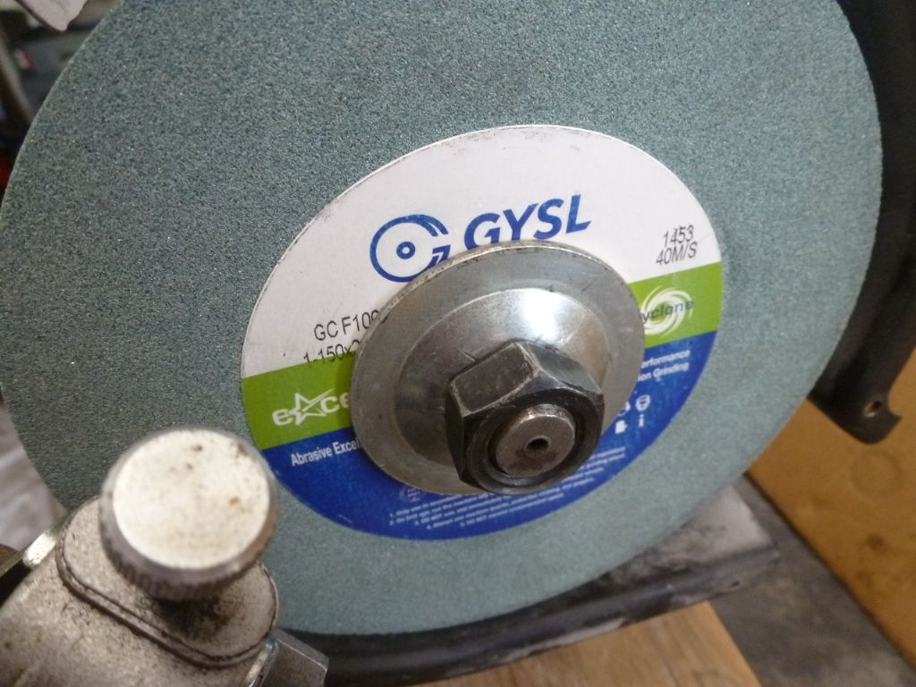

                    @Michael Gilligan – Mike you are right. Normally you don't use the side of the wheel to grind but Picador advise you do it with caution.
                    Note, I am using a 20mm thick wheel for this reason. I also recommend you consider reinforcing the wheel on its opposite face with a metal or plywood disc.

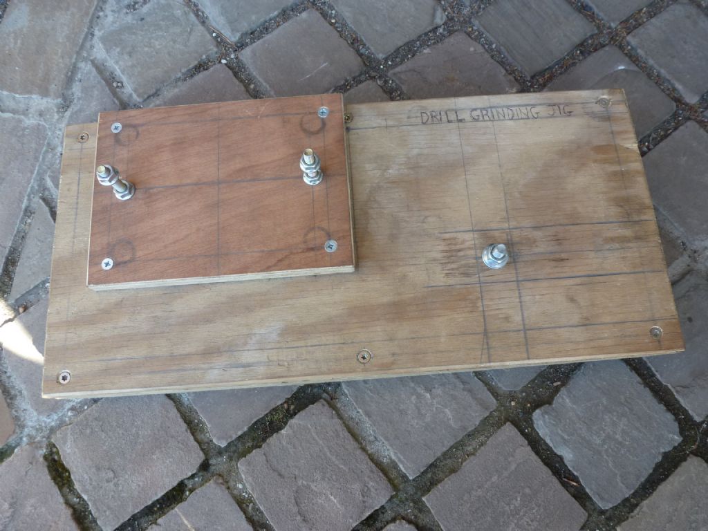

                      John ATTLEE – John, I have uploaded a photo of the base for you which I used to mount the grinder and Picador jig…..
                      Note the additional plywood base to raise the level of the grinder so that the drill tip is approximately at the grinding wheel centreline……

                          Mike Poole – Mike I wanted to reassure you that if you use a 20mm wheel then you can grind on the side of the wheel with caution and taking small cuts as recommended in the Picador instructions. Perhaps reinforce the opposite side of the wheel with a metal or plywood disc as I suggested above.
                          When grinding like this wear full safety goggles and stand to the side of the grinder to mitigate risks further.
