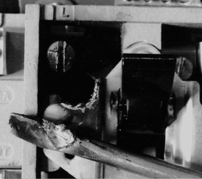

                Georgineer
                  @georgineer
                  Like this, Michael? That one took out the company's 100 amp fuse and spoiled my favourite screwdriver. Embarrassing it was, but no harm done except the bright green glow in the middle of each eyeball which took an hour to disappear.
                  Father taught me that with dry shoes on a dry floor and dry fingers (and your other hand in your pocket) it is quite safe to touch a live wire. If it is live, you feel a very mild tingle. It's never done me any harm – yet! Obviously if you touch the other wire at the same time, all bets are off!
                  There is of course the neon mains tester as an alternative, which can even detect mains voltage through a single layer of insulation if applied with a dab of 'monkey juice'.
                  I came across an American book of about the 1940s which recommends testing for mains voltage by putting the wires to your tongue, though it admits that some sensitive souls might find it a bit much. Of course, their mains voltage is lower than ours.
                  George
