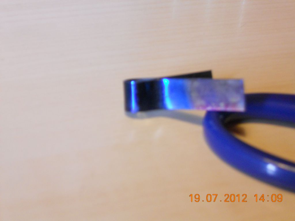

                                    Terryd
                                      @terryd72465
                                      Hi,
                                      my domestic electric oven reaches just over 300ºC (purple on the tempering scale). I made a calibration chart using a reasonably accurate oven thermometer and ran a series of tests to check colours on steel samples. I can now accurately temper hardened components without any dangerous chemistry and I can soak in the heat for as long as is needed.
                                      The main drawback is that I have to wait until my wife is out wink 2.

                                              #94799
                                              ANDY CAWLEY
                                                @andycawley24921
                                                Oh dearie me David, now we are getting really confused. I was referring to your post of 19/07/2012 11:05:47'
                                                .Never mind, this is not confusing:-
                                                Done in the oven, no dangerous molten stuff, wife out at art appreciation, no damage, Austin 7 door now stays closed.face 1
                                                Thank's Terry for injecting common sense into my technorambling!
