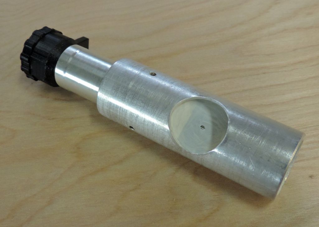

      A long while ago Clive generously sent me a couple of little laser modules that were not as 'tight in the beam' as needed for their original purpose.
      The spot is about 2mm at 2m which is fine for what I needed and I made this laser collimator some time ago:
      I finished a bit more neatly, and I have recently upgraded it with a 3D printed housing for a 2032 lithium cell which runs the laser fine. The black bit at left has a screw on cap for changing the cell and the lower part of it was printed so a suitable switch and brass battery contacts could clip/glue in.

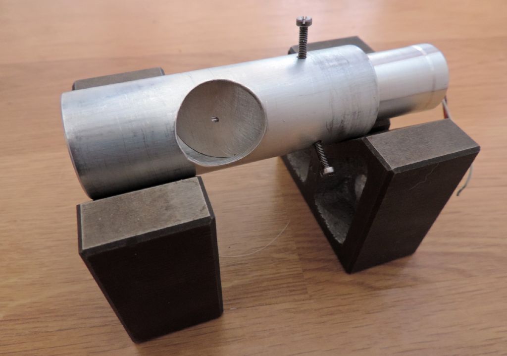

      The laser is mounted in a block mounted using an 0-ring and three set screws. The device is calibrated by rotating in in a v-block and adjusting the screws until the dot remains stationary on a suitably distant wall.
      The telescope is set so the secondary mirror is eyeballed to be aligned with the eyepiece mount and main mirror (effectively the secondary fills the whole view and shows the whole of the main mirror, a simple cap with a central hole to replace an eyepiece makes this easy). The laser is fitted in the eyepiece holder and the secondary adjusted until the laser spot is in the dead centre of the main mirror. the main mirror is then adjusted so the reflected spot essentially goes back down the barrel of the laser! The centre lines of the eyepiece and both mirrors are then aligned.
      Thanks Clive!
