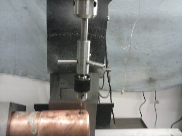

                                      pgk pgk
                                        @pgkpgk17461
                                        This novice will always use a machine tap if i have one of right size. And this simple tool makes life so much easier on mill and lathe using a cheapo chinese keyed chuck for a fiver when hand tapping. Yes it slides on the bar.
