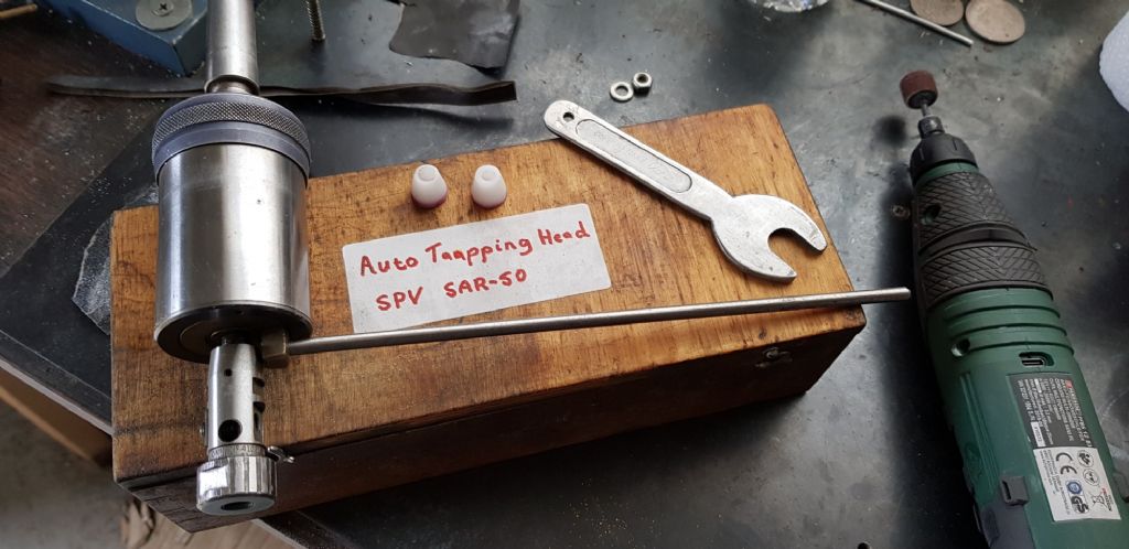

                Hi William. I managed to get myself a SPV , which i believe was an expensive item. Picked up 2nd hand at auction for £30. Had to make some collets for different taps ,. Not sure of the cheaper versions but this one has a full adjustable torque setup. I have not seen the cheaper ones in operation but have seen the better ones being demonstrated on youtube. Tapmatic etc. Pic of mine below. Hope you find the right one.
                Steve.
