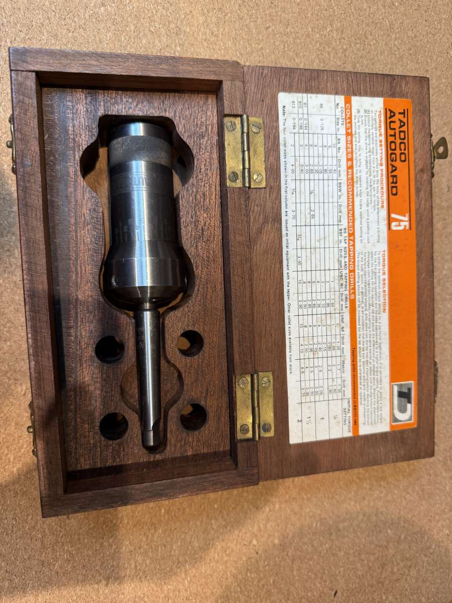

      Evening all
      Anyone have any information on this?
      I know it’s some sort of tapping head but what’s missing ?, some sort of collets i guess..
      IMG_8716
      #824186
      Dave Halford
        @davehalford22513
        Should auto reverse when you let go of the knurled section and slip before the tap breaks. Hopefully there’s a collet still fitted.
        I’ve found different tap makers use different tap shanks
        #824201
        Clive Foster
          @clivefoster55965
          Looking at on-line pictures the “collets” look more like tap carriers than true “collapse to grip” collets.
          I have a small clutchless tapping attachment of unknown breed that uses this system. The holders have a socket grub screw ti grip and drive the taps. Taps have to have a flat ground on them for the grab screw to grip. The square isn’t used. Drive is via a dog clutch arrangement with a spring pulling the head proper back to engage the clutch. Follow the self feed with the mill or drill quill, when you stop feeding the tap goes about 1/8″ deeper before teh dog clutch releases. Came run a box with some other stuff including some modified taps. Gets occasional use when what I have suits a job too small for my Pollard heads.
          If you have nothing better the system could probably be used on that Tadco head. Several pictures show a lot of collets in the spacers provided in the box. Many more than collapse to grip collects would need over that range.
