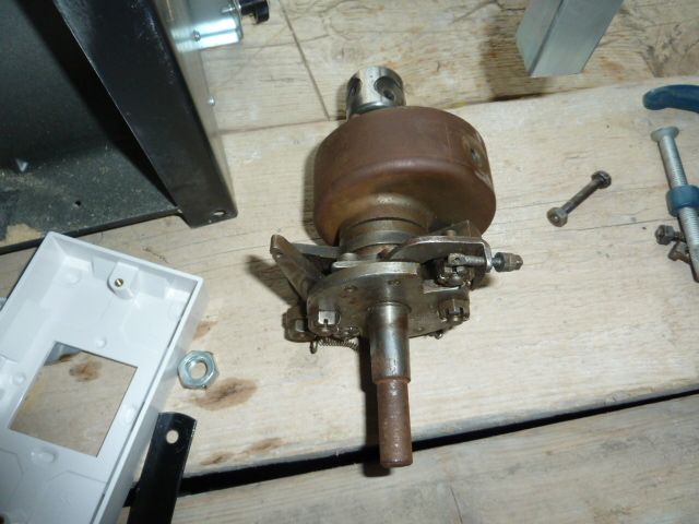

      Hi Gentleme's
      Has anyone heard of the above Company. I have received a tatty tapping head for a fiver which seems to work but has lost its outer cover. I cant quite figure the auto mechanism, some springs missing?p1010024.jpg
