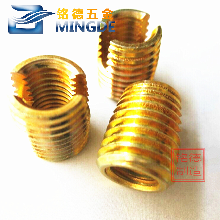

                                          John McNamara
                                            @johnmcnamara74883
                                            Hi Iain
                                            For screw that is going to get a lot of use Cast iron is not the ideal material, it wears away quickly. particularly with a fine thread. I would be inclined to take a different approach and make an insert.
                                            Starting with an M10 or M12 machine screw (or Whitworth thread, if that is all you have to hand) Just axially drill and tap the machine screw for your M6 fine thread, then drill and tap the cast iron to match your chosen bolt.
                                            A high tensile steel bolt would be even better as long as you have a good quality tap to make the M6 fine thread.
                                            The insert can be epoxied or Loctited in place.
                                            You have the option of leaving the rather large hex head or cutting it off leaving a sleeve like the one below, This one has screw slots, although they are not necessary, just use a bolt and nut set the sleeve in place.
                                            The image below was found at a site in China, however making one is trivial and much more satisfying. I would use steel in preference to brass. It will last for a long time.
                                            Regards
                                            **LINK**

                                              Iain Downs
                                                @iaindowns78295
                                                Wow!
                                                Lots of good stuff there. M6x1 tap from the cheap set has long been replaced (probably with another cheap one), though I suspect it isn't up to cast iron any more.
                                                I'll go and have a measure, but I suspect anything much above M6 is going to be too big for the casting.
                                                I'll have a bit of a think, but my gut feel is to use m6. I will either stick to 1mm pitch or use 1mm for the casting and 0.5 for the end which adjusts.
                                                The end in the casting is just to hold in place and if my tapping fails (confidence boy), I will drill out and superglue…
                                                Now to see if the piggy bank will support HSS taps.
