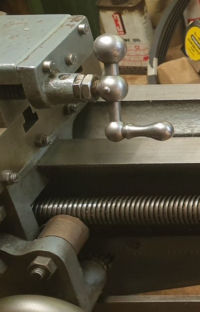

                                            Chris V
                                              @chrisv
                                              Thanks Howard, is that what the pair of locknuts are for on mine?
                                              Cheers
                                              Chris.
                                              #470655
                                              Howard Lewis
                                                @howardlewis46836
                                                Hi Vic,
                                                Looks like it to me! So pinning the handle seems to be the way to go
                                                The nuts will minimise end float of the Leadscrew relative to the Cross or Top Slide body, but can't do anything about backlash between the Leadscrew and the main nut.
                                                Howard

                                                geoff walker 1
                                                  @geoffwalker1
                                                  Hi Chris,
                                                  Looking at your picture below the pin is clearly visible so would be easy enough to remove if necessary.
                                                  The later Myford builds had the pin machined flush with the center ball and after many years it became virtually impossible to locate the ends of the pin making removal a real headache.
                                                  Your Myford built lathe, 1944 is it, clearly has Drummond made parts which would probably be right at that time.
                                                  The handle looks like Drummond made one , a slighty different shape to the later Myford handles, although the handle knob remained the same throughout. The bridge plate is a Drummond, the later Myford plates were countersunk for the three cheese head screws.
