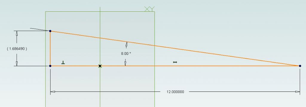

        I’ve a taper to cut with the lathe for an ER 32 collet, 8 degrees is the angle, I’ve never used the taper attachment before but I’ve that bit sorted out so ok there, it’s the angle I’m struggling with, can I convert 8 degrees in to taper per foot, I found some info on the net that gave me a number per inch of 1458 thou, I haven’t the piece of paper with me I wrote it on but think that’s what it was, the taper attachment set tool on center but the tapers wrong, I’m doing something wrong but not sure what , can any one help.
        Regards Alan.
        #408775
          You want 1.68649" per foot to get 8deg
          Or looking at it the other way 0.140541" per inch (1.68649/12)
          Or 1 in 7.11536
          Edited By JasonB on 11/05/2019 13:30:24

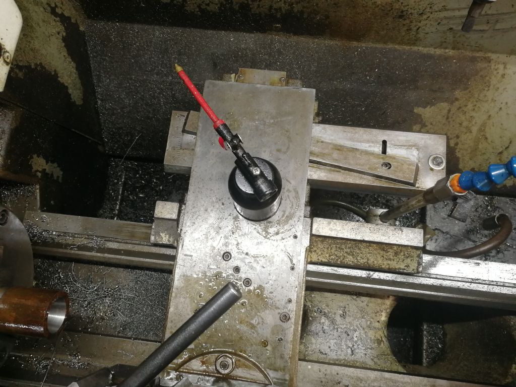

                            If you are running a clock along the face of the topslide (as it says in your post above), are you sure this face is parallel to the lathe axis. If not all bets are off. Never used a taper turning attachment, but how about fastening the DTI to the cross slide running against the taper turning thing and adjusting that to get the 0.1405" per inch
                            #408879
                              Alan, can you post a photo of the setup and what you are setting the taper attachment to.
                              You say is is "far out" so I wonder if your TT may be callibrated in something else, maybe even included angle

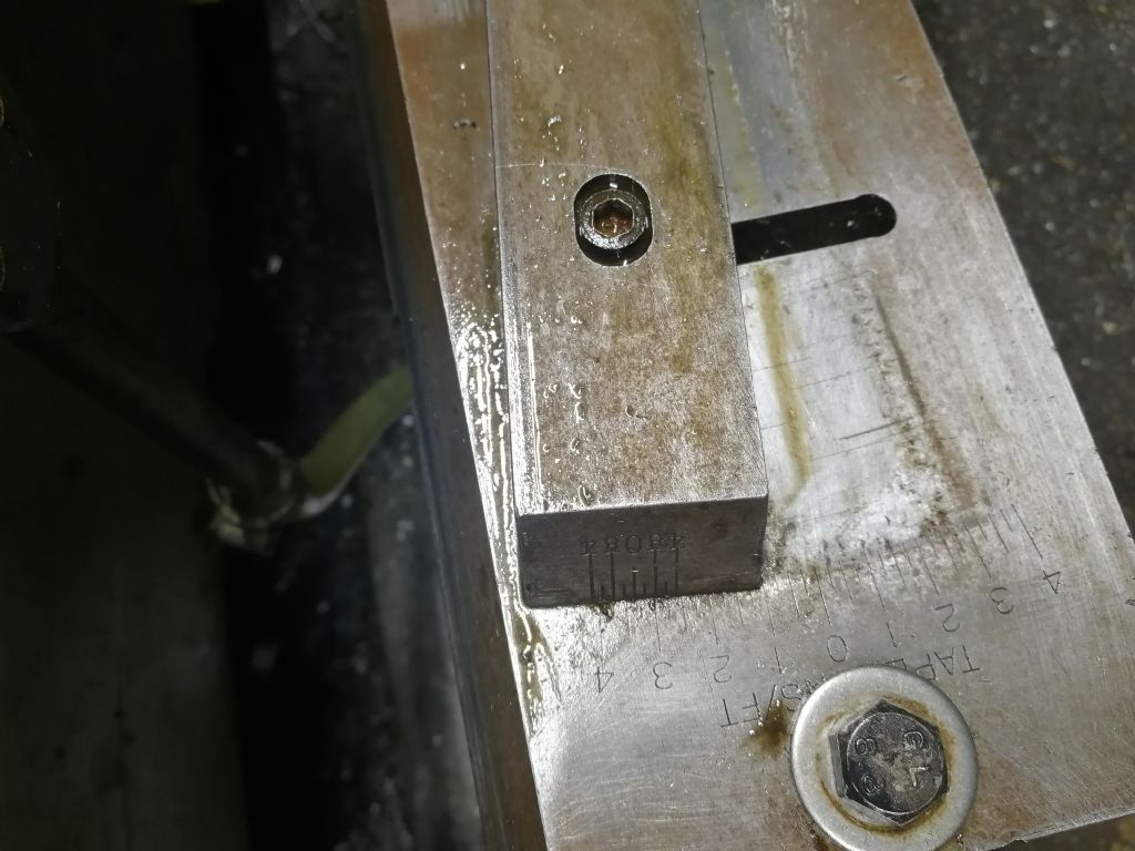

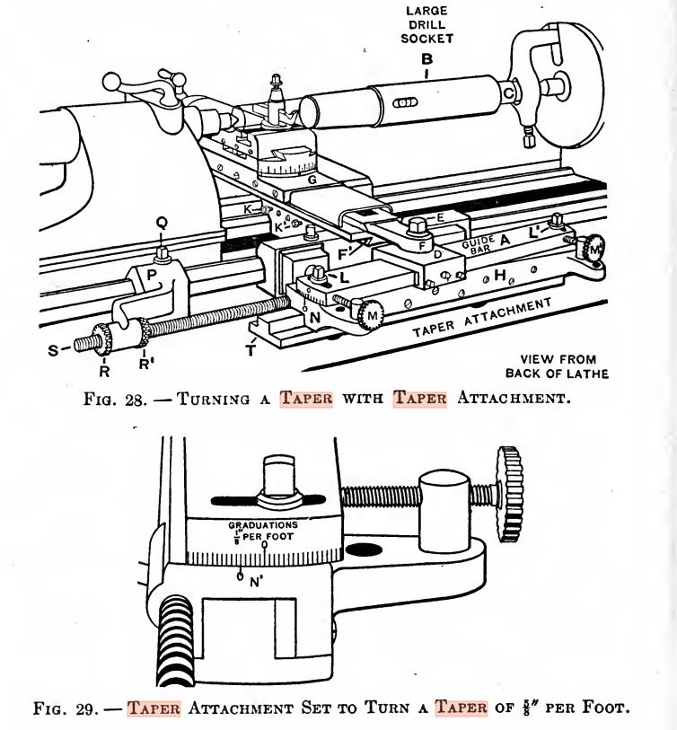

                                Alan's query made me realise I don't know how taper attachments work. There's a picture of one in this book, not quite what I expected:
                                Fig 29 shows the attachment is graduated in ⅛ inch over 1 foot, which is unfriendly!
                                What I was expecting (having glanced at one at an exhibition) was a rod connected between two scales behind the saddle and fixed to the bed such that traversing the saddle moved the cross-slide. Memory very untrustworthy but I think the scales were in degrees, total or included I know not.
                                Conclusion: more than one type of taper attachment, and setting them up could be in degrees or as a length ratio, other than the obvious tangent. Be good to see a photo of Alan's attachment, I'd learn something!

                                  Posted by SillyOldDuffer on 12/05/2019 11:55:31:
                                  You have it right, your description matches the pic you posted. Guide bar A is adjustable to the angle as marked on the end scale. Small saddle D traverses up and down it as the main lathe carriage moves along the main bed. Link F transfers the angular motion to the cross slide, which is free to move because the cross feed screw has been disconnected from the feed nut.
                                  The whole taper unit in your pic is a bit more complex than on say a Myford as it has the ability to be slid up and and down the main bed and clamped in position to turn tapers at different distances from the headstock, but principal remains the same.
                                  It would help to know what kind of lathe is in the OP and pics of teh set up would help. Some use degrees, others taper per foot on the end scale. And some refer to total included angle of the resulting turned taper, others to half that amount, ie the actual angle or offset of the guide bar itself. Varies from make to make.
                                  ONe thing common to all is that the end scale is just a starting point guide, Final setting is almost always arrived at by trial and error cutting and measuring, or setting a known parallel bar between centres and reading off a dial indicator to get desired amount of infeed per inch or number or inches. Final fit can be by using a master taper – eg morse adaptor sleeve etc — and light bearing blue or even lead pencil marks to get a reading how they match up.

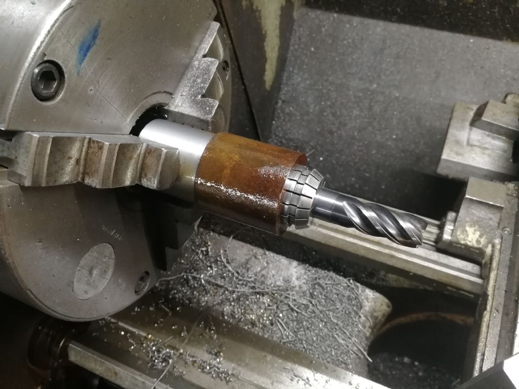

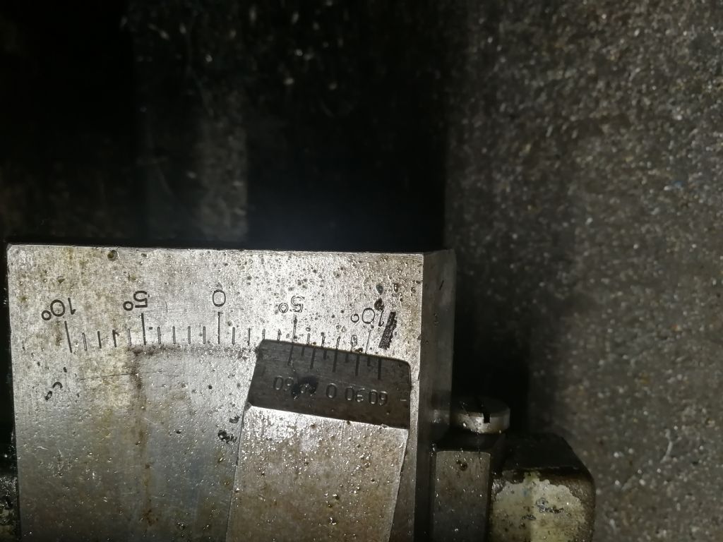

                                      img_20190512_191024.jpgI managed to have another go today so here’s what happened, first I did not alter anything, I did as Andrew suggested and turned a piece of bar to 20 mm then fitted a collet on the bar, set up a DTI and ran it along the collet, using the taper attachment it stayed perfectly at zero, Was not expecting that, turned the chuck 180 and did the same this time with .0015 of runout turned another 180 and zero runout again, I put this down to the collets as there cheap ones, so the set up was fine, so the issue I thought must be when I’m turning so I adjusted the cross slide gib and the top slide, gave everthing a good clean at the same time, cut a new taper and it worked out really well, cut some threads on it fitted the collet and nut inserted a 16mm carbide end mill init and checked the runout, .001 out so happy days, the taper attachment on my Colchester Master 2500 is the type where you just clamp the fixed bar on the lathe bed and away you go, no need to remove the cross slide nut, I’ll include some photos so you can have a look.
                                      Once again chaps thank you very much for your help, ps still hate maths.

                                                I set my topslide to machine my ER25 spindle nose adaptor and got it spot on first time, unfortunately I doubt that I could ever do it again, sometimes you just get luckysmiley
