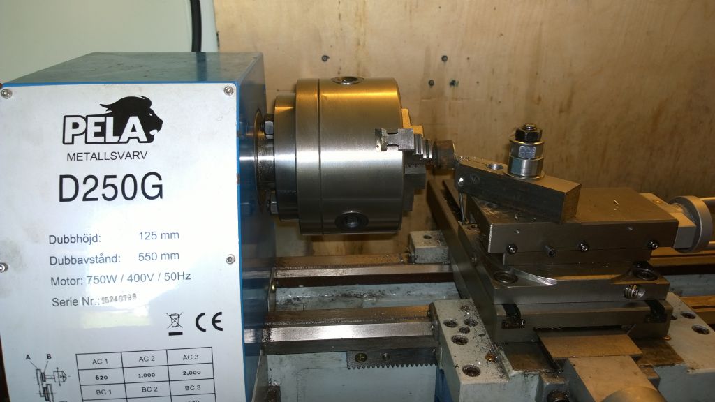

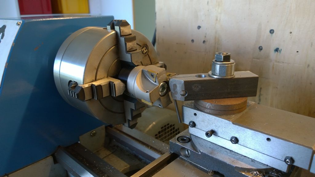

            It has tasted a 12.9 screw and chatters at lower work rate than my 2times 2 square versions.
            The distance from front bearing to work area is far to long.
            Bigger spindle and shorter overhang before making final verdict.

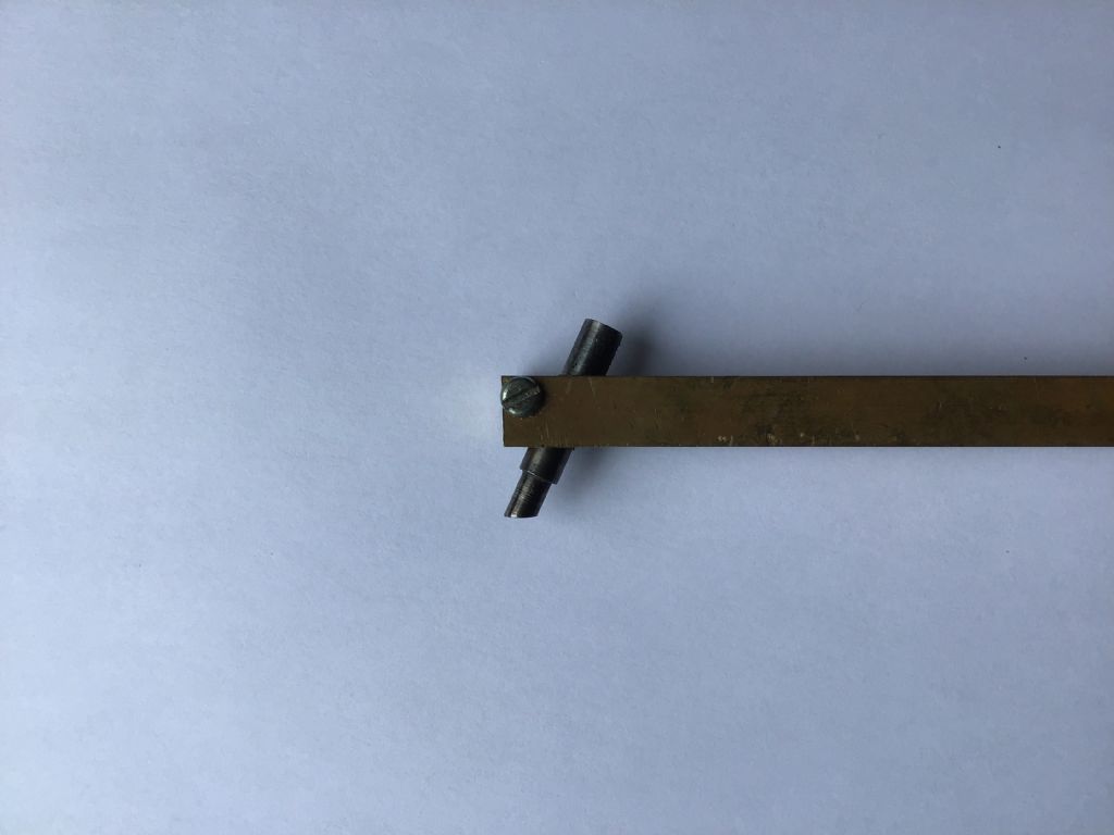

                        This was the “trial” tangential cutter I used. A toolbit of silver steel in a brass tool holder. Angle of toolbit and diameter were chosen to get the desired cutting radius. I used it in an Emco Compact 5.
                        Tangential cutter

                                  The toolbit + holder shown in the picture have the following dimensions (I just measured):
                                  Diameter at top: 4.5mm
                                  Angle from vertical: 26 degrees
                                  These values together define a defined minimum radius of the horizontal ellips at the tip of the toolbit. I have to calculate it again to achieve the required radius I wanted some years ago.
                                  So, by choosing a combination of diameter and angle you make a required tip radius in the horizontal plane. You set the top of the toolbit at center height to cut the required radius
                                  I tried to use this tool to cut a radius in the corners of a disc blank. The first step in making a milling cutter. The problem was that it did not cut so well and I stopt wit it.
                                  A different approach would be to braze a carbide ball with a diameter more than 2x larger than the required radius on the tip of steel toolbit and then grind the ball down to below center to the height with the required radius.

                                      Probably, you are right that the angle I had chosen (26 degrees) was to large. Making it smaller (more vertical) gives an ellips closer to a circle and the tip angle constant for a larger angle along the circumference of the tip.
