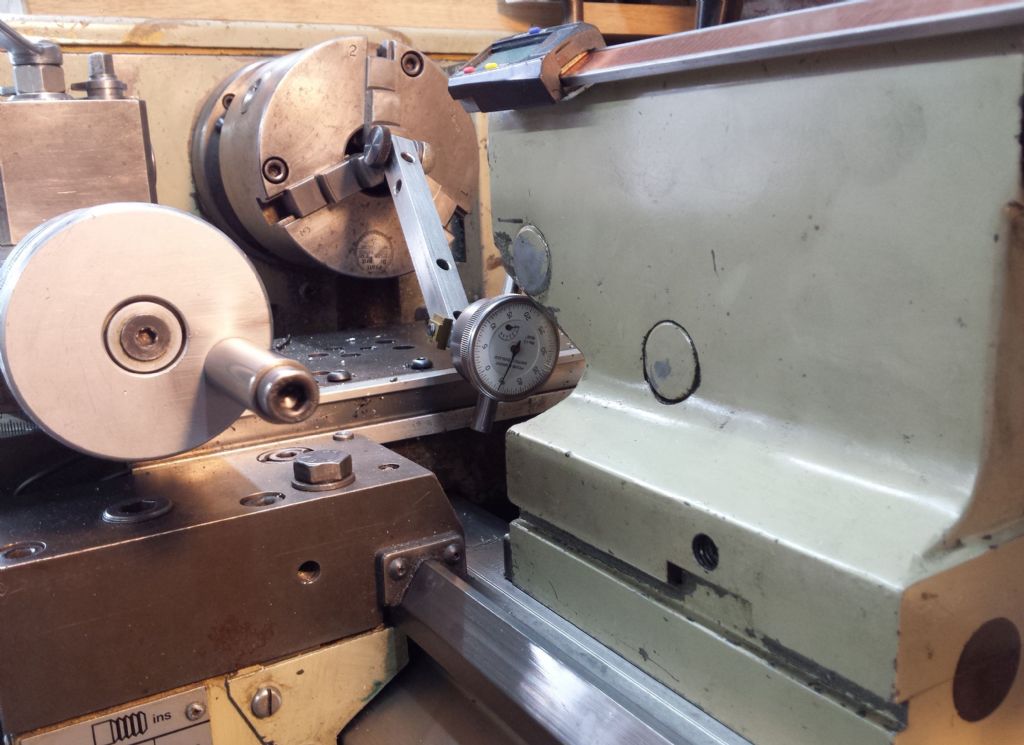

      I was trying to centre and drill some small holes and discovered that the tailstock was out of alignment.
      I removed the tailstock from the bed, dismantled it and checked for burrs, trapped swarf etc before cleaning and assembling. I was able to precisely (within 0.005mm) align the back to front axis but there is no adjustment for height and the barrel is about 0.15mm high.
      I suppose the only option is to remove metal from the base of the tailstock but it does not feel right so I wondered whether anyone else had experienced the same problem or had any other suggestions to improve the alignment?

          Are you taking that measurement when both the tailstock and it's quill are tightened.?

            Ian P
              @ianp
              I bought the lathe secondhand but the dealer had acquired it off a model engineer and I can only assume its the original tailstock.
              I measured the error with a DTI mounted in the chuck and read off the error on the OD of the barrel, with and without the tailstock (and the barrel) locked. Interestingly when the tailstock is clamped to the bed the DTI takes a second or so to stabilise as the oil is squeezed out of the bed mating surfaces (the effect is not present when I did the same test 'dry&#39
              I also saw the same 0.015 error when I had the DTI checking the Morse taper bore so at least I know its concentric.
              The barrel is locked by a cam pushing the key upwards so increases the problem, however when using a centre drill, the quill is free so would not matter.

                Thanks to Graham who has suggested to me (in a PM) that I shim up the headstock rather than remove metal from the tailstock.
                On reflection though I think shimming the headstock might be a lot of work on an M250. Apart from the difficulty of getting shim two thicknesses that work out correct (on the 'V' and the flat of the bed) actually stripping down and installing them would be a major task.
                The tailstock has a separate soleplate so seems a good candidate for surface grinding (not that I have one) although there is a raised (crossways) tenon which separates what would a plain flat surface.

                  When clocking from headstock to tailstock error will be half clock reading,
                  So your tailstock barrel is 0.003" or0.0003"high depending whether clock TIR is 0.15 mm or0.015mm.
                  Also this check does not account. Which way the tailstock is pointing !

                    Could the problem be that the tailstock is actually pointing upwards? Its pivoting on the crossways tenon and needs some shims at its back end?

                      Not forgetting the runout of the DTI being held!
                      Since its a quality machine and unless abused Harrison wouldn't send out with that error, perfectly fine for imports. Steel far superior to Asian imports and wont wear either but the ram will in the casting.
                      There may be adjustment front and back on the bottom, two grub screws. Bigger Harrisons can tilt the tailstock via this a small amount.

                        Are you sure the tailstock and or barrel has not been strained or bent by somebody using it to lift the machine ?
                        Maybe you could remove the barrel and do your DTI test in the bore of the tailstock casting.

                          The difference in reading between the top and bottom of the barrel is 0.015mm so surely I need to lower the tailstock by that amount to correct the error (rather than only half that amount).
                          I did check the barrel at another position after I extended it and did not see much difference. However tomorrow I will check more carefully as a tilted barrel is a possibility.
                          I need to make some Hooke joint shaft couplings to fit a non standard (and non changeable) shaft which is 3.270 diameter (measured with two different high resolution micrometers). I don't want to have reamer made but was hoping to make a D bit or modify a twist drill by trial and error so that I can get a very close fit otherwise the joint will be notchy if not exactly on centre. If when drilling, the drill is not on centre it will bend and I will end up with a bell mouthed hole. One temporary solution might be to mount the drill chuck on a boring head in the tailstock so that I can offset it and correct the error.

                              Many lathes are made with the tailstock slightly higher than the mandrel so that when the tailstock wears it is still within reasonable limits. Even the Schlesinger limits are -0 +.0008" or so for this measurement. And note, this measurement is actual alignment, which is half of Total Indicated Runout. So if you have .003" TIR, that is only .0015" actual shaft offset and probably is just how the manufacturer intended it to be.
                              I would not be too hasty to remove metal from the tailstock or to tinker with the headstock alignment. If you can put a piece of 1" bar about 6" long between centres and turn it parallel within .001" you really have nothing much to worry about. And if it does turn a taper greater than .001", you can adjust that out by offsetting the tailstock sideways without touching the vertical alignment.
                              Those concerned that if we want to drill a .010" diameter hole and the TIR is .003" the drill will be .003" off target and snap etc, should remember that it is only .0015" off centre and no hobbyist tailstock chuck is going to hold a drill to any greater accuracy than that anyhow.
                              Leave well enough alone, I reckon.
                              Edit: PS, just read your correction post. If TIR is .015mm (aka .0006" your misalignment is .0003".
                              And if you are worried about this affecting a 3" diameter drilled hole, just stop it and get turning.
                              If you want those sorts of accuracies you will need a toolroom cylindrical grinder, not a lathe.
                              But in the real world, I would drill undersize and bore to the final diameter. This is the usual way of machining couplings and uni joints of this size. You should be able to bore to .001" to .0005" accuracy if you take small final cuts and allow for spring in the boring bar by taking several cuts at the same setting to get final size.

                                          Chris, not your imagination. I carelessly used confusing and contradictory readings in some posts.
                                          I have just done some more careful checking, this time I used a plunger type DTI which has half thou resolution (0.0005&quot. The results are very consistent and and I have tested with barrel locked and free and with the tailstock locked to the bed each time.
                                          With the plunger reading the OD of the barrel I get 0.000" at the East and West positions. North reads 0.005" positive and South reads minus 0.005".
                                          Out of interest, with the barrel unlocked firm finger pressure gives 0.001" lateral movement whereas the clamp pushes it 0.002". The action of clamping the tailstock to the bed seems to lowers the tailstock by 0.003" very consistently.
                                          Good news is that I get exactly the same N, S, E & W readings with the barrel fully extended, only difference is my finger pressure gives more deflection as the barrel moves further out of the tailstock bore.
                                          For expediency I will solve the current problem by mounting a chuck on a small boring head so I can offset it the right amount.

                                            I think maybe we are talking at cross purposes on TIR vs misalignment. Kind of hard to explain clearly in words so here is a diagram that maybe will clarify it some.
                                            So if you have a Total Indicated Runout on your dial gauge of .015MM it consists of the .007MM at the top plus the .007MM at the bottom. So if you move the solid blue circle (tailstock) downwards by .007MM the tops of the two circles will line up. The bottoms of the two circles will line up. Shafts aligned.
                                            It's like when you set something true in the four jaw chuck. You measure the TIR – the total movement of the needle on the dial gauge in a 360 degree sweep – then rotate the job to the high spot and move the job in by HALF the TIR and the TIR will then be zero. You can try this yourself at home.
                                            Either way, even if the tailstock is .03MM higher than the headstock spindle (aka .001" ) That would be exactly how Harrison made the lathe, in order to allow for wear as is normal practice wiith quality lathes. I would not be messing with it. Your drill chuck is not going to be any more accurate than .03MM concentric.
                                            But at .015MM TIR, aka .007MM misalignment, count yourself fortunate, very fortunate, to have a lathe with such good alignment. In old money that is "two tenths of a thou" or exactly three fifths of five eighths of a gnat's left 'un.
                                            And you could always try drilling a 2.7MM hole in a piece of scrap with your current set up and measure what size it comes out. If you round the sharp outer corners of the cutting edges with a rub or two on the oilstone, you will be surprised how close to size a drill bit will drill.
                                            Or you could make a "toolmaker's reamer' by cutting a piece of silver steel bar of the correct diameter at an oblique angle and hardening and tempering it.

                                                The DTI is mounted a long way off from the centreline of the chuck axis, it has to be in order to orbit the tailstock.

                                                  Sorry I gave some misleading measurement terms but I have redone some tests which you can see a couple of posts previous to this.
                                                  Picture shows the setup

                                                      ??? so the Total Indicated Runout has gone from .015MM to .15MM to now .010 INCHES, which is 0.25MM? That puts a bit of a different light on things.
                                                      Your idea of using a boring head to adjust for the .005" misalignment is probably the best way to go in the short term.
