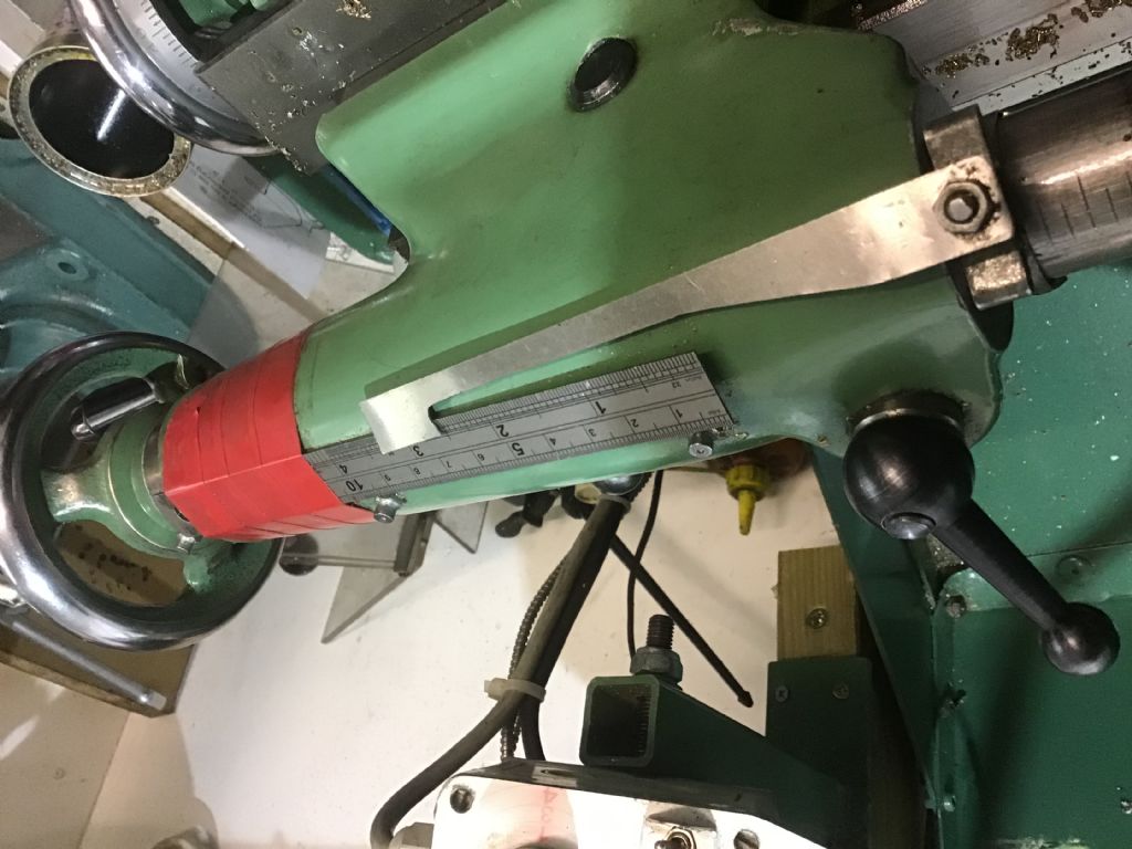

                                    5b4e4a2d-e857-4439-b943-1719fc224ad1.jpegHere’s my dead simple tailstock measuring device.
                                    sorry it’s upside down.
                                    Uses a simple terry clip, a bit of case binding steel strip as it’s springy and a 4 ba bolt with 3 nuts. Just file a notch and a point in the strip. The ruler enables both metric and imperial by just rotating the lot. Normally stored in the lathe tool drawer . I like to think the resolution is as good as I can mark out with a rule and scribing block, so very good!
                                    one day I will machine a placement for a pair of pillars to get rid of the spring in the ruler .  I would love to find a ruler which is graduated from the right or even mount the plastic digital calliper I bought years ago but this solution is so simple and there’s more interesting things to do! The tape gets sticky and needles replacing every 3-4 years…..  in use just move the point to a suitable starting place and work to the depth you need.  So so simple, but nothing like the highly elegant solution Graham Meek will provide us with!
                                    Edited By Zan on 25/11/2019 15:04:53
