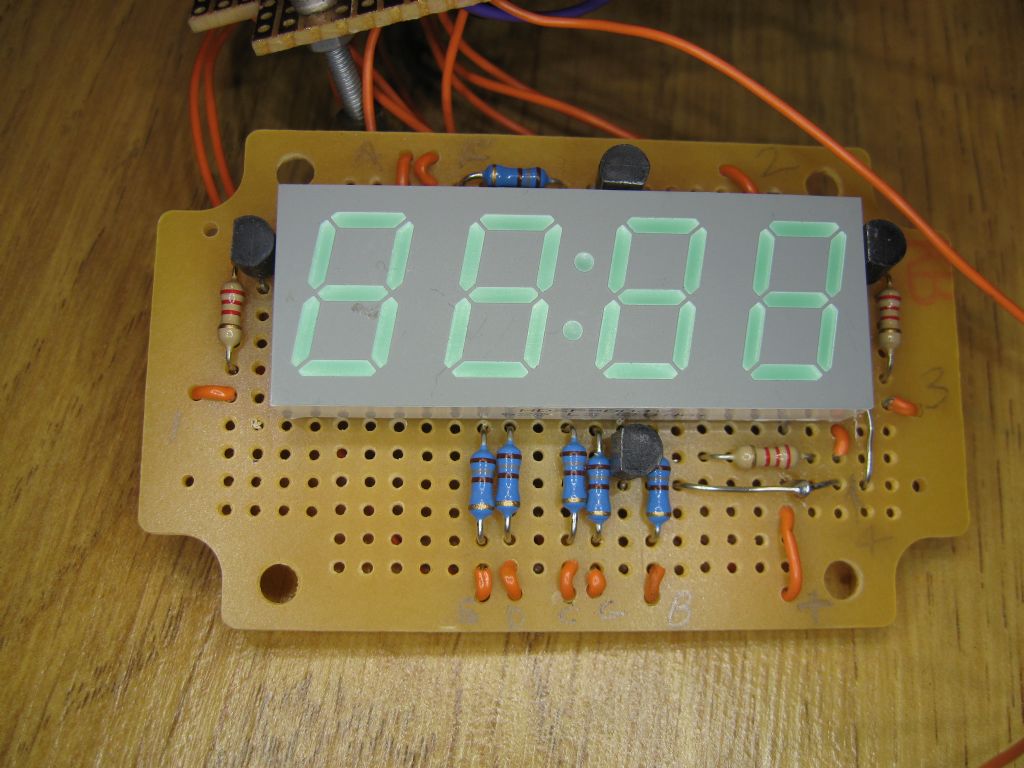

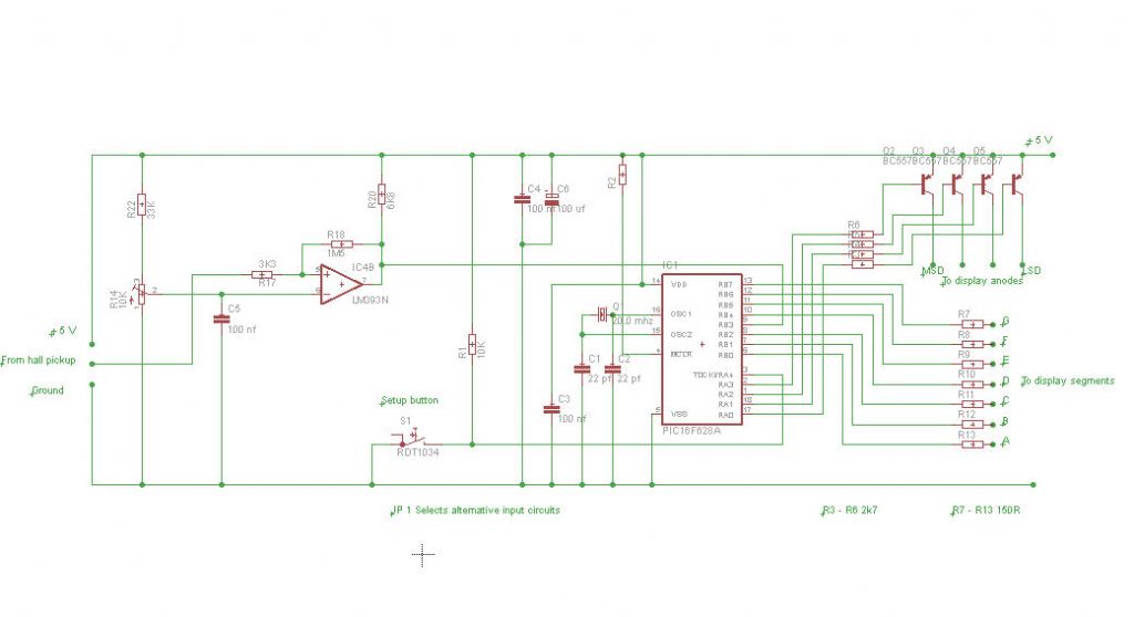

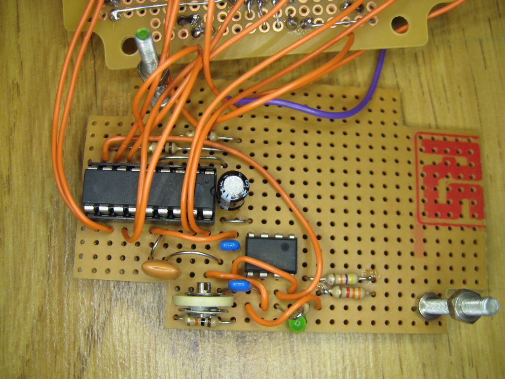

                  Here are some pictures of the original version which is only for one pulse per revolution. The only difference in the hardware for the version that supports different numbers of pulses per rev is the addition of a push button switch. The rest will be done by re writing the firmware.
                  I do not think the schematic is readable but it should give an idea of how simple the circuit is.
                  Les.

                    I can see the schematic just fine – it’s pretty clear. The whole thing looks eminently suitable for a small PCB – doesn’t even need to be double-sided, does it? The obvious advantage of this would be that it reduces the possibility of errors in construction, but still gives the satisfaction of saying that you built it yourself. I’m not actually anti-stripboard, but it’s got to the point now where it’s remarkably cheap to get small boards made up – I would have thought that they’d be about £5-6 each, or thereabouts, although you’d have to make 4 or 5 at a time to get the price to that level.
