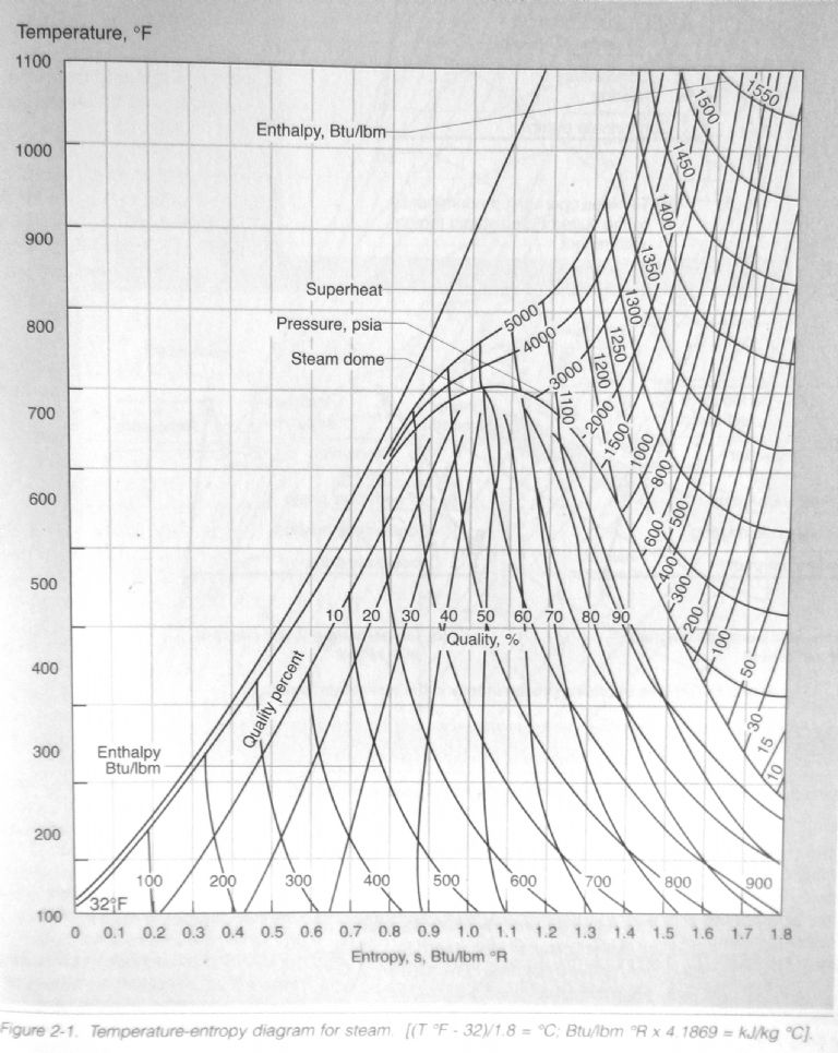

                    There's a graph of steam properties that probably explains all but I can't get my head around concepts like Entropy and Enthalpy. I used to think a steam dome was a shiny brass thing on top of a boiler. Now I know it's also the curve on a graph plotting entropy vs temperature below which steam has moisture in it. The graph appears to say that to produce dry steam, you need either a lot of pressure, or a lot of heat, and that the sweet point starts at 3200psi/720F.
                    I'd be designing a super-Tich except that the graph only goes to 5000psi. Also, the text points out that it's difficult to find materials able to withstand the temperatures and pressures needed to achieve the very highest efficiencies. Coupling that information to my junior bodger skill-levels I don't think anyone need worry about me turning up at IMLEC with any kind of contender, !

                        Posted by SillyOldDuffer on 08/04/2017 19:50:33:
                        Not so, dry steam is represented by the whole of the righthand curve between saturated and superheated steam on the temperature/enthalpy diagram. Dry steam can exist at low pressures, as well as high. Dry steam simply means there is no water vapour present.
                        Subcritical means that bubbles can form in the liquid on the way to forming steam. Supercritical implies that the steam forms directly from water without bubble formation. As discussed the critical point for steam is at 374°C and 3208psig.
                        Andrew

                            Thanks for explaining Andrew; that makes sense. I'll try and put a copy of the graph up tomorrow so others can see what I'm looking at. It's packed with information – if only I understood it.

                                  Here's the Steam graph I've been wittering about:
                                  Now 'Entropy' is defined in the book as being 'the quantity of heat added divided by the absolute temperature at which the addition takes place'. This confuses me, I think because deep down I can't divorce temperature from heat. (I get a similar brain clunk thinking about amperes and coulombs.) I also suffer grief from imperial units like lbm (pounds mass) and Btu (British Thermal Unit), which must not to be confused with BTU (Board of Trade Unit).
                                  Can anyone explain what the graph means for steam production in working terms? Some practical examples rather than maths would be much appreciated.

                                    Don't worry, entropy confuses everybody. All you need to remember is that it stays constant in a reversible process, in a real one it increases. It never decreases.
                                    I'll wait for a thermodynamicist to let loose before I confuse the situation by attempting to describe your graph. A more useful picture in terms of crtiical temperature is
                                    **LINK**
                                    Sorry it's in French. As long as you are above 0.006 atmospheres, moving to the right will change from solid (ice) to liquid (water) to gas (steam). Crossing a solid line needs heat input (latent heat), or if crossing from right to left gives heat out. Above the critical pressure, no line, no latent heat. Below 0.006 atm, ice goes straight to gas, imagine dry ice which is carbon dioxide. This happens in reverse when you get snow and hoar frost formation, water vapour at a low partial pressure freezes directly without going through the liquid phase.

                                            No-one has waded in with info on SoD's graph, so here goes. Of more use is an Entropy-Enthalpy curve, known as a Mollier diagram.
                                            I've only ever used it for designing things like nozzles for turbines, and that was a very long time ago. You could use it for designing reciprocatinfg engines, but there are other ways. Pick a point to suit your steam conditions, say 10 bar, 300C. You can read off the Enthalpy as 3052 kJ/kg (I cheated and used steam tables). Assuming isentropic expansion, draw a vertical line through this point down to the casing pressure, say 0.05 bar, and you will find that the Enthaply has dropped to about 2120 kJ/kg, and the dryness fraction is ~0.85. The loss of Enthaply is 932 kJ/kg, this can be used with appropriate adjustment for nozzle efficiency to work out the steam speed. No I can't remember how to do the efficiency bit, I'd have to look it up. I remember tomes by Kearton and Stodola being useful, but as I said it's a very long time ago. The charts we used were much bigger (covered a desk top), and so could be read to a much higher accuracy. I daresay it's all done by computer nowadays. The red line gives the interface between wet steam and superheated. Note that lines for pressures above critical (220 bar) do not cross the red line
