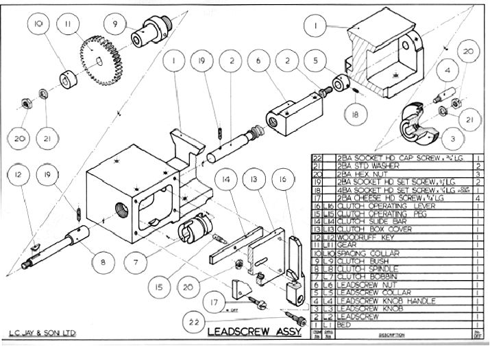

                Here [borrowed from **LINK** ]
                http://www.lathes.co.uk/jason/
                is a simple dog-clutch configuation that could be easily motorised:

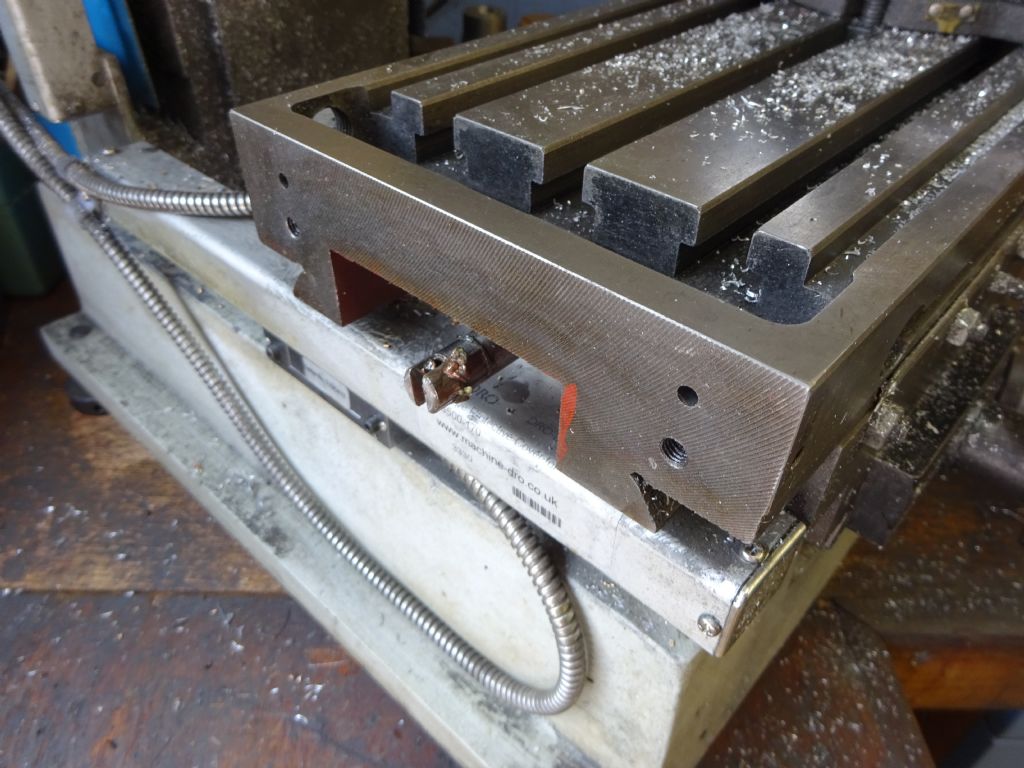

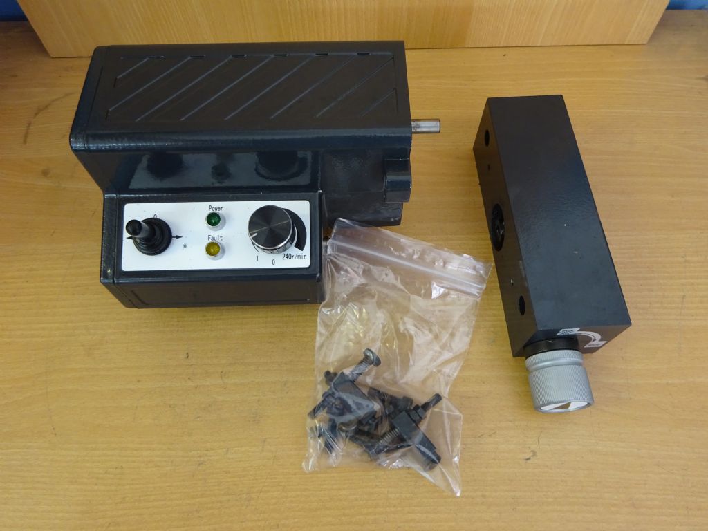

                          As Paul says the latest ones have a clutch unit pictured on the right, different clutch unit depending on machine but same drive unit.
                          This replaces the left hand leadscrew support and the output engages with the slot in the leadscrew

                            I have some photos of my 'Jason' leadscrew dog-clutch, but may not be able to access them for a few days.
                            I will add them to the album when I can.
                            It's a simple and effective mechanism, and you will see that it survives in the Cowells lathes. **LINK**

                                        #263019
                                          Posted by JasonB on 25/10/2016 12:06:51:
                                          Although a dogclutch should work in the slotted leadscxrew end of the X2 and X3 neither my feed or Neil's similar one use the slot as part of the clutch. We have a separate box containing a dog clutch, the output of which engages with the leadscrew and is operated by the simple turn of a knob. Usually needs a slight jiggle of the handwheel to ease the clutch into position as there is no syncromesh.
                                          Mine does! There's a bronze sleeve with a crosspin, and when you turn the clutch knob the shaft slides out and the pin engages with the slot in the leadscrew.
                                          The mechanism is essentially the same as the Jason (lathe) except its the slot and pin are internal not external.

                                            Ketan Swali
                                              @ketanswali79440
                                              Posted by Matthew Reed on 26/10/2016 08:27:18:
                                              Morning all,
                                              I may have missed something here, but who sells this conversion kit in the U.K.?
                                              Matthew
                                              Matthew,
                                              Neil and Jason are working with power feeds which have been offered to us – ARC by SIEG. Based on past experience, ARC has so far kept out of placing power feeds on the market. There are pluses and minuses with the latest offering which Neil and Jason are using. So far they have been using these for between four to six months. As they stand, ARC is reluctant to introduce them. However, a competitor may introduce them, or you might be able to import it from LMS in USA in due course…. should you wish to take the risk!
                                              Traditionally, these power feeds are too fast at the lowest speed. Several passes with lower depths of cuts would be required, depending on material being milled. This would still be okay, provided such a message could be communicated to the user.
                                              More then 50% of users are new to the hobby, new to the idea of milling, with limited understanding. So, probability of 'breaking' a tool, damaging the material, or the power feed unit for such customers is high. This issue has never been addressed by any seller!.
                                              A good percentage of the previous model failed within six months of use. Why? – was it a user related issue as mentioned above, or was it component failure?…. So, before ARC invests in this product for sale, we have asked Neil and Jason – who are experienced users to put the units on their machines, and see if they still work after a years use.
                                              These units are expensive at over £350.00 (inc.vat) and ultimately ARC has to hold the can when it comes to 'issues'. We are unable to get away with availing our responsibilities as would be the case on direct component imports through fleabay for example. Nor could we say that this is a 'Maker Project' to excuse our responsibilities teeth 2
                                              Ketan at ARC

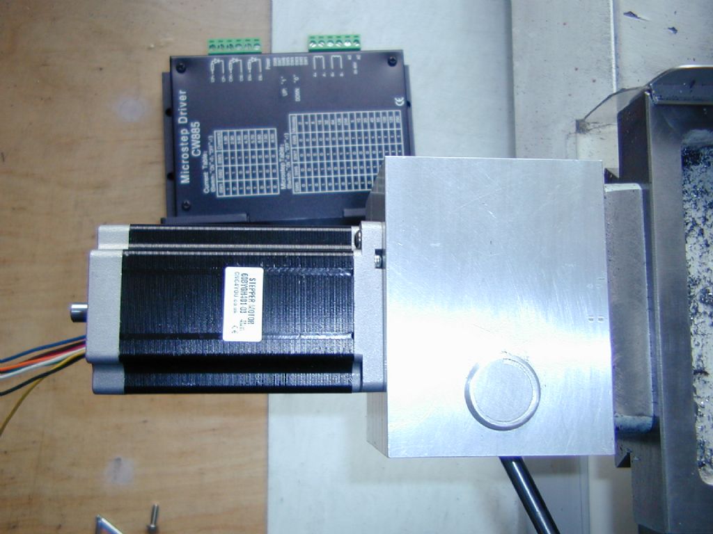

                                                      built my powerfeed from a 12v battery drill motor and an eBay speed control unit. Cost @ £30 in total. I drilled the end of the leadscrew, tapped it and screwed and loctited an extension piece. This has a hole drilled through it which I just push a pin through which engages in a hole in a collar fitted to the drive shaft. Powered from an old laptop psi. Not over engineered but works well and has been reliable.
                                                      **LINK**
