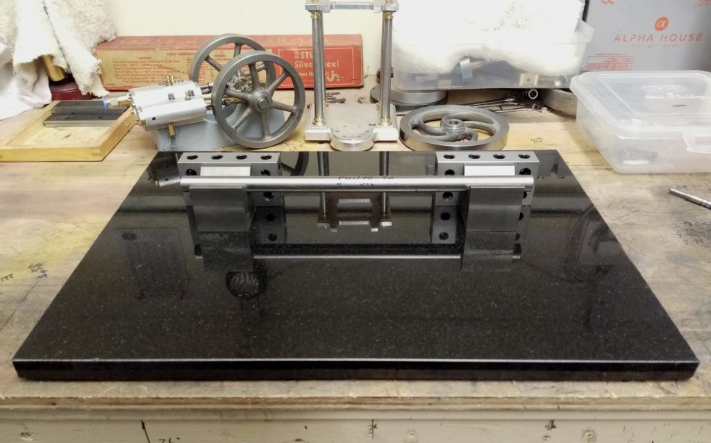

          I splashed out on a granite worktop protector from Dunelm, 400 x 300 x 15mm cost £10 and for a tenner it is easily good enough for what I will be using it for, some occasional marking out and measuring and parts assembly that need a flat surface.
          I havnt got a height gauge at the moment, currently looking for one and will probably go with a digital but I would be ok with a vernier type. Not having a height gauge yet I used the Mitutoyo Digimatic as accurately as I could to check out the plate. I placed a bar of silver steel across a pair of V blocks and measured the height at each end, I then moved the blocks and bar around to numerous positions on the plate checking against the original measurement. I was pleasantly surprised at how good it was, 80% of the plate was within 0.001" a couple of places towards the edges and corners 0.002" and one corner was 0.003".
          I dont know if I have been lucky with a good one or if they are all fairly close.

              Thats not how I saw it Andrew, if I move the two blocks to a different position and one of the blocks climbs or lowers surely that would raise or lower the bar at the opposite end wouldnt it..?

                        ………..if I move the two blocks to a different position and one of the blocks climbs or lowers surely that would raise or lower the bar at the opposite end wouldnt it..?
                        Yes it would, if the two planes on which the V-blocks sit are parallel. One issue is that the movement of the end of the rod compared to the movement of the V-block is reduced by roughly the ratio of the length of the V-block compared to the rod. Which is rather unhelpful.
                        If the two planes on which the V-blocks sit are not parallel (quite likely if the plate isn't flat) then all bets are off, as the movement of one end of the rod will be influenced not only by the vertical movement of the V-block at the other end but also by it's tilt. Without other measurements it would be difficult to determine which effect was the cause of any movement of the rod end.

                          I saw that video a while ago and used the same method to check out my piece of black granite worktop, hoping I could use it for scraping in some parts of a surface grinder.
                          Unfortunately it has dips of about 5 and 10 thou as well as ripples, and drops off at some sides, though it looks OK at first glance.
                          I did try a sheet of 6mm float glass on top to even out the dips, but found that heavy objects just bent the glass.
                          Next try was to make layered shims out of baco foil, but that didn't really work either.
                          I've now kept that for use as a clean surface on the bench and picked up a used 24" square cast iron plate locally.
                          This has a minor bit of rust staining, but for the most part, the original scraping marks are present.
                          Had I not found an affordable plate locally, the next plan was to use a different piece of unpolished quarztite worktop, and add some plaster to the top surface of it; whilst still wet, top it off with the piece of float glass, which would then be substantially supported and pretty flat. The trouble was, that I think the piece of new glass was actually warped by several thou because of the way it had been stored at the window shop prior to delivery.
                          The first job for the proper cast iron one was to scrape in the top surface of the main table, so I can use that as a portable surface plate to scrape in the main column.
                          Never really tried scraping before, and I'm very slow and not exactly good at it, but getting there eventually.

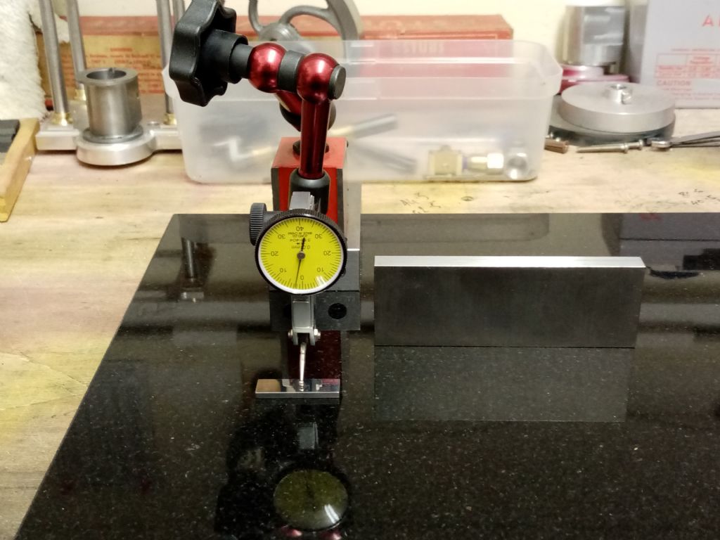

                                  So out of interest I mounted the test indicator on a Stevenson block for stability and took a number of readings around the plate. Wont bore you with the details but basically the plate has a central area approx 10 x 8 inches which is good to 0.025 mm. You can see in the pic the indicator reading with the indicator towards the left of the plate having set zero 10 inches away on the right of the plate. From this central area the plate falls away towards the corners 0.5 mm at two corners with 0.7 and 1.0 at the other two.
                                  I also did a basic test with a 4 inch gauge block and a strong torch looking for any obvious hollows, high spots ripples etc but didnt find any.
                                  So as a surface plate it is not good but as a general purpose plate which has a decent centre section which will cover what I will be using it for its good, very good if you consider it cost £10 from a kitchen shop.
