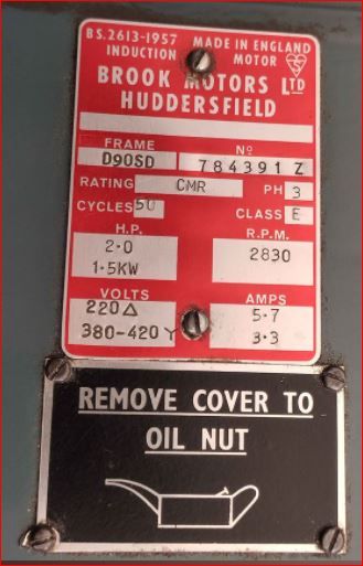

                                  gerry madden
                                    @gerrymadden53711
                                    Many thanks all for your contributions.
                                    The other day I very nearly placed an order for the Warco when I heard that prices were likely to go up in the future due to dramatic rises in shipping costs. But impulsiveness has caught me out before so I hesitated. Am I'm glad I did because a J&S 540 has come up for sale quite close to me so I must at least have a look at it.
                                    This J&S looks 'ligit' and has apparently been in good use until recently when a new and more versatile machine replaced it. Its over 40 years since I last touched and used one of these machines so hoping now that some of you can give me a few pointers on what to look for when I go and see it.
                                    SPINDLE – as a bearing engineer this doesn't worry me too much. I have a vibration analyser so will be able to detect any deterioration here. I have callibrated ears too !
                                    BED WEAR – I will do some simple DI checks but I also will ask the owner to grind a steel strip on both sides so that I can measure the thickness variation. If its more than a couple of microns I might have reservations.
                                    But what about things like the hydraulics – what should I look for here ? And are there any other points I should check apart for general functionality ?
                                    On the nameplate pic I notice it refers to different voltages for star and delta in the motor. Does this mean I can run it directly on 240V just by swopping some wires in the motor connections box ?
                                    Also which 'nut' is it that needs oiling ?!!
                                    Gerry

                                    noel shelley
                                      @noelshelley55608
                                      NO you can not just plug into 1Ph 240v. Star and delta are 3ph connections, IF you want to use it on an inverter(VFD) wire it delta 240v at 50Hz DO NOT try to run it any higher than 50Hz or you run the risk of over speeding the wheel amongst other things. For a transwave converter wire it star 415v. If the machine has a Diret on line starter use it, it will protect the motor. Good Luck. Noel

                                      not done it yet
                                        @notdoneityet
                                        Don’t know anything about these machines, except that I discounted looking at them because of size snd weight, but removing the cover may reveal something under it! Guessing it refers to the motor?
                                        Agree with Noel, it should only be run at 50Hz – because it also runs hydraulics if there is only one motor on the machine. If more than one motor, things may be complicated with VFD use.
                                        I can vary the frequency with the Eagle because it only has a spindle motor so I can alter the speed dependent on the size and grade of the wheel if required (as long as I don’t exceed the safe maximum for the wheel in use). Apparently, running a wheel slower effectively changes its grading. Smaller diameter wheels may be cheaper and need to run faster for the same surface speed. But that is all further down the line for me. Simple surface grinding to achieve a good finish is my main aim.
                                        I would be checking the thickness variation on a workpiece of full table length – it may be pretty well perfect over a short distance while not at the extremities of the table travel. I hope you have easy access – I don’t think I would relish taking one to pieces to move it? The J&S is at least three times the weight of most manual machines of similar size, I believe, but doubtless a good one would run rings around a manual one!
