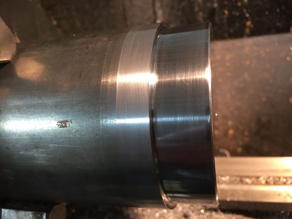

      I'm at my wit's end trying to diagnose the underlying cause of this problem. I was turning some 3.5 inch EN1A today and was unable to get a decent finish, despite trying a number of tools, speeds and feeds. An example:
      On the larger diameter part of the work you can perhaps see something resembling a fine screw thread. An immediate reaction would be that the feed is wrong for the tool tip radius, and it is indeed a fine screw thread. But it's more complicated than that – the 'pitch' of the pattern has no simple relationship to turning speed and feed. In fact certain speed/feed combinations give a sort of cross-hatched pattern, like right and left hand threads intersecting.
      I've spent an afternoon experimenting with various tools – both carbide and HSS, and different speed and feeds, but always see some variation on this theme. Can anyone shed light?
      Ancillary info:
      – The lathe is a single-phase 1.5kW gearhead – fairly rigid, about 600kg.
      – I don't notice the effect on work below ~2.5 inches in diameter.
      – The same thing happens with or without tailstock support.

          What speeds and feeds are you using?

            All the gibs tightened/snugged up, half nuts clean and locking firmly, gear train driving the lead screw clean with no swarf/muck in the gears? Can't think of anything else other than obvious problems like tool chatter/spring, spindle bearings, belts etc.

              Carbide should give a fabulous finish on moderate speed if your headstock is good and your shears are clean
              I've just got a barely used 60KG Drummond M, modded the headstock and picked out the wood shavings
              I don't even need to use the leadscrew, the carriage handwheel does a fabulous job scooting up and down the lathe bed to do a job, its just like using a lever operated cross slide, if there are no vibration errors and microscopic muck you will cruise effortlessly through the work using the saddle handwheel with the leadscrew disengaged
              This new one has been a bit of a revelation after using old clunky for 10 years
              Check the headstock adjustments and thoroughly clean the bed and saddle
              If the saddle and shears are really good you can tighten the shears gib and still use the handwheel to move effortlessly up and down the bed

                Cross hatch pattern suggests some form of fine chatter, looking at how shallow the cut is compared with OD of stock the tool is not really engaging in the cut. If you want to just skim it then get a sharper insert, if wanting to take more off then take a decent depth of cut as it sounds like the lathe can take it.

                      You are effectively cutting a screw thread by moving a cutting tool along rotating work at a constant rate.
                      The finer the feed the finer the pitch of the thread. The radius on the nose of the tool, and a small depth of cut, disguise this.
                      A deep cut with a radius nose tool makes chatter more likely.

                              1. Tool overhang – is it excessive for the shank size?
                              2. Is there a 'ringing' noise coming from the feedshaft gearing – Overtight engagement of the drop gears can cause a high frequency vibration which affects the work finish (especially if taking light cuts)
                              3. Finally, I am never convinced that single phase drive is conducive to getting a good finish in certain circumstances. Usually this occurs (a bad finish) when a combination of factors amplify and create aliasing of the torsional vibration inherent in an AC singe phase drive.

                                I regularly get similar marks on tough materials. By counting the cycles (number of starts and pitch) I inferred that it was due to the rather hummy single phase motor. Different motors improved things a bit, as did rubber motor mounts. I have just ordered an inverter and 3 phase motor.
                                It is no accident that Myfords used to come with resilint mount motors…..

                                  I didn't give numbers for all the speeds/feeds I tried because I didn't document all my experiments – that would have taken me a very long time!
                                  The photo I took was 'posed' just to give an idea of the sort of thing I'm seeing – it was a light skim (perhaps 2 thou) on a 3.5" EN1A bar using a fresh 0.4mm tip radius CCGT insert. Turning speed was 550rpm, feed about 0.05mm per rev – obviously not the sort of thing you'd normally do, but I was trying to understand what was going on, and searching (unsuccessfully) for some sort of pattern to the patterns I was seeing. Reducing the spindle speed to 65rpm (the lowest I can go) , but leaving everything else the same, the cross-hatch pattern appears.
                                  In my opening post I mentioned that it's a single-phase machine because I wondered if that might be relevant. After reading Martin's reply I listened diligently to the machine and felt its various parts while it was spinning under no load. There is a definite hum and I can feel 50Hz-ish vibration just by putting my hand on the tailstock. I'd not noticed the hum before because being a gear-head machine it's quite noisy, and I wasn't listening for it. It's most noticeable at low spindle speeds – something to do with resonant frequencies I suspect.
                                  If this is the cause I guess I have to live with it or stump up for a 3-phase motor/inverter.

                                    Give this a try, round HSS bar held in toolholder square to the work, high – ish speed, slow hand feed. Cutter, grind flat 1/2 dia depth on the end and square to sides. Bottom 1/2 that now projects forward, grind 5° receding angle down, away from just touching the flat edge. Set new sharp edge at 45° to the vertical in toolholder.
                                    Experience has shown mild steel swarf comes off in fine feathery stream and looks like an ultra fine version of the kitchen pan scouring "wire wool"pads. I found the finish on the work just has to be seen to be believed, shiny, smoooooth! Didn't use any lube, just dry turning.

                                      Robin (given that the finish on the already-reduced portion looks okay), the questionable finish on the larger diameter looks very similar to the effect I get if I forgetfully engage the half-nut handle instead of the much-less-obvious fine-feed lever..

                                        You are also only just 'skimming' the cold rolled bar stock. I have seen this effect on 3 phase lathes as well so not sure it's the motor?

                                          I recently had a similar problem, which eventually was the motor having lost a winding or two (but still running).
                                          1.5Kw Single phase cap start / cap run chinese motor.
                                          Once Cap was blown, but replacing it and the motor bearings didn't fix the problem
                                          New motor (I went 3 phase and VFD) and it's much quieter, more grunt at low sped and silky smooth
                                          The motor was loud/grumbly since new, but gradually got a lot worse….

                                                Even a belt with fat join, or a failing belt can produce problems, because of the speed variations that they produce, in addition to any that a single phase induction motor can deliver.
                                                Hopefully all bearings and bushes are in good conditionwith unworn / damaged shafts, and concentyric pulleys.

                                                  There is a definite relationship between feed rate, tool nose radius, and quality of finish. I don't have the formula because one of the apps on my cell phone does the math. I suspect Machinery's Handbook or the European equivalent will show the formula.
