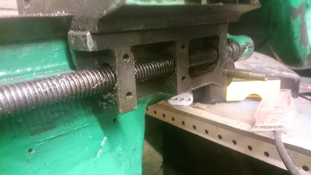

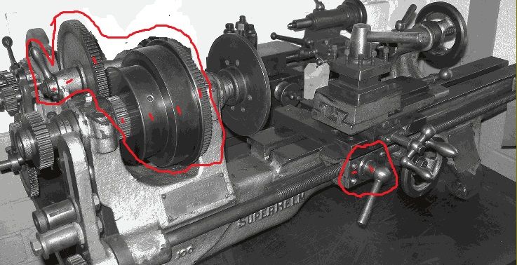

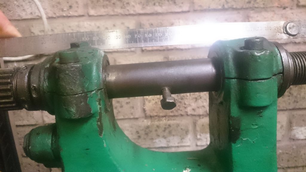

        hi im restoring a old super relm lathe i need some parts, problem is im new to this so not sure exactly what the parts i need are called so going to add some pics of what iv got and how it should look circled in red and hope someone could help thanks in advance nickyj lathe bits.jpgdsc_0301.jpgdsc_0300.jpg

          It looks like you pretty much need the entire headstock gubbins and the apron on the saddle, or even an entire saddle depending on the damage.
          It looks like your unit has been butchered to provide spare parts for another Relm and there's not much left
          Best approach may be to source another relm with all the bits present and correct
          Doing it bit by bit and paying through the nose for rebuilding your unit could be a long and possibly impossible task
          You need the backgear, bullgear, pulleys and all the little widgets and screws which hold it together and make it work at the headstock, and you need the entire saddle apron assembly
          My advice is buy another lathe

                If using the lathe is your main concern, and its affordable for you, a simple route would be to add a VFD (inverter) drive with a 3-phase motor driving one or two poly-vee pulleys on the spindle. Around 0.4 -0.5 kW would be right. This will give you a very usable machine.
                The big challenge will be finding the apron, but making one – but making or getting one made would not be impossible.

                  Perhaps we could answer the question, gubbins and widgets are not parts of lathes that I would recognise as proper names? Help the OP.
                  2 Step main pulley with bull gear to the right hand side.
                  Back gear (for speed reducing) with gears to engage with the bull gear and small driving gear (which is keyed to the spindle) on the left hand side of the 2 step pulley.
                  Leadscrew engagement lever (for screwcutting or traversing saddle) being part of the saddle apron assembly which would include the handwheel (as shown) for moving the cross slide on the saddle.
                  Is that better Nicky?

                          thank you for the responses help and advice, i think iv managed to source myself the main pulleys, back gears, banjo and threading gears so i think all i need to get up and running is the Lead screw engagement lever
