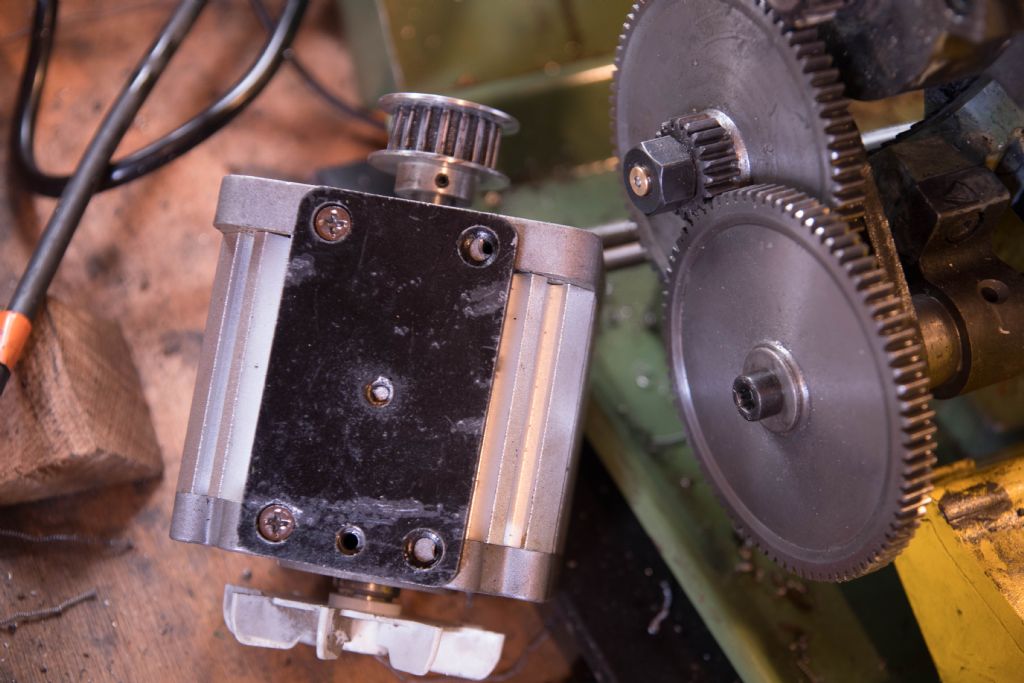

      My super mini lathe belt kept slipping under load (that grating / squealing noise). Adjusting the two mounting bolts would tighten the belt but it would just go slack again after any load was applied. It even made the noise on start-up. I was cross enough to take off the motor and spotted the problem. Two of the mounting screws for the adaptor / base plate were missing (holes would not allow fitting).
      The plate was swinging out enough to strip the threads on the mounting bolts in the threaded holes in the (inadequately thin) plate – so that's useless too, now. It looks as though the motor holes were drilled wrongly in the first place; all a bit of a dog's dinner, really.
      Warco have been very helpful and will send me a replacement motor (I can't wait) but it shows the effect of poor quality control. But we shouldn't grumble because, without those compromises, many of us would not own a lathe at all.
      Fault finding can be enjoyable too!

            Posted by Haggerleases on 14/06/2019 15:10:00:
            Good grief, is that what Warco are peddling?
            Interesting that the replacement motor has an altogether better finish with smaller countersunk heads – showing that the holes were drilled in the right places.
            Can't fault Warco on response time. The new motor was delivered just over 24hours after my email to them.
            I think your term "peddling" is a bit loaded. If we pay peanuts then there will be the occasional monkey situation. These Chinese machines are very cheap and that always carries a risk. Caveat emptor always applies.

              Wasn't it possible/cheaper to make up a new base plate which fitted?.

                           By the way, if you make a note of the number on the belt, you can get a replacement easily.

                                    On a point of detail, I would be interested to hear if anyone else has needed to tension a drive belt on a mini and come across a 'third' bolt, pointing downwards near the motor body. It seems to have not particular function except to help with the tensioning. It's in just the right place and it doesn't seem to be tightened on my mini. I would use it if that's what it's for.
