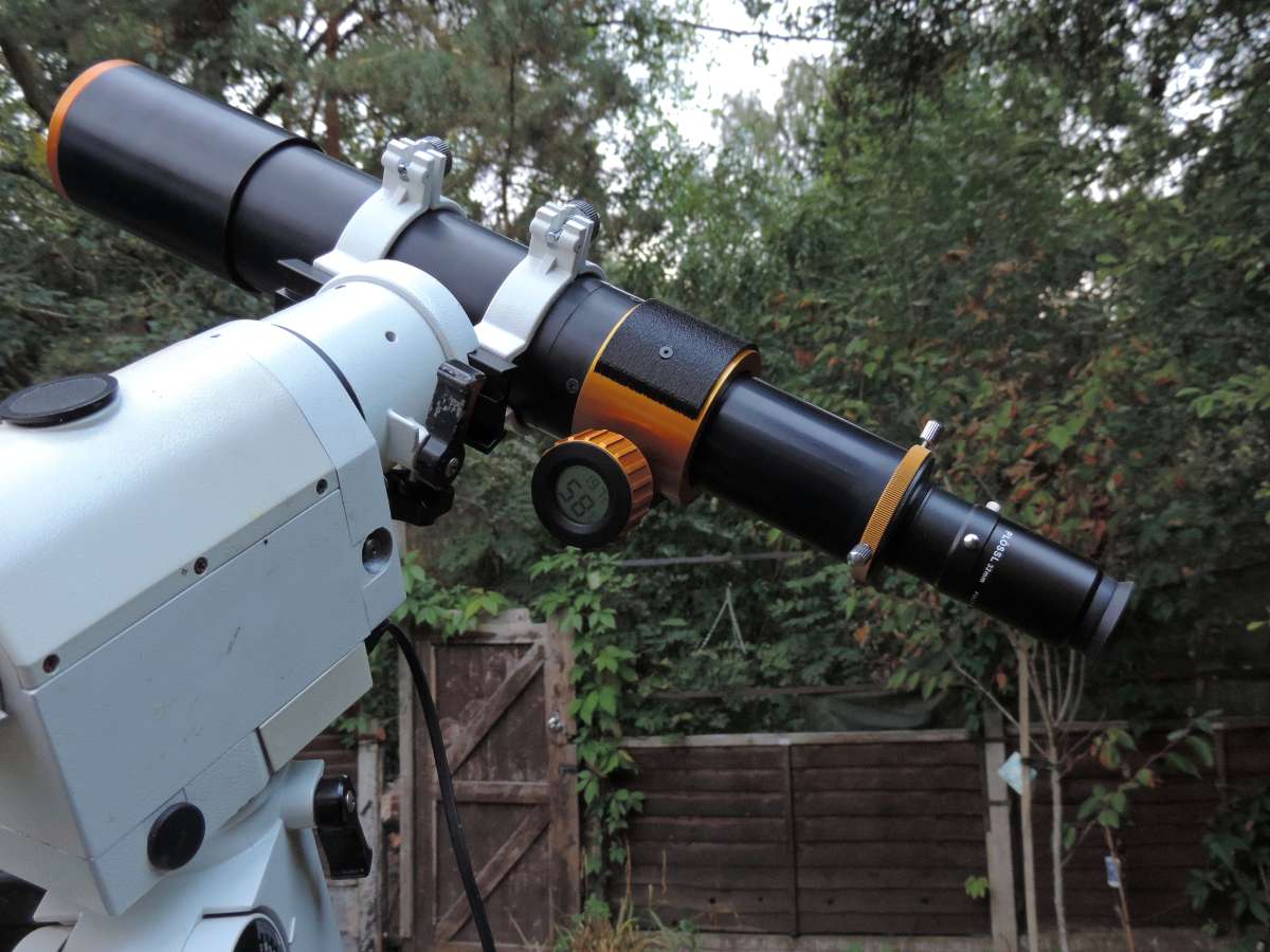

                                I have had great success anodising with sulphuric acid at a concentration comfortably below the 15% limit.
                                Virtually all the black and gold surfaces on this telescope.
                                66ED (5)
