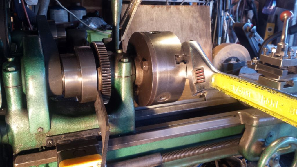

      I am new to screw on chucks as my only lathe until recently has cam lock chucks. I cannot get the 4 jaw chuck off a Hercus 9" lathe, even though I only put it on a week ago, and only then to see how it looked! I have applied as much leverage against the back gears as I dare and I can see no way of locking or spraging the spindle. I have searched this forum, and Google, and there are several ideas, most of which I don't like. I don't want to damage the chuck or break gear teeth, obviously.

              The 3 jaw I took off had been on it for years and it came off easily. The stuck 4 jaw has no backplate. It is a thin bodied, directly threaded type in beautiful condition, probably unused. Yes I'm in Sydney, and thanks HTH, I have just read that post. I'll try the inertia method with a large shifter on a bit of square bar and failing that, I might make an expanding collet to go in the plain bore of the rear of the spindle bore, rather than risk damaging the spindle 3M taper.

                      Well I tried the shock/inertia method, with square bar in the jaws, and a large spanner on the bar, then hit with hammer, in low gear. Nothing. I am getting really worried now. I only screwed it on very recently. It came with the lathe so I don't see how it could be incompatible. It screwed on easily. Who invented screwed chucks anyway! What a stupid idea. I am about to go to bed with this problem swirling around in my dreams, if I can get to sleep that is.
                      Bazyle, if a 3 MT icicle is not as describled by "not done it yet" above, what is it please?

                        Just how much pressure have you put on the chuck while using the back gear to lock the spindle?
                        Have you tried a two-foot-six long piece of wood passed between the open jaws of the chuck and giving it a few good yanks?
                        You have to remember the back gear transmits the power from a half horse motor geared down considerably to deliver torque well in excess of what your arm will provide. (Try grabbing a spinning chuck and stopping it. – er no dont actually try it but imagine it)
                        Using a length of wood provides a bit of spring so is a little easier on the back gear than pounding on steel bars with hammers etc. Works for me.
                        Once off, lube up the chuck threads and the spindle's with Never Seez copper slip etc and you shold not have the problem again, provided chuck is the correct thread etc.

                                                It's off! I did sleep badly, but this morning I read the posts first thing, and tried Hopper's method with a bit of wood, 1-1/2 x 1-1/2 soft wood 3 or 4' long. The wood sprung, taking the load, then the chuck just turned. So thanks Hopper and thanks all for your thoughts and ideas. Never seize will be applied!
                                                I checked the spindle thread once the chuck was off. My 8G Whitworth thread gauge was a perfect fit, although it is 55 degrees. The spindle thread is specified as 1-1/2 x 8 USS (obsolete but usual US 60 degrees, I think). I am, therefore quite confused about this. The chucks are UK made, the 4 jaw is Burnerd cat #1548-16080, if that means anything to anybody.

                                                    Found a UN thread gauge; it fits better than Whitworth, so definitely 60 degrees on spindle nose.

                                                      Hi Simon,
                                                      I have a 9" Southbend lathe and the Hercus was a copy of the Southbend and should be similar to the one which I own. I am always careful not to over tighten the chuck when I screw it on. Only tighten with firm pressure. Do not spin it on at speed or you have trouble getting it off. Too much force on the back gears will break teeth. Luckily I have not had too much trouble.
                                                      The spindle drive gear on my lathe has large lugs at the side for the drive pin. I have not done this but you could place a block between the lug and the lathe bed to stop the spindle turning while undoing the chuck (see photograph).
                                                      A better option, instead of a block of steel would be to make a special spanner that would fit into the slot at the side of the gear to stop it turning. Use a large spanner or steel bar to turn the chuck.
                                                      Paul.
