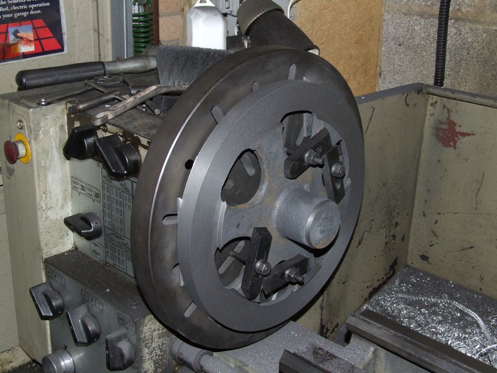

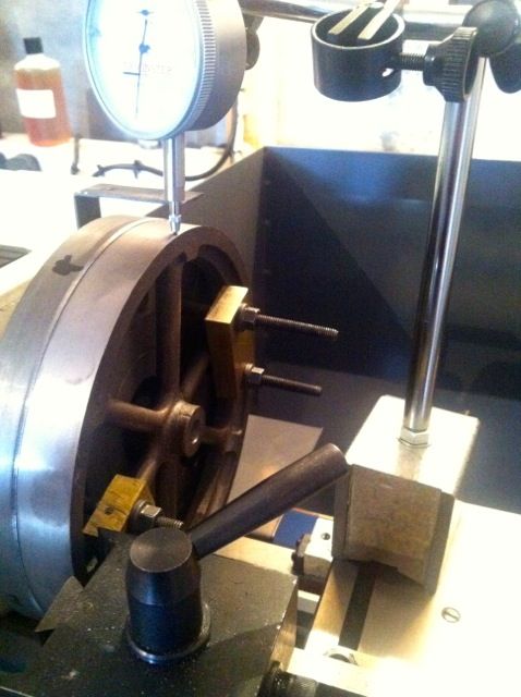

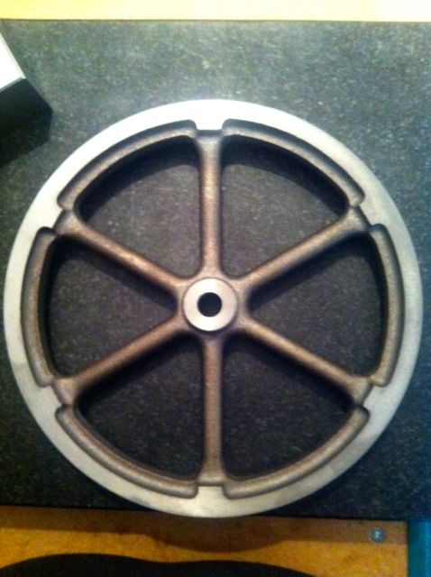

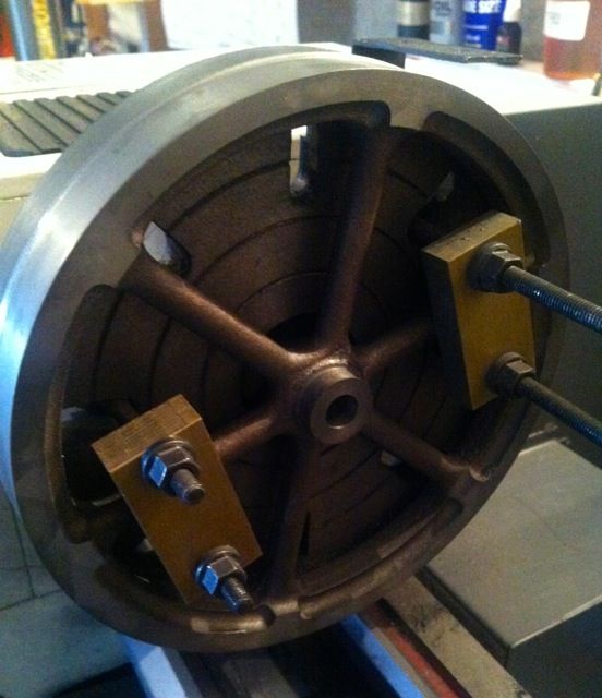

          Day 15.
          The Flywheel (7 inch).
          No problems so far, need to drill and fit the grubscrew next.. It was a bit awkward not having suitable packing and I was a bit worried of overtightening – but I've managed (I've not accumulated much in the way of offcuts etc yet…)…
          The Flywheel faced and bored the 1st side.
          Setting up to do the reverse side.
          The Flywheel, needing to drill and fit the grubscrew next.
          Regards
          Allan.
          Edited By JasonB on 01/01/2015 08:20:08

            Looking good so far. My own preference is to machine those six lugs inside the rim off, never known why Stuarts cast them in but don't worry now.
            If your drill and tap are not long enough then use the drill to make a hole in a bit of say 6mm spare rod and locctite the drill into the hole. When finished a bit of gentle heat will get it out again. Like this
            Also worth looking out some shorter studs for clamping as it will allow you to get in closer with the toolpost so less overhang not to mention a lot safer as they can't be seen when spinning round.
            J

              Thanks Jason, I can see that drilling is going to be awkward – thats a great tip if I get stuck..
              Yes I agree the long studs were a bit dangerous, I can see that I need to get some more bits and pieces for workholding….

                Instead of studs, perhaps use bolts with low profile heads. When clamping things like flywheels to face plates, its best to put packing between the spokes and the face plate, clamping pressure can easily breakthem , they are cast iron, so relitivly brittle. My Stuart S9's flywheel doesn't have those 6 lugs on the inner dia of the flywheel rim, perhaps not 'all' Stuarts have them. Ian S C

                  I don't recall them being on my beam when I made that though it was about 30years ago when I was in my teens. But I used a couple of the same 7" flywheels on a scratch built hit and miss a few years back and that had them, they machine of easily enough as you can see. The No9 has a smaller flywheel so not sure if any of the 5" ones have the lugs
                  Edited By JasonB on 27/08/2013 14:18:30
                  #127991
                  NJH
                    @njh
                    I believe that the "Real" has the same sized flywheel and there were certainly no lugs on that when I machined it ( in around 1980!).
                    N
