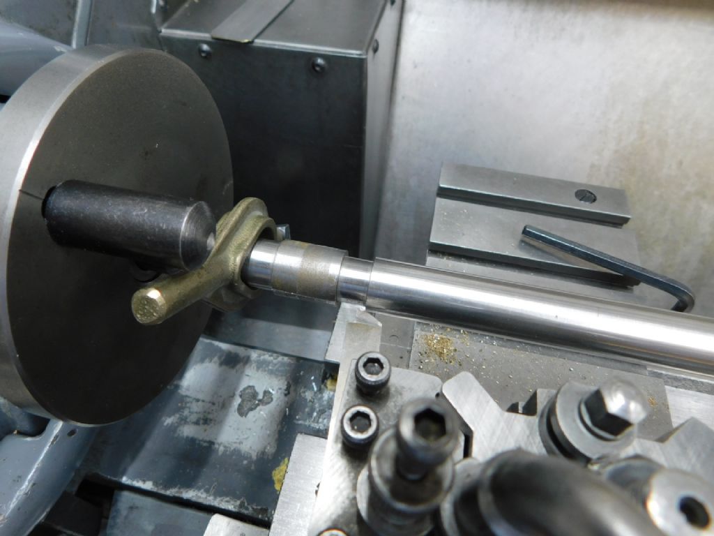

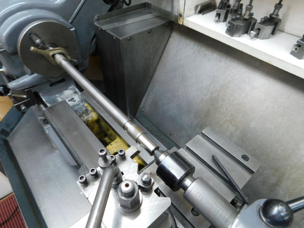

      Just so we are not at crossed purposes I set this up an hour or so ago but was distracted on the F4!
      This shows the test bar I made years ago. Ignore the finish between the measurement areas – that can be as rough as you want. Ignore the rust too – very rare to find anything rusty in the shed but it's been hiding for quite a while.
      Take a shaving cut at this end to true the test area
      Without moving the tool move the saddle to cut the other end at the same setting
      By relieving the area between the test areas this speeds the whole process up

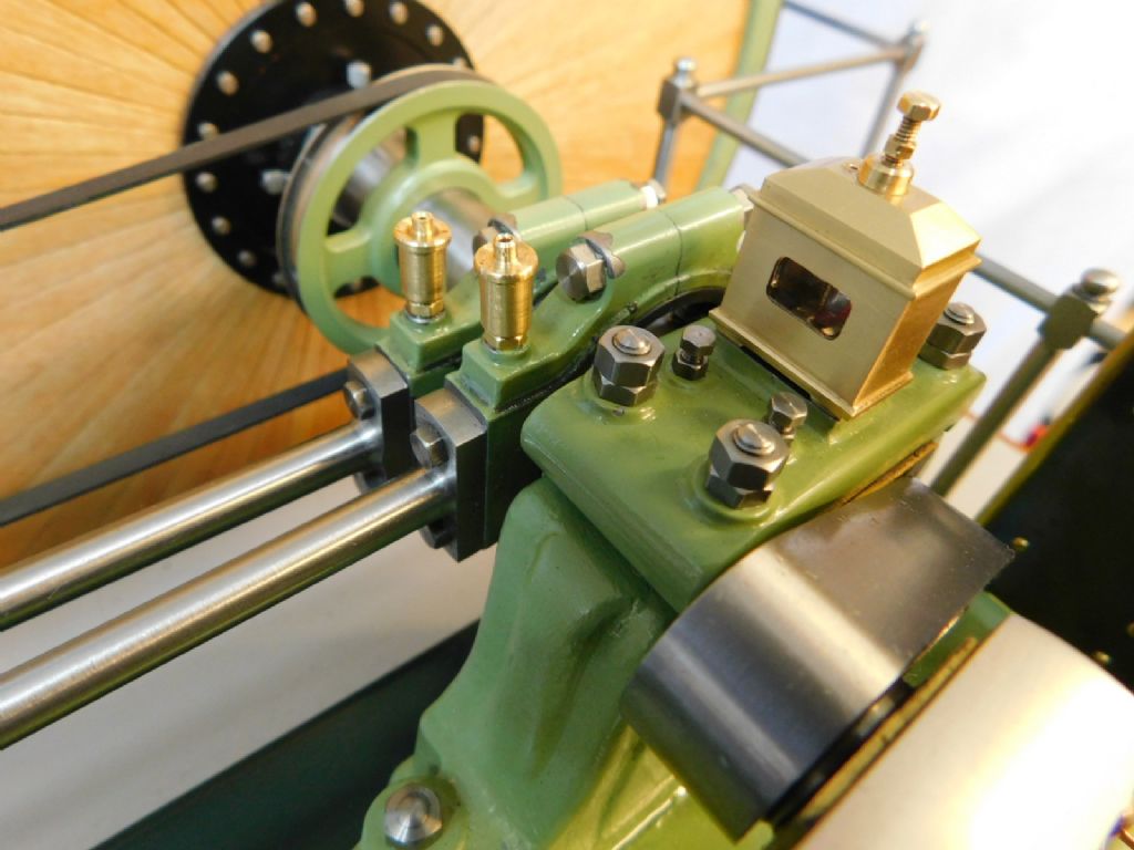

                I've now drawn new ones out on CAD, and done some drawings. I've added some radii features to add a bit of bulk, and tweaked the stud centres to give more room. I think they will look OK:
                Hopefully this will work out. Cheers.
                #607145
                  Look good
                  One small point, the locknuts are usually used on the caps with just a single nut holding the pedestal to the bed. The reason for a nut & locknut on the caps is they may not need to be fully tightened down so you need the locknut to stop them coming undone
                  #607146
                  roy entwistle
                    @royentwistle24699
                    I don't recall seeing washers used on mill or winding engines. At least not as here.
                    #607148
                    Dr_GMJN
                      @dr_gmjn
                      Posted by JasonB on 24/07/2022 13:52:45:
                      Look good
                      Thanks for that Jason. I'll swap them round on CAD and see how they look, but to be honest, now the beds are drilled and tapped, there's virtually nowhere to go with this design (as I've seen from your drawing and now my own CAD). I widened the 1" upper body by 0.52 mm outwards each side, but it's enough to give a bit of visual clearance if nothing else. This combined with the 'proper' 4BA lower nuts , should give just enough clearance to a) work, and b) look right.
                      I had no issue milling the cap outer radius on the R/T with only one bolt clamping it around a tight fitting spigot, so I will try that again.
                      The 3 mm blend radii will be an experiment – the upper ones I'll side mill using the R/T, and the lowers with be side milled in the vice. I'm hoping that since the profiles are fairly narrow, my new cutters will be OK.
                      Anyway if it doesn't work out, I'll just remove those radii and revert to how you suggested. I do think it makes a slight visual improvement though.

                        Posted by roy entwistle on 24/07/2022 14:01:06:
                        If I don't use washers, the steel nuts will probably chew up the aluminium faces.
                        Personal preference, but I like to see washers on engineering assemblies, even if they're not strictly prototypical.

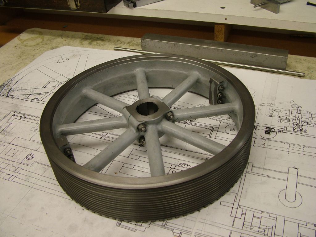

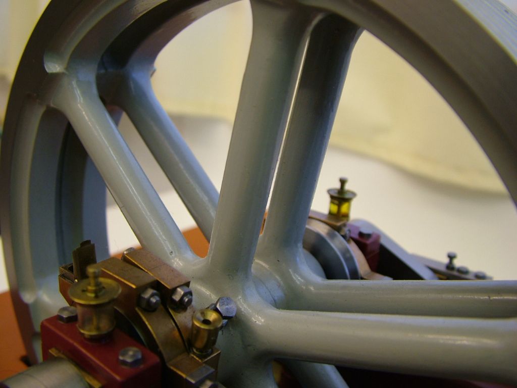

                                    I can't recall how it's shown on the drawing Doc and couldn't remember whether I used a key(s) or not.
                                    Found the answer here in this image!
                                    A compromise at best, if I recall correctly there were three at 120degrees and as with the governor belt something that always irritated and I wished I'd done something better.
                                    On the Corliss I tried to replicate full size practice and use eight slipper keys – four shallow slots at 90 degrees in the flywheel
                                    The shaft has four flats milled on and the flywheel held in place by four keys each side
                                    I confess there is a well disguised grub screw in there holding the wheel from any lateral movement !
                                    That may be of interest to you. The big thing with multiple conventional key ways is ensuring they are all in line with each other – slipper keys give you a small but helpful sideways leeway.
