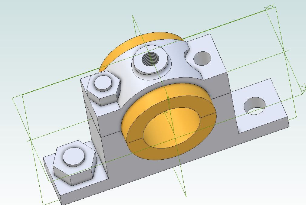

        So checking some sizes, the 5BA bolts I’ve used on the caps have 6BA heads:
        So – somehow, and unintentionally – I have ended up with a size smaller than the plans, but they still don’t ‘work’ visually.
        The cap stud spacings and base stud spacings are as per the plans, yet they call for slotted base holes, which are pointless because there is no room for any adjustment at all with 3BA nuts.
        Unless there’s some odd standard where 5BA nuts are bigger than the bolt heads, then the 5BA nuts would overhang the caps. If they didn’t overhang, the 2BA base nuts wouldn’t turn, since they’d hit the pedestal sides.
        OK it’s been a long hot day, but I’m confused. I might just start again with the cap design and move the stud centres inwards, using 6BA nuts and studs. Might even make the bronze bush OD a bit smaller too; 1mm either way would make all the difference.

          Looks like your bolts are 'one-size-smaller', but your nuts are std. BA – o/s/smaller nuts are available, I know the likes of EKP do them.
          Mr B (and Mr W) have an eye for detail and proportion that it can be hard to emulate – I've been trying to make some caps fpr an IC engine, and trying to get something that looks like I want ti too is SO hard – the drawn ones are unconvincingly 'lumpish', trying refinements to make them them look 'scale' 'elegant' and 'right' is becoming on of the hardest parts of the job..

            Doc have you checked your 3BA nuts are the correct size as they fit on the CAD model, though as I said a 1mm fillet would foul. Not unknown for BA nuts to now be made from the nearest available metric hex as it becomes harder to source the old sizes and 3BA is a non preferred size so more likely yo disappear first.
            The 5BA ones are too tight so you could revisit the counterbore with a larger cutter or use 1 size smaller nuts, I'd go for smaller nuts to save remaking things This is with standard 3BA and 5BA
            This is the one from the recent Real which uses M4 and M3 both one size smaller metric nuts
            Tubal Cain was certainly not averse to using 1 size smaller nuts and particularly given this is a 1/16-1/24th scale model more than likely he did though text suggests the 3BA were standard.

              Yes, I can confirm one size smaller BA nuts are available from EKP plus several others and they are used constantly throughout my builds. On the smaller sizes I sometimes tap the next smaller nuts out too ie 10 BA Nuts with 8BA thread.
              So far have not used any metric.
              In my opinion the standard size nut (and head) and the odd BA sizes as specified by Stuarts are way overscale and require a rethink on all uses – for a more scale effect.
              All the 1BA hold down nuts on the Corliss engine were made from scratch to achieve this so that's another alternative

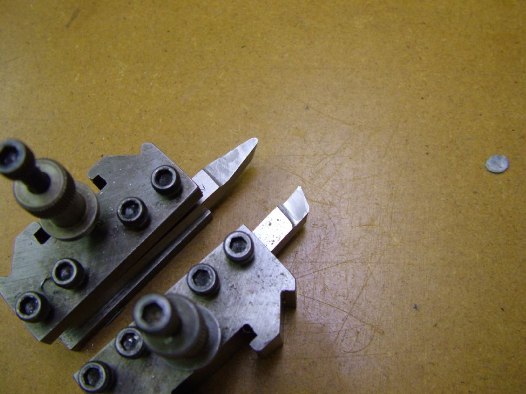

                Cutters
                If we stick with HSS for steel & iron then I've suggested 3-flute cutters many a time as good all rounders, ARC used to be a bit expensive in the smaller sizes but at the moment their prices are good just like the cutters so the Premium 3-flute standard length cutters would be what I suggest from them. Prior to ARC's price reduction then these from APT were a good buy – you need to add VAT to those prices so not such a good buy now.
                For aluminium then the cutters specifically for it work well and also on brass and bronze. I tend to use the carbide ones, all that bearing base and cap were done with a 10mm one of these which has had a lot of use and still going strong. You could also go HSS as the Carbide can be a bit delicate if you are not careful. Another Carbide option would be the 3-flute from APT which I use on the CNC

                  Thanks Both. Before doing anything drastic, I'm going to finish boring the first one, and look at perhaps just making new washers that match the point-to-point nut dimension, rather than exceeding it slightly. I think if the nuts are orientated such that the flats are in the vicinity of the edge, then it might just look ok.
                  Alternatively, might look at tapping a 7BA nut to 5BA as per Jason's diagrams (if it fits).
                  I noticed that my 6BA studding did screw into the blocks fairly well, and didn't feel too dodgy. This sounds like a terrible bodge, but could I JB weld 6BA studs into the block, and use undersized nuts (ie 7BA). That would give much more clearance at the expense of the bodge itself, and the nuts looking a bit small.

                    Posted by DiogenesII on 20/07/2022 06:36:05:
                    Thanks for that – I hadn't appreciated the "one size smaller" thing – never heard of it before, or if someone on here mentioned it – apologies, but it just didn't register what it meant.
                    Bottom line is I measured the 3BA mount nuts as a check, and they are 8.16mm A/F, whereas they should be 7.16 A/F. So, had I sized the lower mount flanks on correct nuts, I wouldn't have had to take as much off, and the cap nuts would also have fitted.
                    So I'm going to re-make the first block from scratch, and then machine both to a 3BA one-size-smaller, ie 4BA. This should then give me ample clearance on everything.
                    I really hope I've understood the above correctly…

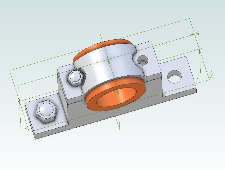

                      Thought I’d carry on a bit with the scrap bearing block, just to get practice machining the bore and cap radius while the new cutters and a selection of BA fasteners arrive.
                      With a coat of paint, which highlights the washers and bolt heads:
                      I’m happy with the form of them, hopefully with the smaller base nuts (on order) I’ll be able to get a radius in there too. The cap bolt spacing definitely needs attention, so I’ll draw it out on CAD, and re-make both bearings from scratch. Put it down to experience!

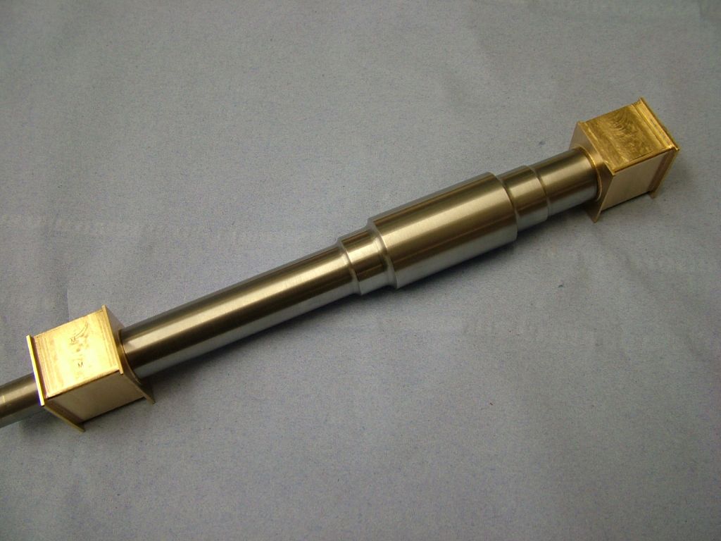

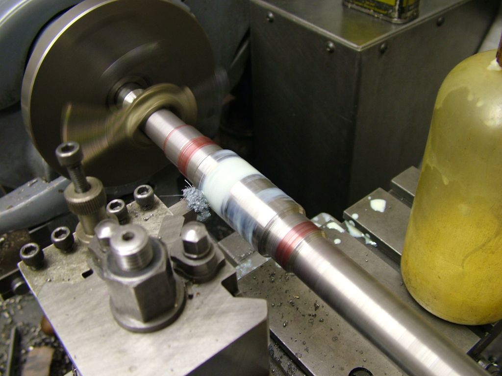

                        Personally I would use HSS to obtain a fine and accurate diameter. Yes it can be done with carbide but you need to scrape that last few thou to a fine surface and maintain diameter. Much easier to do with a freshly ground piece of HSS
                        A round nosed taper tool will cut the radius at any increase in diameters as well as providing the fine control
                        Here's mine in use on the Corliss shaft (note the shaft is pre machined and is set between centres for finish turning – turning the shaft around to finish each end at the tailstock end)

                        Using HSS gives a finish that allows a fine polish with wet and dry paper to bring to an almost ground like appearance without losing dimension to any great amount.
                        Jason as a confirmed carbide devotee will have other ideas but that's what I would do.
                        What material do you intend to use – EN1a free cutting steel is the best option when running on bronze or brass – a very good combination. The last material I would turn too would be silver steel. Not a good choice in my opinion for this specific item.
                        Just another thought – it should go without saying but you need to have your bearings finished (but not slit at this stage) to use as gauges and like wise the flywheel bore – much easier to do than the other way round. By machining between centres you can safely remove the shaft to check the fits  – off the lathe

                            Well each to his own Doc but it should be quick to realise that it is much easier to make the bearings and other bores first – preferably with standard sized holes and then make the shaft to fit – as said, unlike a chuck or even a collett if done between centres it can be removed without fear of movement and the shaft parts are much easier measured than bores – ie you'd need to carefully measure the bores to the correct size to suit the shaft and try the shaft in the part rather than the other way round – apart from the flywheel and unless there's no option it's not the ideal way to go about this task.
                            Just 'polishing' the shaft until the parts slip on is much the easier way.
                            Here's a pic of the tapered tool. It's one that gets probably more use than any other from a finishing aspect – works in either direction and is ideal for turning those unimportant radii by eye such as transition on crankshafts etc
                            You have to bear in mind Doc that my advice comes from a time when this way of work was standard in a jobbing shop – get the job done but accurately and at low cost (ie time) with what you had at your disposal bearing in mind the machinery available – no CNC in those days and carbides used only for roughing. In forty odd years of machining I only saw a solid carbide endmill in my last three years – and they were only used on the new Haas machining centre.
                            I always try to offer my advice well aware of the limitations of an ML7 and the issues you have with your mill

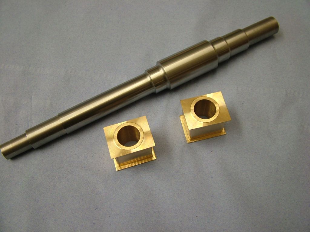

                                Unless it's Precision Ground Mild Steel bar Jason no stock material would really be suitable due to the reason you state – likely to be undersize. I don't know what Stuart supply but didn't Doc say he only bought castings?
                                Short of using PGMS two thou down is not an ideal starting place unless as you say the bearing is turned to suit and not reamed to stock size – that would be a rattle fit as far as a main bearing tolerance is concerned let alone the fact that basic stock material is not truly round either – even silver steel
                                It's 'horses for courses' of course but I would have assumed anyone making an engine of this nature would make the bearings and shaft a very good running fit to each other.
                                If I were to make another of this design I would certainly make the shaft with stepped diameters for ease of assembly. ie no spoiling of the running surfaces as the fly wheel and eccentrics are positioned. Once the cranks go on of course, that's it.
                                One thing I learnt early on was it makes life much easier if, for most part, you put the horse in front of the cart wink
                                PS PGMS incidentally is a lovely material to turn further if required – probably close to EN1a free cutting. It turns and screw cuts extremely well. I think EKP offers it as well as M-Metals
