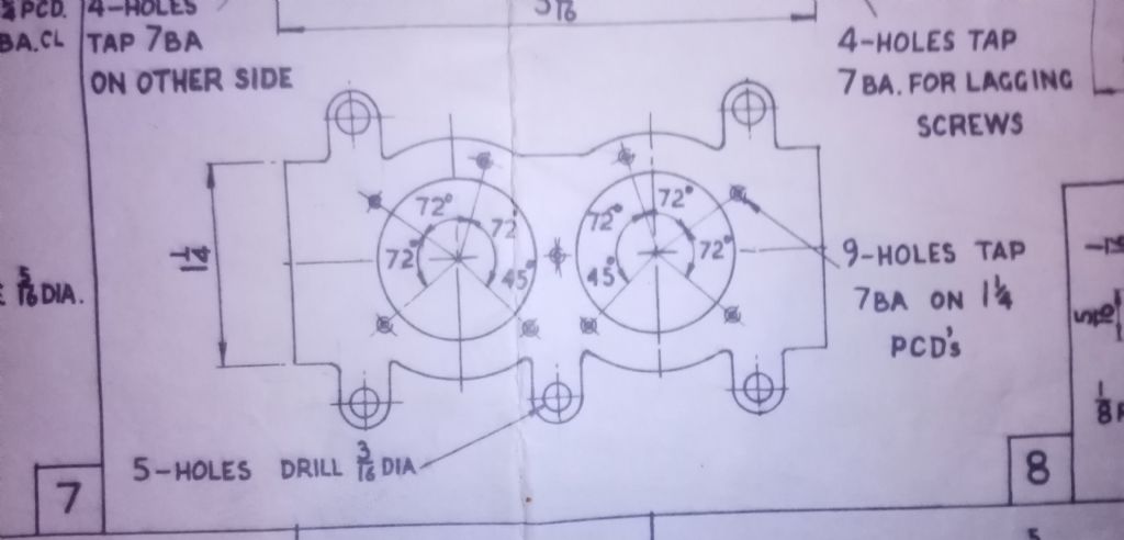

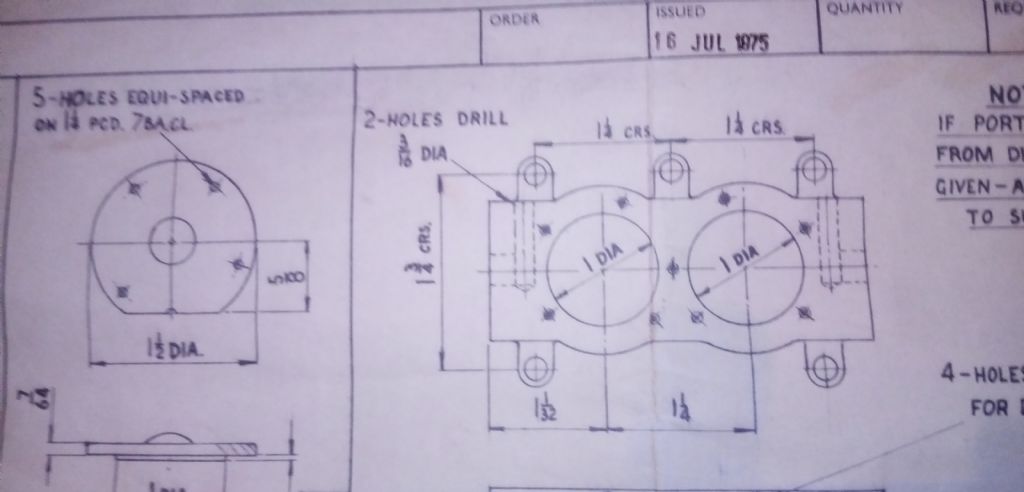

      Just starting my 3rd stuart engine with a big challenge taking on the twin launch.
      I got the kit off market place all intact but very old. The drawings are dated 1975 and are yellow with age.
      Perusing said drawings my attention was drawn to the cylinder block and the pcd for bolting end caps on
      The top cap says 5 holes eqi spaced but for the bottom cap it gives angles of 72 deg and 45 deg.
      Any body know why as its still the same 5 hole config.
      See attached pics

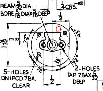

      #11061
      Arthur Goodwin
        @arthurgoodwin45738
        Pcd
        #576188
        Arthur Goodwin
          @arthurgoodwin45738
          #576189
            If it's anything ;like the compound the 45deg position is due to the fact if you used the equal 72deg pattern the hole would place the nut in the way of the cross head guide. The compound shows the 45deg on both the underside of the cylinder casting and also on the cover so the two match

              Hi jason
              Yes I see that now. It was the drawing for the top cover that puzzled me saying "5 equi spaced holes" when they obviously arn, t
              Thank you
              #576206
                I'm not sure why your drawing also shows the covers on the top of the cylinder having the uneven spacing as it is only needed on the underside for the reason stated. I only have drawings for the compound and that shows the equi-spaced back (top) covers which would look a lot nicer and should not give a problem with proximity to the drain cock holes
                First image here has them equi-spaced which looks better than the video image lower down, plenty of clearance to the drain cocks and also a couple of threaded holes added to aid removal of the covers

                #576207
                  There is a good build thread on John Bentley's site. He has top equi-spaced and the bottom with the 45deg and you can easily see why it needs to be that way from his photos.
