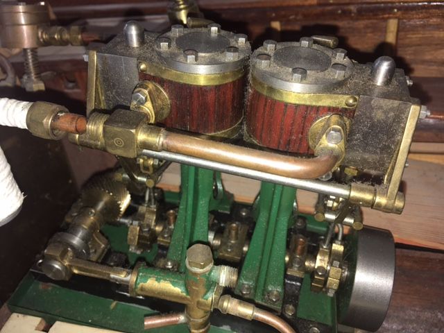

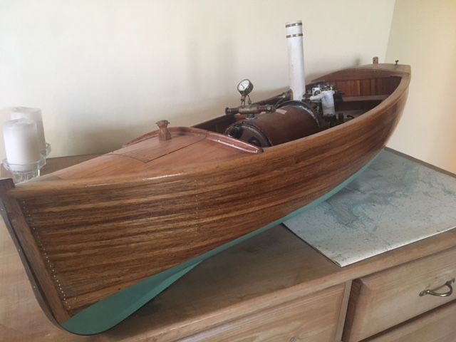

                          img_0512.jpgThanks for all the ideas, seems split eccentrics may be the best way to go – will report back when I have tried a few ideas out.
                          Here is a couple of pics of my steam boat (still unfinished) with the Double Ten – rather dusty ! Still thinking of a vertical boiler ?
                          Not sure why the pics are above and below text – sorry.
