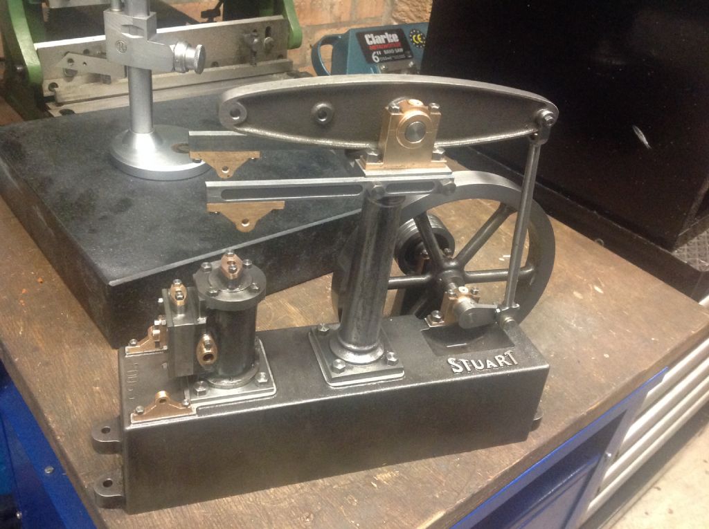

      Had promised myself for a long time to make a beam engine.
      I managed earlier this year to get my hands on an unstarted complete castings/raw materials/fasteners kit for the Stuart Beam Engine. One or two extras such as extra valves and lubricators were also included. Luckily at a decent price away from the Bay.
      The negative being that this package had been originally purchased in 1975 and consequently stored since. With this was the original drawing package. I then bought a new copy of Andrew Smith's Stuart build guide.
      As his build is lathe based for both turning and milling. My methodology adopted, has differed slightly being able to carry out milling on my 626 with 3 axis readout. I started in October on an " on and off basis " twixt doing other things. I think I am about half way through at a guess.
      Having done a search I found 4 posts only on the Beam, one of which being on the eccentric raised an important issue.
      Distance on my drawing for the eccentric centres is 11/64".
      Andrew Smiths description shows 11/64".
      The drawing in Andrew Smiths book shows 9/64".
      One of the posts makes reference to a later ( 1993 ) Stuart drawing showing it to be 9/64".
      I know it's a bit late in the day but I have been following the dimensions in his book rather than my drawing and now having 2nd thoughts about this, so a couple of questions please if anybody is able to answer:

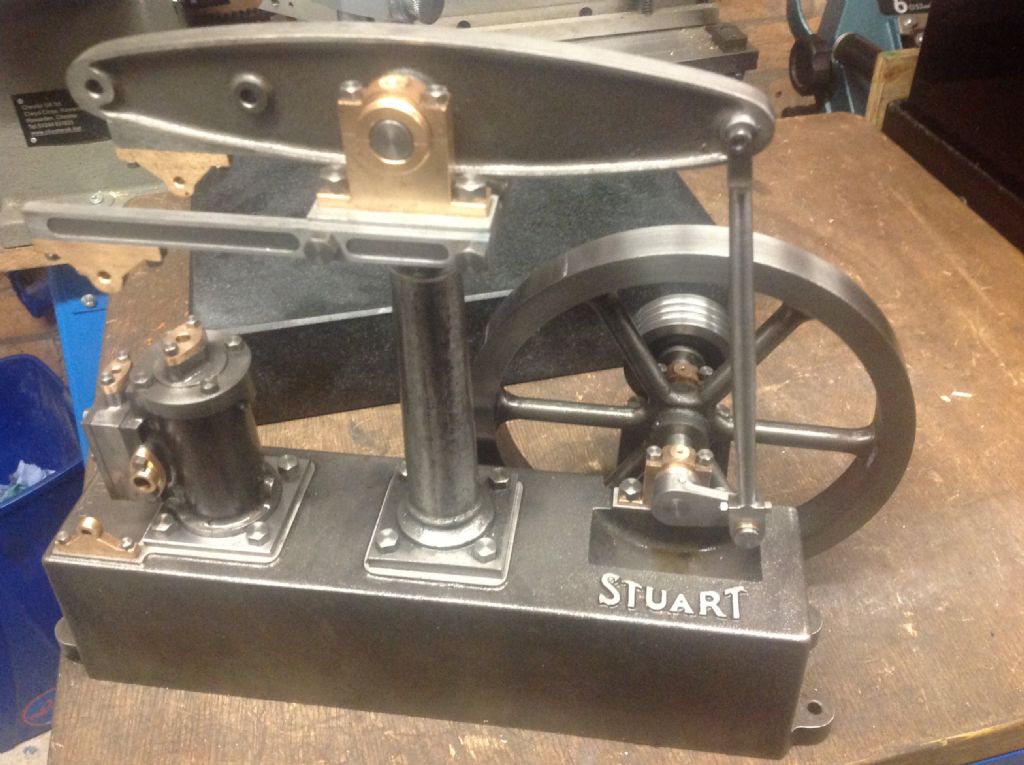

              Just put a DTI onto my eccentric and get 0.284" movement which is not bad considering at the time I would have marked oyt with a ruler.
              So looks like 9/64th (0.141" ) is the right dimention.
              J
              PS now need to work out why the piston is siezed solidsad

                    Don't like putting WD40 in as it tends to dry out and make things stick.
                    Think it was just dried up oil (not steam oil) as I was last run on air and maybe a bit of rust from moisture in the airline. Luckily it had stuck at BDC so a good shove downwards on the other end of the beam has it moving again, will hopefully have the compressor out later to run up another engine so may give the beam a go as well to loosen it back up.

                          I'm in the process of trying to complete a Stuart beam that I bought as a part complete unit in 1996. All the parts, plans and materials were there but no fasteners. I bought Andrew Smiths book and started on it about 2-3 years ago. My plans are dated 1972 and show the eccentric offset as 11/64. The book (1987 printing) is as you say 11/64 in the text and 9/64 on the drawing. After doing a little math to see what was the appropriate dimension to give the correct valve movement I decided that 9/64 was correct and that is what I made mine. Total valve movement required is .21825 to fully open the ports at each end, thus an eccentric offset of 9/64 will give this movement to the end of the eccentric rod and hence to the valve rods (#32 on the drawing).

                                        Just to confirm kind response from Stuart Models in that on the eccentric should actually show 9/64" not the 11/64" shown on my older drawing.
                                        They confirmed latest drawing set as being 1993, offering to sell me a set, if I have any further doubts.
                                        Think I will carry on using book and drawings as book seemed fine as the drawings in there were from a later date than mine.
