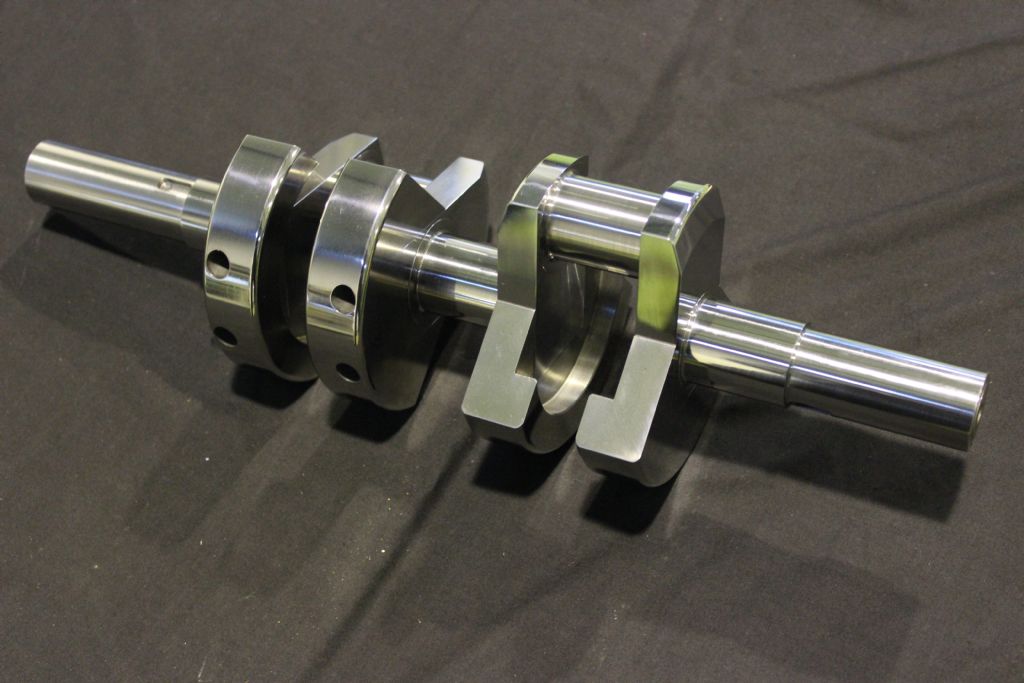

                        Lionel Connell
                          @lionelconnell35623
                          6A Crankshaft machined from solid P20 Tool steel with bolt on CI counter weights
                          Here is my 6A crankshaft turned from solid

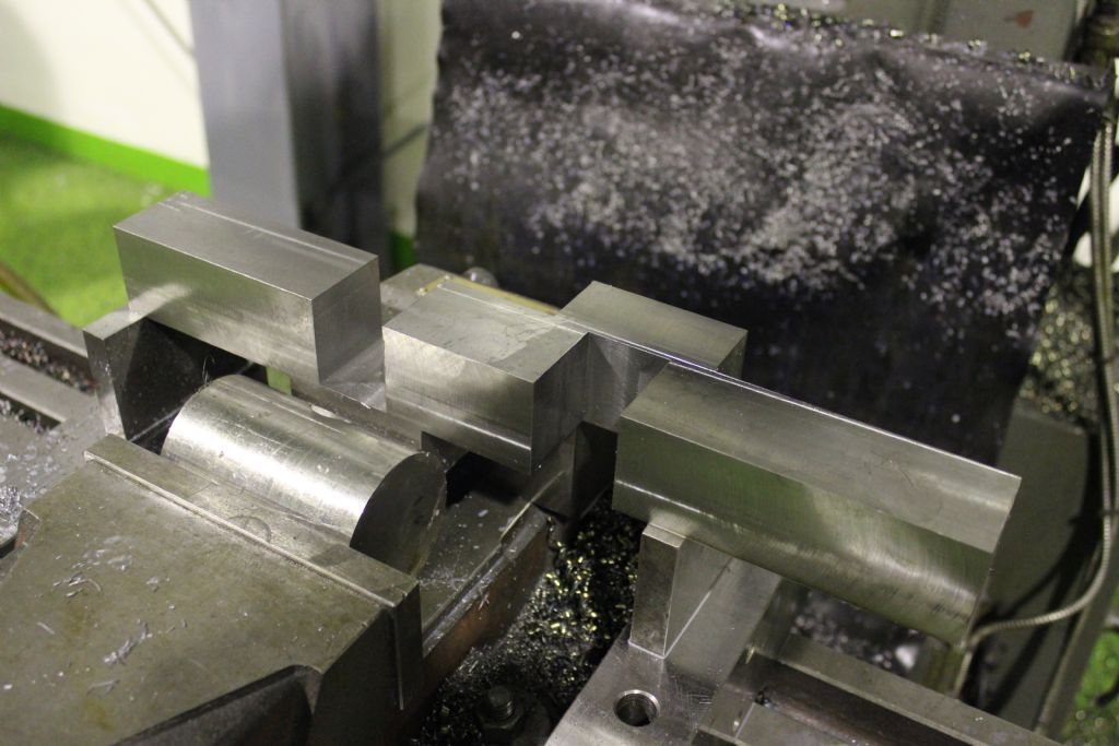

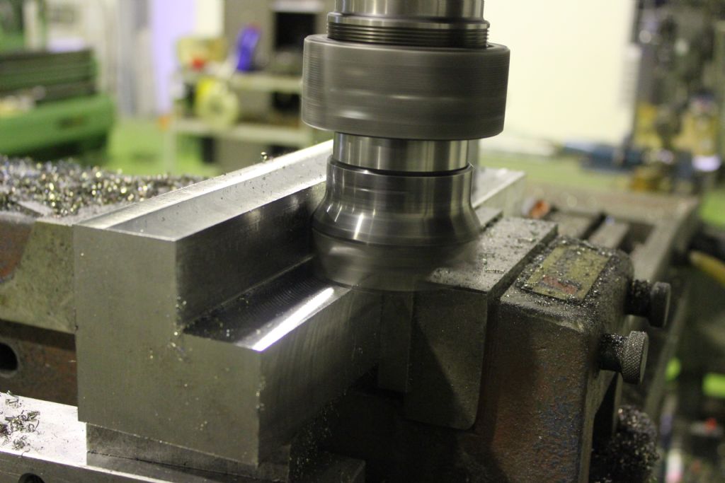

                              Lionel Connell
                                @lionelconnell35623
                                Crankshaft roughing out
                                Roughing out 6A crankshaft

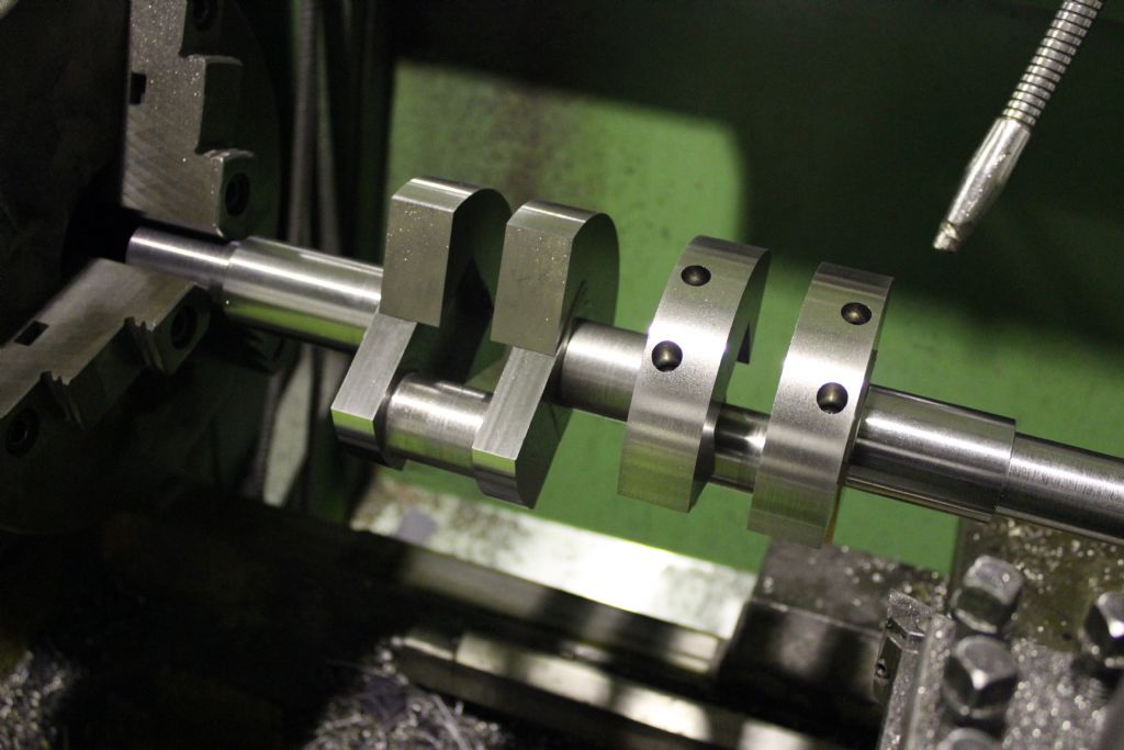

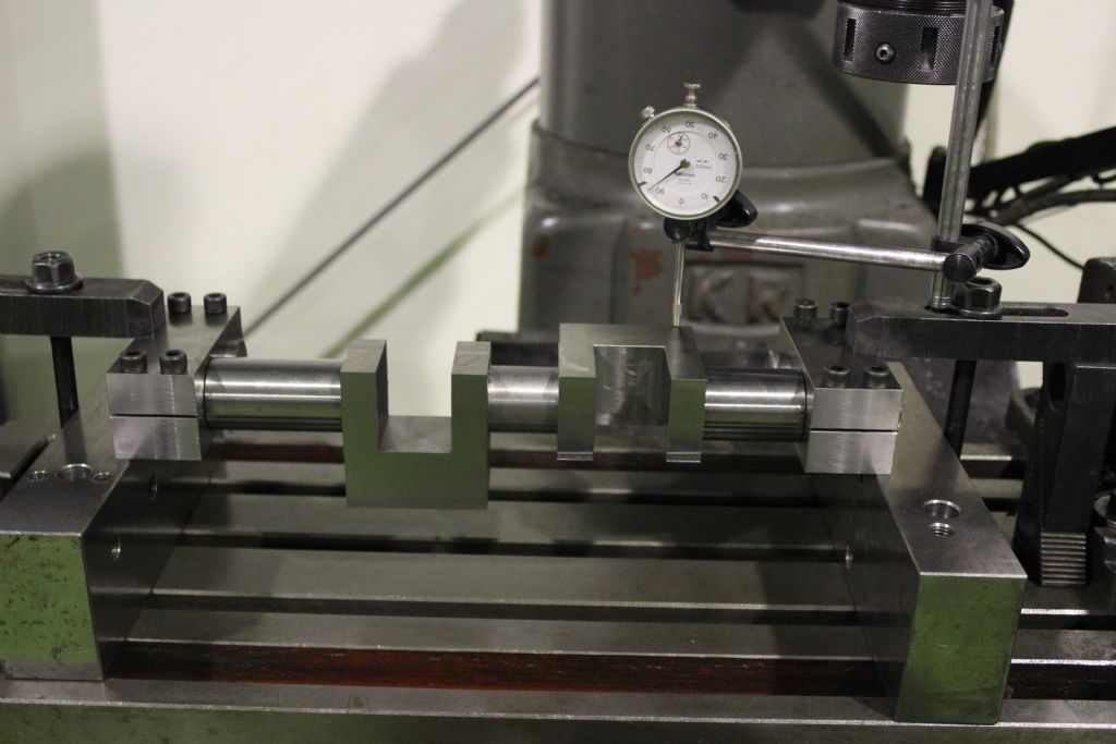

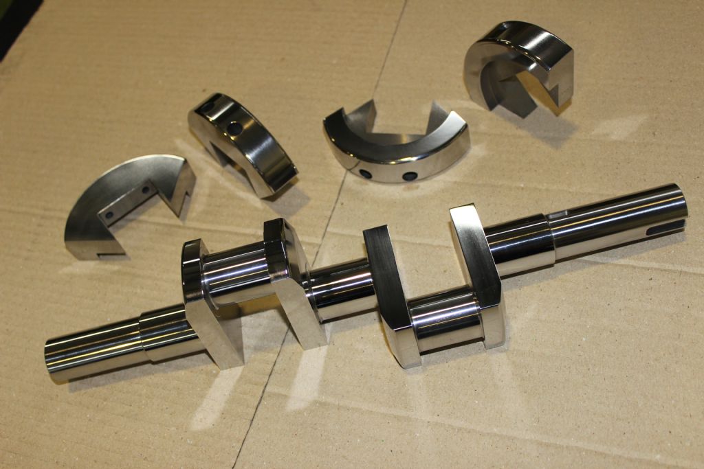

                                              Thanks guys I will have another go at it here. I am building a 6A for use in a Launch. I am a toolmaker and just like many other builders of steam models I spent much time pondering over many ways of making a crankshaft. My engine will work for a living and I was not prepared to compromise on strength or longevity. Fortunately I have some larger equipment and so I opted for starting with a big block steel. I chose P20 tool steel because it is pre-hardened to 40HRC, it is fully stress relieved so it doesn't change shape as you cut big pieces out of it, and P20M version that I used has added sulfur to improve cutting. I milled 16Kg off the square blank with an 80mm x 4 insert tip cutter, it took 8 hours and I didn't need to change or rotate the tips. The counter weights are the Standard Stuart Castings. crank shaft rough milling blank 1.jpgcrank shaft rough milling blank 5.jpgcrank shaft turning 2.jpgcrank shaft turning 3, squaring web sets  to each other.jpgcrank shaft turning 4 seting the turning jigs in milling machine.jpgimg_6906.jpgimg_6953.jpgimg_7291.jpgimg_7321.jpgimg_7348.jpg
                                              #210858

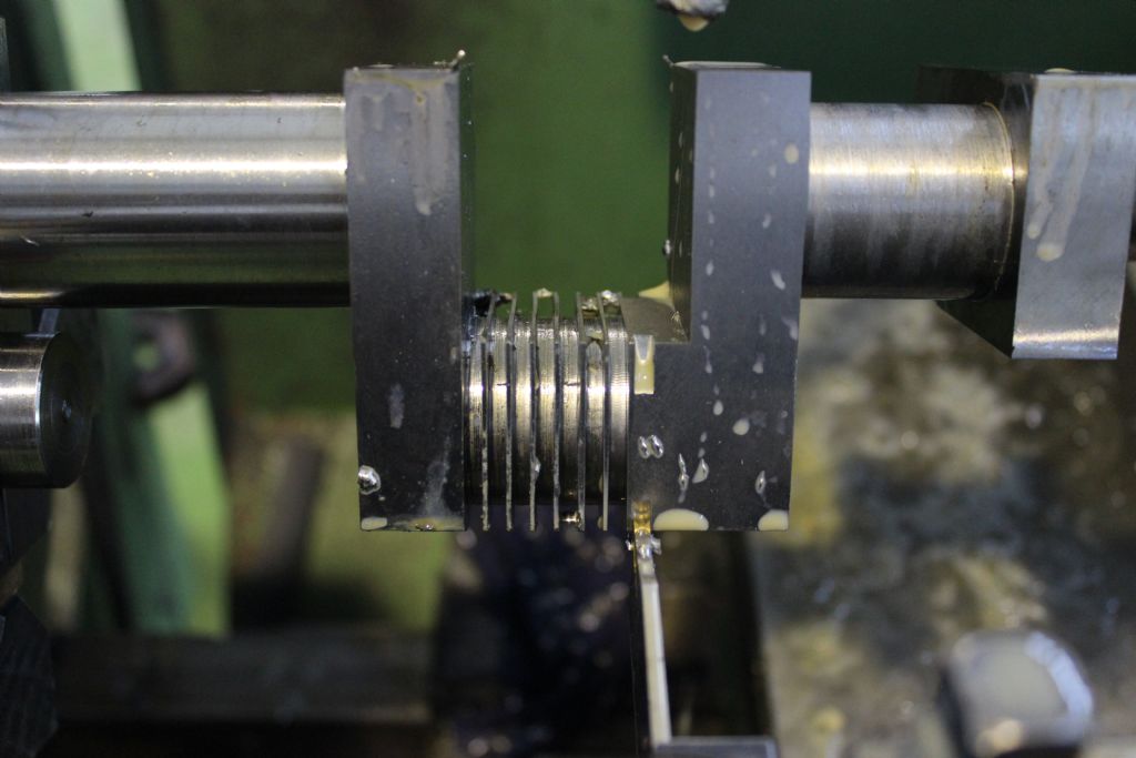

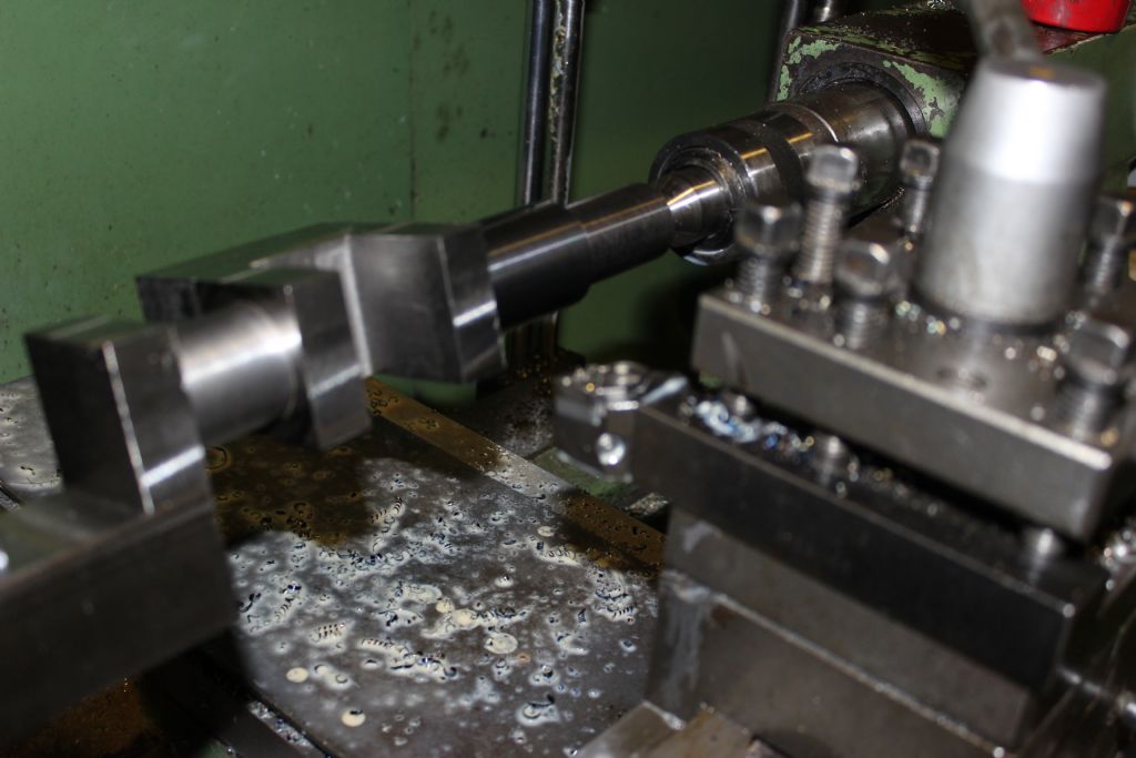

                                              Lionel Connell
                                                @lionelconnell35623
                                                Sorry I missed this one, the big end pins were roughed out like this.

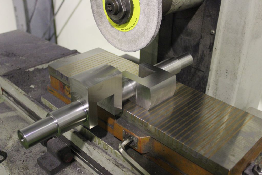

                                                Total machining time for the crank including grinding 48 hours. I am sure that I could not have made the crank any quicker by fabricating it, and I am not left wondering about the quality of any brazed joints or voids in castings. The three main journals were machined between centers first, after machining the big ends and facing the webs the crank was put back between centers for grinding, I clocked the main journals before grinding and the run out on the middle main journal was less than one thou . Here is where the pre-hardened and fully stress relieved material is worth it's weight in gold, it stays put.
                                                Cheers
                                                Lionel
