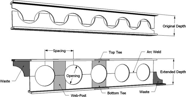

        @samlongley1
        Posted by Martin Kyte on 10/09/2020 11:39:03:
        Re castellated beam
        Interesting way they make those. The webs are cnc cut (Water jet or Plasma) so that the two half profiles stack inside each other to fit onto a blank less than the final width of the finished web. The 'points are then butt welded to form a web with a series of circular hole down the middle. Add top and Bottom and you have your castellated beam.
        regards Martin
        Just one point– They are not normally circular holes but hexagonal. That gives flat surfaces for the weld at the new meeting point.
        Going back to the OP's post & comment about the ruler. It is certainly stronger on edge.
        Just an itemt that may solve a problem for someone. If they want a beam for a construction in a house etc, then a piece of flat plate the depth of the joists (or slightly less), bolted betweem 2 timber joists makes an excellent beam. It is cheap, & can be inserted into construction easily. Plasterboard etc can be easily nailed to it without awkward noggins etc. Herringbone noggins can be added in the space as normal if required to avoid rotation
        Edited By Sam Longley 1 on 11/09/2020 08:06:32

              Posted by Sam Longley 1 on 11/09/2020 07:54:51:
              It is horses for courses.
              The traditional ones give long spans for efficient material use, good for single-storey warehouses and industrial buildings.
              However, when it comes to multi-floor construction (office space), the circular ones are much more popular. They allow the myriad of building services to pass through the holes in the web rather than under the bottom flange. This means the overall structural depth can be reduced, allowing more than one extra floor (with its per square foot rent).
              Where rectangular holes are needed, they can be incorporated, usually with stiffener ribs above and below the opening.
              The march of technology has also had an influence. Traditional castellated beams were cut out of pre-existing rolled sections. Most modern cellular beams are cut from three plates and welded together. This gives you a lot more choice on both flange thicknesses and widths and also web height. CNC profiling and automatic welders facilitate this.
                I suppose that would depend upon one’s definitions of ‘they’ and ‘normally’
                As I mentioned yesterday:
                _____
                Here’s an interesting page:
                **LINK**
                Edited By Michael Gilligan on 10/09/2020 21:34:21

                      Hi Sam, well not always hexagon, in fact most lorry trailers that I've seen with castellated beams had what you might call a clipped diamond shape. But whatever shape they are, it's the term that is used for this type of beam.
                      Of course back before water jet, plasma cutting and CNC were around, they were flame cut and in many cases by skilled people.

                            The example you refer to with circular holes is not what I was referring to. If one wants to put a cut along the web of a beam then separate the 2 halves & offset & then re weld to form a deeper castellated beam one needs an edge to weld to. If the line was a wavey one the meeting points would not meet in a way which could be suitably welded & the holes would NOT be circular. Standard castellated beams cut from a simple I beam would be cut such that the line has flat edges for the weld. The hexagonal hole thus remaining would still leave room for services & I do not recall having difficulty installing them. I did fit quite a few tonnes of the stuff in a number of new schools halls etc But I do confess, that was 40 years ago & things move on, so If I am wrong then I stand corrected
                            The example in the one in the link would , presumably, be cut from an I beam with considerable waste.

                                  Posted by Sam Longley 1 on 11/09/2020 13:00:24:
                                  Here’s a direct quote from the linked page:
                                  The top and bottom tees are frequently cut from different rolled sections, with the resulting asymmetric Westok beam formed with each tee/flange designed to suit the load it resists and the restraint conditions which apply locally.
                                  From which it seems clear that there are many ways to skin these cats

                                      Less waste than you might think when you look at the cunning way they are made with modern CNC cutting gear.
                                      #495407
                                      Martin Kyte
                                        @martinkyte99762
                                        . . . and as I said less weld too.

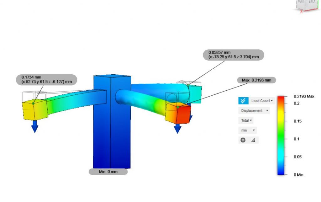

                                          Here's how Fusion 360 predicted three 60mm long Aluminium beams of equal cross-sectional area and length would deflect with a 250N load on the end.
                                          Winner is tube, 13mm od, 11.34mm id, deflects 0.06mm
                                          2nd square section 10x10mm, deflects 0.17mm
                                          3rd round bar, 11.28mm diameter, deflects 0.22mm
                                          Deflection is magnified above reality in the image to emphasie it. The colours indicate degree of deflection, not safety. Red highlights points of maximum deflection, not that the structure is going to break. Another FEM reports shows the structure has a 7x safety factor.
                                          Although tube is stronger weight for weight than box or rod, the fact doesn't help us design a better boring bar because the diameter of the tube is bigger, and boring bars have to fit into small holes! Other structures make good use of tubes.

                                            I think castellated beams traditionally had hexagonal holes, because they were hand burned using an oxy acetylene torch. Straight lines are easier to burn by hand than circles. They bend like bananas when cut, we used to tack them together in a jig using metal wedges to straighten the halves back up.
