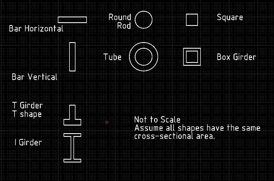

      Can the team provide a simple answer to the following. Assuming the same weight of metal is used to make a beam of the same length, which shape bends least under load? ( Assume the beam is rigidly fixed to a wall at one end, and weights are added at the other.) Some examples:
      Just for starters, the first two rectangles are identical except one bar is mounted horizontally, while the other is vertical. Experimentally bending a steel-rule shows immediately that the same lump of metal behaves very differently. Held horizontally, the rule bends easily – a child can do it. Held vertically, it's a job for superman. As the same shape is both strong and weak depending on load direction, the engineer has to understand and choose cross-sections appropriately.
      Michael mentioned resistance to torque (twisting force) in the Boring Bar thread as being something a round section would resist better than square. I don't know, but suspect an ⌶ girder is stronger right/left and up/down than a tube, but the tube wins if the beam is twisted. Several other shapes might be useful depending on which forces a beam has to resist. How about ⌴, ⎔, △, and ☆?

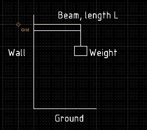

                                I meant a beam sticking out from a wall with a weight on the end like so:
                                I didn't think the actual length matters, because all the beams are the same weight. Now Speedy points it out, could be I've over-simplified. For example, metal cut out of an I girder to castellate it could be reused to make the beam longer…
                                Why is nothing ever easy?

                                  Despite calling it strength I think SoD means stiffness. If all beams are the same length and weigh the same then they must have the same cross sectional area. The deflection of the beam shown by SoD is inversely proportional to the moment of inertia. So it's simply a case of comparing moments of inertia for constant area to find the stiffest shape. All the information needed is in Machinery's Handbook.

                                      This leads to the first food-for-thought item – cantilevered beams have to be strongest at their attachment point. This is where the bending moment and shear stress are greatest, and hence cantilevers are generally designed with decreasing mass-per-unit-length as you move away from that attachment point. Hence this is why cantilevered beams often taper (or otherwise decrease in area) from their fixed ends towards their unsupported end – they need to be less strong as you move away from the fixed point and you want to have less mass as you move away from the fixed point.
                                      The second item is more complex, and I won't go into the detail, but suffice to say that an I beam is essentially the optimum strength-versus-weight compromise (and hence strength-versus cost compromise). A plain rectangle (with the long length vertical) is generally strongest of all, but contains a lot of heavy material which is doing very little for the beam's bending strength. With that insight, If you look at an I beam end-on you can see it's really just a rectangle with the least-beneficial bits removed. This is why I beams are so ubiquitous in the world – they're cheapest for the strength they provide.

                                              It gets worse, because for the same weight of material, by making the webs or the wall thickness thinner, you can make the section larger, eg a larger diameter tube with a thinner wall, or an I beam that is taller, like the castellated beam achieves. But if you go too far with this process, the compression side will become very prone to buckling. It is quite hard to predict at what load buckling will occur, since it depends on initial straightness and whether the load is applied truly along the axis.There are ways to reduce the chance of that, for instance by corrugating the walls of the tube along the length. Of course none of this is very applicable to a boring bar, which has to fit inside a given starting hole.

                                                As others have said this gets fairly complicated fairly quickly. Basically you want to get the section as tall and thin as possible but if you overdo it you get buckling. A very good book for starters is Structures or Why Things Don't Fall Down by a chap called Gordon. He has a companion volume called The New Science of Strong Materials.
                                                Torsion of non circular sections, especially things that don't resemble bars or tubes gets even more complicated
