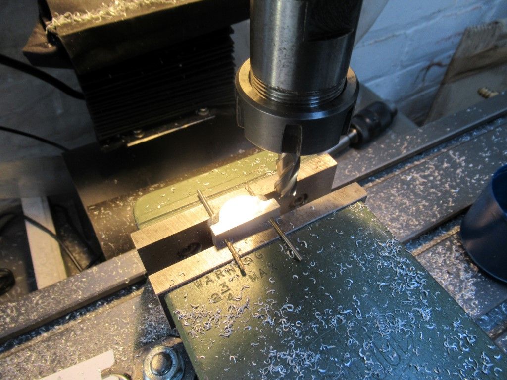

      I have been machining some main bearing caps today from a casting.
      I centre drilled then put a 2mm pilot hole through each cap which will be used to spot through to the crankcase and then opened out to 4mm for the mounting bolts.
      Now I have discovered the holes [ 10 of them ] have all run out of true , I suspect I used a badly ground drill bit.
      I need to straighten these hole as I open them out to 4mm and was thinking of using a BS1 Centre drill as this is quite stiff and only 1/8 diameter.
      What do you think

                          #398181
                          David K
                            @davidk77137
                            Yes it is the Gypsy , the drill bit was from Screwfix [ Erbauer ] and was new.
                            I am using my Chester Champion mill to do the drilling , I centre drilled first then followed
                            with the 2mm drill bit.
                            I have been getting aluminium sticking to the drill so withdrawing it to clean regularly.
                            You can not see it on the picture but this is how I discovered the holes tapered inwards.

                                    Thanks everyone, put an End mill through each casting this morning and it actually
                                    cut through really easy . All holes are running parallel now.
                                    I think I will be investing in some quality drill bits now.
